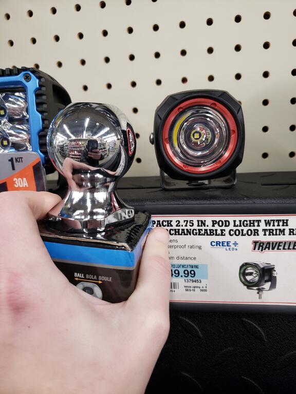

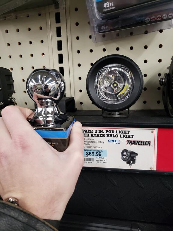

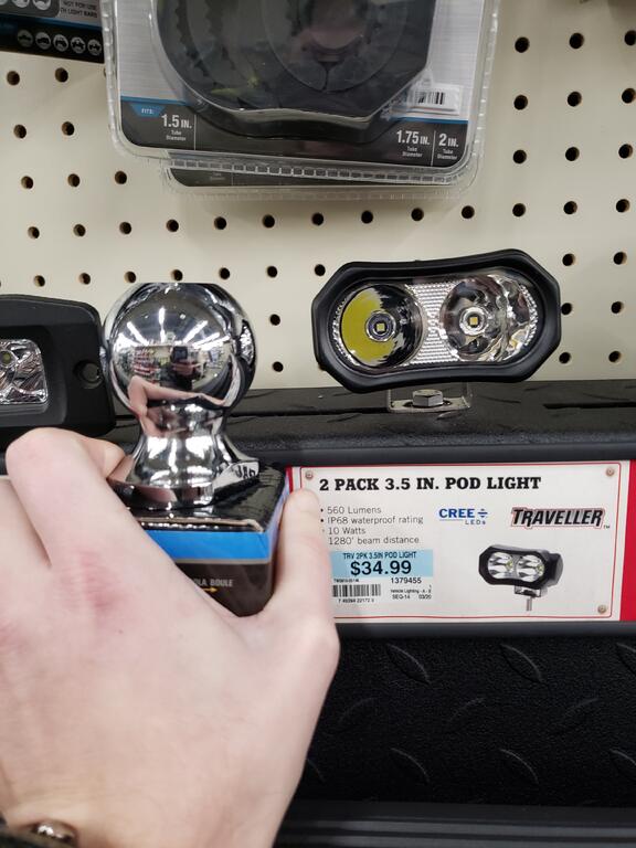

71_Bronco 1,073 #20 Posted January 5, 2021 (edited) Stopped in at the local store to really look at the lights. The 2 cheaper ones posted about seem small once I was inspecting them. I took a pic with a standard 2" hitch ball for size reference. The 3" ones look like a good size and I may go with them, especially since they are brighter and come with a harness. Edited January 5, 2021 by 71_Bronco 2 Share this post Link to post Share on other sites
Handy Don 17,634 #21 Posted January 5, 2021 (edited) 2 hours ago, 71_Bronco said: Stopped in at the local store to really look at the lights. The 2 cheaper ones posted about seem small once I was inspecting them. I took a pic with a standard 2" hitch ball for size reference. The 3" ones look like a good size and I may go with them, especially since they are brighter and come with a harness. Even very small LEDs can be very bright--in fact, the pinpoint intensity makes it hard to judge the lumens being generated. Where size makes a difference is in the reflectors. Larger accommodates (but does not guarantee!) more shaping to focus the beam into the intended light pattern--flood, spot, or a combination. For high output LEDs, a larger case may diffuse the heat better, though at these outputs that isn't much of a concern. The other consideration is the color temperature and spectrum. Cheap LEDs tend to have narrow spectrums that lean toward blue and may affect what you see at night. Edited January 5, 2021 by Handy Don Share this post Link to post Share on other sites

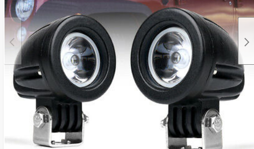

rjg854 13,408 #23 Posted January 6, 2021 2x 10W CREE LED Spot Light Mini Round Work Lamp for Jeep Offroad Trucks ATV UTV got these at the bay, 20 bucks, work great and they're not to big Share this post Link to post Share on other sites
Maxwell-8 4,371 #25 Posted January 6, 2021 (edited) 1 hour ago, rjg854 said: Nice, but we need a night pic!! Are they bright is the question? Edited January 6, 2021 by Maxwell-8 1 Share this post Link to post Share on other sites
