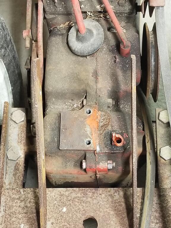

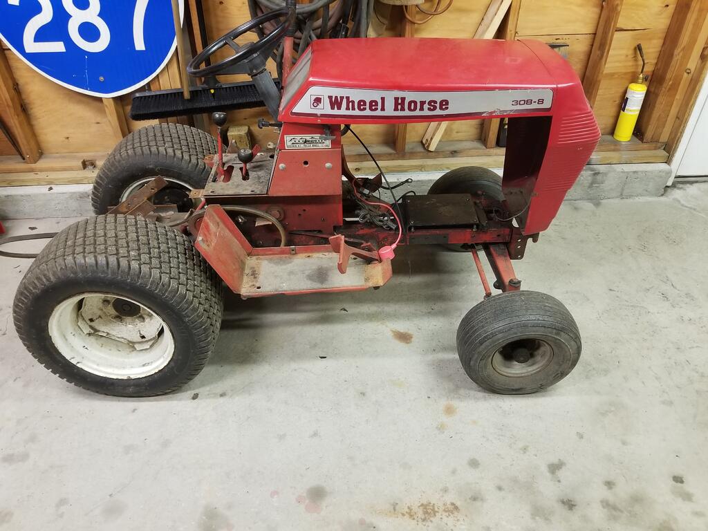

matt monte 232 #1 Posted January 3, 2021 Happy new year to all. let me start off with saying im new to the tractor scene but can fab/weld/paint/etc and look forward to diving into this awesome hobby. I recently got a new home on a bigger parcel requiring a garden tractor to mow, push wouldnt work. Anyway i bought a used 260 series for that. A month ago i picked up a 312-8 with a plow attachment just devoted to clearing driveway in the event of snow. I saw this basket case on marketplace and couldnt resist. plans are for a complete tear down and rebuild. P/O stated he broke dipstick tube accidently when removing rear faring. Said starter fried, and he was removing engine in an effort to clean and repaint tractor. guy lost interest, and sold as a basket case with "most parts" . I know im all over the map here, just trying to give the back story. The trans related questions are : how to remove and replace dipstick and is there a way to make these rims work? Meaning spacers are something so stock fuel tank will work? Kinda liked the look however if they are not practical, or more of a hassle ill search for stock. My plans are to replace any gaskets or seals but would prefer not to have to rebuild eng/trans myself, im more of a assembly guy. Ive done a few 57 chevys, im aware of limitations and when it pays to have the right person handle a certain task. Im not taking anything else apart until i research a few builds done. Havent really found anything yet. Thanks in advance for any advice or answers to my questions 7 Share this post Link to post Share on other sites
wallfish 20,177 #2 Posted January 3, 2021 The plastic trans tube is threaded into the hole in the trans. Unscrew it 5 Share this post Link to post Share on other sites
matt monte 232 #3 Posted January 4, 2021 not sure if u saw pic, i dont have much material to work with,lol Share this post Link to post Share on other sites
ebinmaine 79,568 #4 Posted January 4, 2021 4 minutes ago, wallfish said: The plastic trans tube is threaded into the hole in the trans. Unscrew it I may have broken one of them off thinking it pressed in. Maybe. You've got a good base there. Wheel adapters are available and easy enough to use. They are however a bit tough to choose because there's sooo many available. I can PM you a link for a set on ebay that works well and adds 2" per side. You'll likely need to touch each lug hole with a half inch drill to clean them out. While there it's a GREAT idea to install lug bolts and nuts. Makes installing wheels a new world of easy. 1 Share this post Link to post Share on other sites
ebinmaine 79,568 #5 Posted January 4, 2021 1 minute ago, matt monte said: not sure if u saw pic, i dont have much material to work with,lol Should be just enough to lock a pair of vise grips on there. Share this post Link to post Share on other sites
wallfish 20,177 #6 Posted January 4, 2021 (edited) 13 minutes ago, matt monte said: not sure if u saw pic, i dont have much material to work with,lol I saw the pic. If you can't grab what's there you will need to get creative to remove it. A large easy-out to fit in that hole Hammer and Chisel to split it Cut it - use a vacuum to catch the dust pieces heat it - warm it until it's pliable and pry it out Edited January 4, 2021 by wallfish 6 1 1 Share this post Link to post Share on other sites
Pullstart 70,524 #7 Posted January 4, 2021 That plastic should be fairly malleable when treated like @wallfish suggested. if I haven’t already, good luck with your new project! 1 Share this post Link to post Share on other sites
953 nut 67,304 #8 Posted January 4, 2021 1 hour ago, matt monte said: guy lost interest, and sold as a basket case with "most parts" Looks like a good project. You will find lots of information and help with any questions you may have, please ask if in doubt. Share this post Link to post Share on other sites
JCM 11,253 #9 Posted January 4, 2021 Almost looks as though the tranny may have been split before, is that orange permatex on the case halves, usually just a gasket there. Also the nuts & bolts are usually painted red when the trans get's painted at time of build. Good luck on your resto. Share this post Link to post Share on other sites
Ed Kennell 46,507 #10 Posted January 4, 2021 3 hours ago, wallfish said: I saw the pic. If you can't grab what's there you will need to get creative to remove it. A large easy-out to fit in that hole Hammer and Chisel to split it Cut it - use a vacuum to catch the dust pieces heat it - warm it until it's pliable and pry it out I would try the easy out first. If you don't have one large enough, you may be able to rent one from any auto repair shop or auto parts shop. Lincoln at A-Z Tractor should be able to supply you with the new parts. Lincoln is a vendor listed in our classified section at the bottom of the home page. to the Share this post Link to post Share on other sites
matt monte 232 #11 Posted January 4, 2021 thanks guys for all the great responses. now that i know its threaded and not pressed, i have a better idea how to proceed. Good eye on permatex. i noticed that was well and wondered what happened there. Share this post Link to post Share on other sites
R. L. Addison 300 #12 Posted January 4, 2021 Drive a piece of square keystock in it. should back right out. 3 Share this post Link to post Share on other sites
peter lena 9,938 #13 Posted January 4, 2021 MATT, good choices on that removal, take advantage of the total access to the area , and detail and lubricate linkage areas, also noticed the home made rear hitch mount on that angle steel to top of rear end plow hitch , making up a similar set up to be a weight mount base, bolt on . just a good opportunity to improve and correct while you are there , pete 1 Share this post Link to post Share on other sites
pacer 3,180 #14 Posted January 4, 2021 While we're in tranny talk mode, while youre messin with it go ahead and drain/flush the tranny. While the shifter boot looks really good, the PO just may have replaced it and never drained/flushed the cavity - the case is very prone to collect moisture. 2 Share this post Link to post Share on other sites
peter lena 9,938 #15 Posted January 4, 2021 pacer, that's what I am talking about ! regularly go over areas and look to see if I can improve or change out a problem. pete 1 Share this post Link to post Share on other sites
rmaynard 17,416 #16 Posted January 4, 2021 (edited) If it won't turn out, I would take a hacksaw blade or saber saw, run it up and down until it cuts through, making a relief cut, then pry it out with a flat screwdriver. Similar to the procedure used to remove a rusted exhaust nipple. Edited January 4, 2021 by rmaynard 3 Share this post Link to post Share on other sites

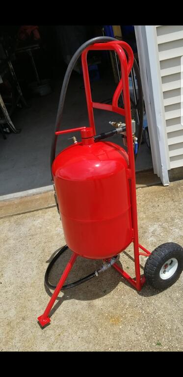

matt monte 232 #17 Posted January 4, 2021 ugh, wanna get out to garage and tackle this dipstick now that i have a game plan but i have week off to paint a few rooms that i promised old lady before christmas, dont you just hate when life gets in the way of tinkering!!! Friday i should have free time, ill report back then. P/O said trans worked shifted without issues. ( yeah i know to take with grain of salt) Any decent videos out there on replacing all seals without taking all the gears apart? Like was mentioned earlier, definitely appears trans has been apart for reasons unknown and a permatex was used in place of gasket. Also i zoomed in on what looks like a leak at axle, wanna fix that as well. Last year i bought a HF media blaster and a hand truck as well as fittings from box store to make a killer blaster that works well,all things considered. Ive had great results with their black oxide media, although pricey. Ugh, im drifting again,lol So to recap, im not gonna remove, clean, blast and paint only to have these possible leaks reappearing. Briefly searched YT didnt exactly see what i was looking for. Not sure what that homemade hitch thing is but it impedes the brackets for stock fuel tank so its gonna go 1 Share this post Link to post Share on other sites
stevasaurus 23,739 #18 Posted January 4, 2021 Matt, should you decide to open that transmission, and I would because of how it is sealed. I'm thinking it does not have a gasket. You may have as much of that sealant inside the transmission as outside, and if you do, you could flush that transmission everyday for a year and you will not get any of it out of there. Anyway, check out this thread on opening and closing your transmission. 3 Share this post Link to post Share on other sites
pacer 3,180 #19 Posted January 4, 2021 1 hour ago, matt monte said: their black oxide media On the blast media --- TSC carries 'Black Diamond" media at $7.99/50lbs(last I bought which was a couple yrs ago) I run their fine grade in my cabinet, you might get by with the medium grade with your pot set-up........ 1 Share this post Link to post Share on other sites
rmaynard 17,416 #20 Posted January 4, 2021 Make sure you get one of these, a pair of overalls, and heavy gloves. That media will come flying right back at you. I know that from experience. Also set up a good painters tarp behind, under, and on the side to catch overspray. 1 Share this post Link to post Share on other sites
matt monte 232 #21 Posted January 5, 2021 safety is paramount, i would go as far to the mask pictured is really only good enough for small pieces. When im blasting im thankful enough to have access to self contained breathing apparatus. I try only to blast in fall/winter. during warm weather u can go thru a "45 min" tank in like 15-20. Share this post Link to post Share on other sites

Skipper 1,792 #25 Posted January 6, 2021 Last time I had a broken off dip stick, I took a small piece of flat bar, cut it to width a bit wider than tube ID. About 1/8" wider. Rounded one end, and sharpened sides and round tip. Nudged it in with a hammer, and turned it right back out with the broken off stump attached. Easy as 1-2-3, and it is now a part of the "special tools" box. 2 Share this post Link to post Share on other sites
