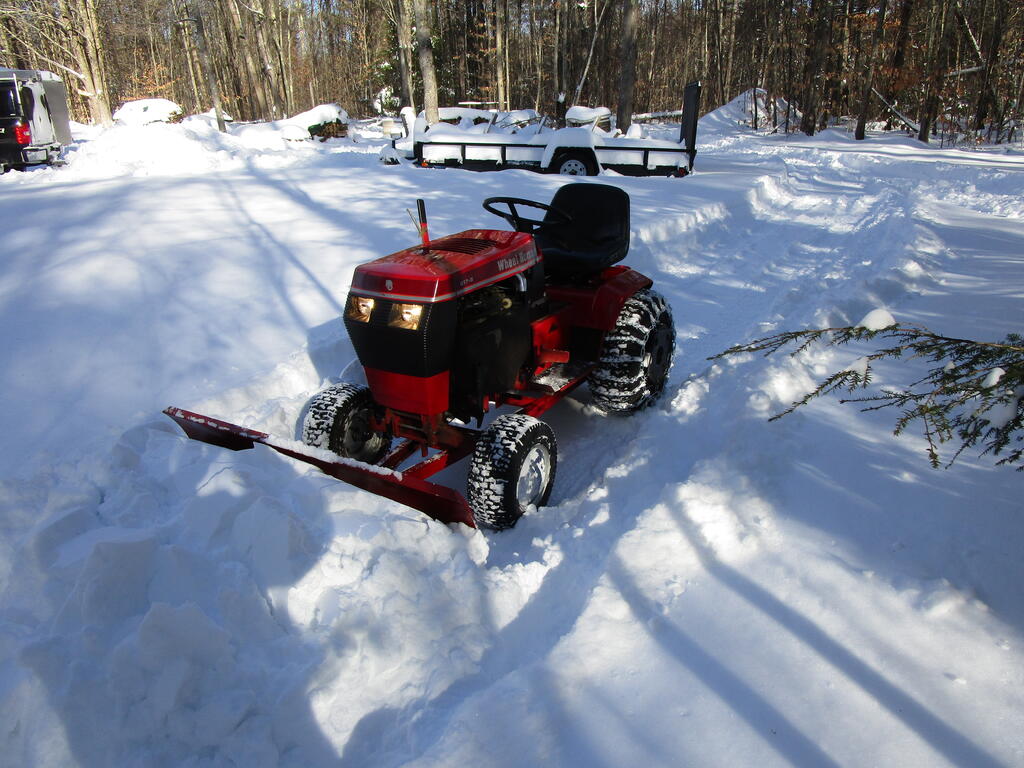

JCM 10,780 #11 Posted January 4, 2021 This blade pictured is a 1991 48'' with the 5 position angle mounted on a 1986 tractor. Works great. Blower is a 1997 44'' 2 stage mounted on a 1991 tractor, great for the deep snow, will throw it into your neighbors yard , if you have any. Good luck in your search. 2 Share this post Link to post Share on other sites
