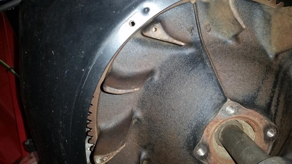

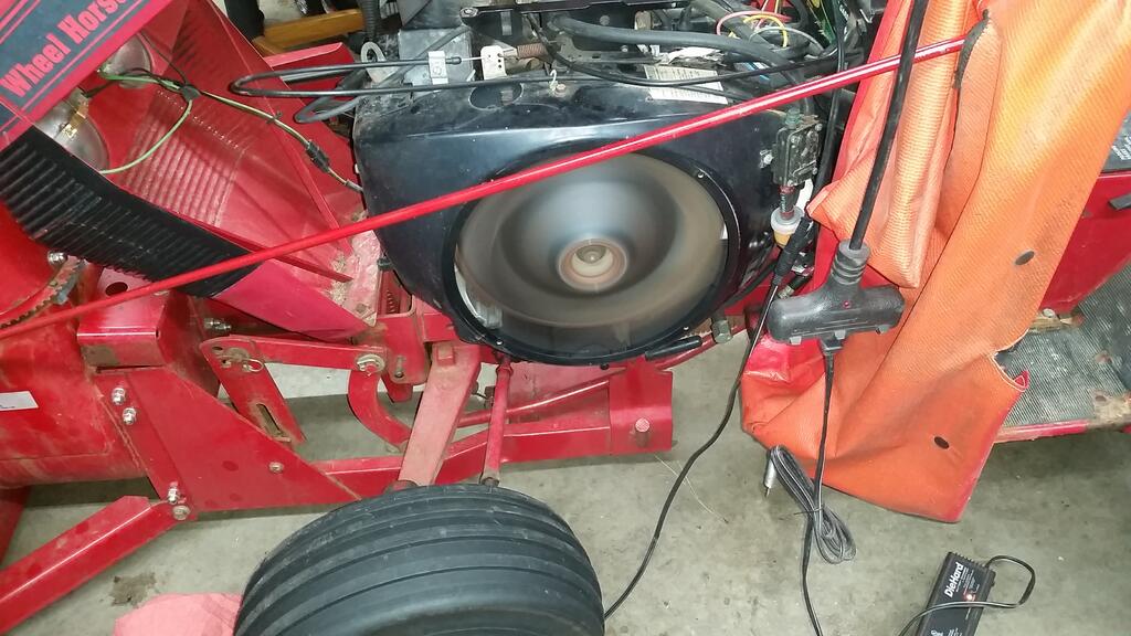

WHX?? 55,033 #1 Posted December 29, 2020 As mentioned in the snow movers thread shut her down to switch tractors and now won't start. Guess she didn't like my two timing! Initially thought no spark but there is. Two new plugs, NGK TR5, and new plug wires. Getting fuel (wet plugs) & 125 psi both jugs. She does pop once in awhile, backfire mostly. Ignition timing seems to be off ?? but checks ok per the manual. 12 volts to the negative on the coil right when there should be ....see pic. Coil reads 3 ohms primary 17K secondary. Ther is a condenser on the positive side of the coil which sees 13 volts when key on but drops to 10.5 cranking. should I try disconnecting the condenser? Not quite sure what it's purpose is. Beginning to suspect to the trigger module but need some advice before I dig into it. and chance the timing gears jumped off? 1 Share this post Link to post Share on other sites

lynnmor 8,629 #6 Posted December 30, 2020 Review the information that you probably read in this thread. Pay attention to how the trigger module is tested. Share this post Link to post Share on other sites

WHX?? 55,033 #8 Posted December 30, 2020 I did Lynn and ther was also some tests that involved simple light tester. Trouble is my tester light grew legs and walked .... suspicion my boy abscombed it. Off tomorrow to buy another! Did that too Mike ...fresh hi test but maybe should have purged the lines. 1 Share this post Link to post Share on other sites
