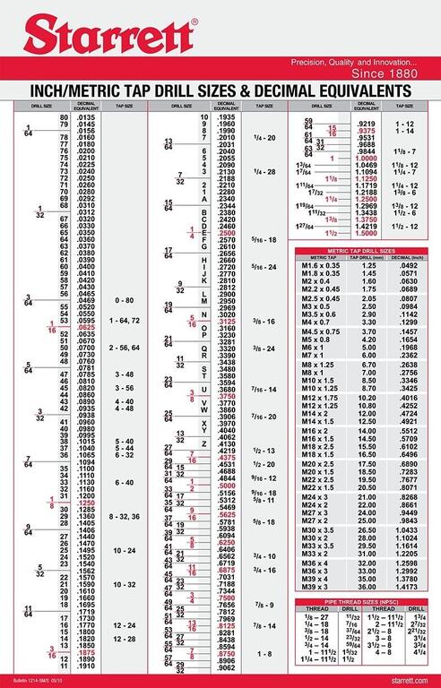

wallfish 20,724 #2 Posted December 27, 2020 Those thread holes are deep. If they aren't ruined all the way through you could run a 3/8 - 16 tap through the threads and use a longer bolt with more threads on it. If they are, then drill the holes bigger and go with a 7/16 - 14 tap for new threads and new bigger bolts. Lots of info online for the drill bit size and where to buy the tap 2 Share this post Link to post Share on other sites
