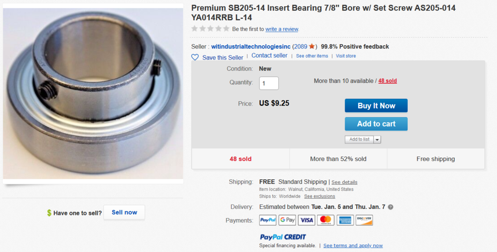

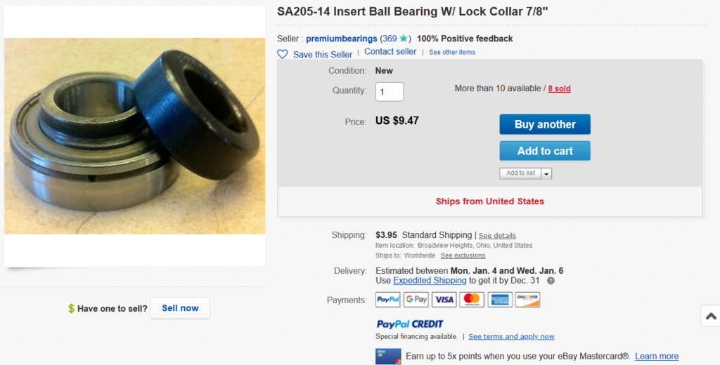

HorseFixer 2,015 #5 Posted December 28, 2020 Hey Guys! Thanks All! We got a foot of snow here on X-mas day in SW Michigan and figured I would get the Snow Chucker out and stretch its legs a little. A couple minutes and the Auger Stopped O#*EY(@&#^($&)^)!*&#$^)!*#( WT Heck! Anyways it Blew a Master Link on the Drive Chain So I had 10' Of Chain and links so I fixed It. Took it out again and after 10 Minutes of blowin it stopped dead in its tracks again. I thought shear pin never replaced one (don't even know if it has one?) But after looking the chain was broke again. I checked and the master link was gone! I pulled it in the garage Got My Trusty Grill Spatula Awe Hell a liile grease will make them burgers slide and taste a lil better! Anyways Figured it had to be a rock I hit so used the spatula to remove the snow and dig around and find the rock. After 10 minutes I didn't find any so I let it than over the floor drain and then I could Pull it back in its spot and work on it. A couple hrs later after the snow was melted I backed it up and tore into it. I figured the bearing was shot and the the chain got loose and blew a link. The Collar was flopping around so i took it apart, After examination of the parts the bearing didn't look all that bad altho I figured I would change it anyway since I have it apart. So I figured I would pull my Brand New F-350 XLT back in the garage by that time all the snow was melted and low and behold there was a rock big as my fist broke in half and it all made sense. I never rebuilt the Blower 100% When I did the Automation When I Built The Snow Chucker in Oct 2011. Wow coming up on 10 years already. Well anyways I want the bearings like yesterday and with everyone's help on cross reference #'s I can get them Here. I will go ahead and replace the Bearing and this summer I will rebuild it to 100% like I did the Tractor. Its a Fun Machine To Operate. Its pretty tuff Plowin the Snow in my Jammies its a tuff job but someone has to do it! For those who haven't seen it in Operation You Can See It Here. Anyway I plan on replacing the Cheap Bronze 1" bearings with Greaseable 1" 4 Bolt Flange Bearings this summer. Anyways thanks for everyone's Help, here is a Picture of Our new Truck and yes it is Red. 1 Share this post Link to post Share on other sites
