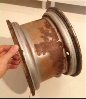

Maxwell-8 4,371 #1 Posted December 27, 2020 (edited) This just came up in my mind, When i was restoring some WH rims. I had rust in the inside of my rims, asking myself: How? it's sealed with the tire. And then i realized how: no water separator on the previous owner's compressor, i monthly open the tab on my compressor, and some rust water always comes out. Just wanted to share this. I am grabbing a water separator for my compressor tomorrow. Edited December 27, 2020 by Maxwell-8 1 4 Share this post Link to post Share on other sites

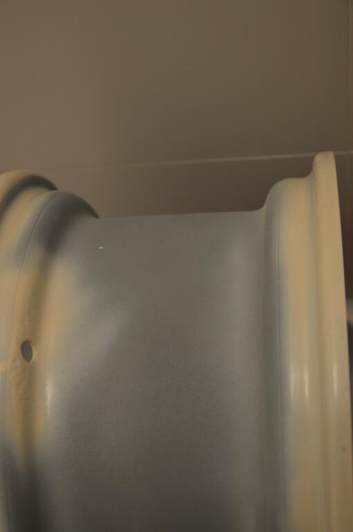

Pollack Pete 2,273 #4 Posted December 27, 2020 (edited) That water seperator you show will only seperate water from your air hose,which is a good thing.But,you've got to open the drain on the bottom of the tank to blow out the big amount of water.I use my compressors every day and drain the water out every day.You would not believe how much rusty water I get out daily.As far as rust on the inside of the rims.When I restore a rim.I sandblast the entire rim.Paint the inside with POR-15 paint.Rattle can prime both sides of the rim.Finish up with either Eastwood argent paint or International Harverster white,depending which model Horse I'm working on.Last thing is a new rubber pop in valve stem if I'm using tubeless tires.The combination of nice shiny paint and spraying the tire bead with furniture polish makes the tire a lot easier to mount. Edited December 27, 2020 by Pollack Pete 2 3 Share this post Link to post Share on other sites

Achto 32,927 #6 Posted December 27, 2020 One other reason why rims rust from the inside is that they are not painted as well on the inside as they are are outside. This is usually very evident when you buy new rims. Yes the inside is a "sealed environment" once the tire is mounted but temperature changes will still cause condensation on the inside of the rim. When I paint rims for one of my resto's I make sure that the inside is as well as the outside is. 4 Share this post Link to post Share on other sites

Maxwell-8 4,371 #14 Posted December 28, 2020 I use Zinc spray on the inside of all my rims, never had any problems myself with this method. Share this post Link to post Share on other sites
Jeff-C175 7,211 #15 Posted December 28, 2020 1 hour ago, oliver2-44 said: The rust preventative is for the rusty tin surface it's usually painted on. Ohhh... it's an aluminized coating for tin roofs, not a coating for aluminum roofs. I get it now. Share this post Link to post Share on other sites
Jeff-C175 7,211 #16 Posted December 28, 2020 1 hour ago, Maxwell-8 said: Zinc spray I believe we call that "cold galvanize". I would consider that over freshly sandblasted parts, but if there's even a trace of rust I would want to use a 'rust converter' product first. Turn the red rust into black rust which is basically inert. Share this post Link to post Share on other sites
