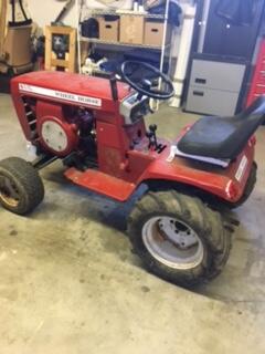

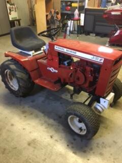

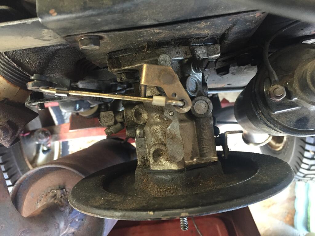

kevincva1 24 #1 Posted December 27, 2020 Hi everyone. Just bought a C101, the throttle cable is not connected at the carburetor and seems to missing some small pieces. Tried looking for a parts diagram for it, but not having much luck. Could some one take a picture of one that you have so I could see what I need to fix ours. Thank you Share this post Link to post Share on other sites

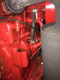

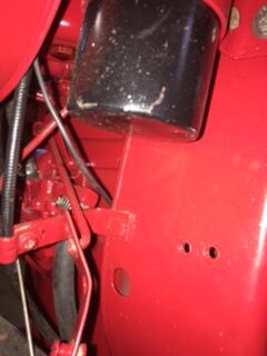

rjg854 13,383 #2 Posted December 27, 2020 @kevincva1 can you also post a picture of what you have? That would help us, help you. 1 Share this post Link to post Share on other sites
Herder 2,356 #3 Posted December 27, 2020 (edited) to Edited December 27, 2020 by Herder 3 2 1 Share this post Link to post Share on other sites

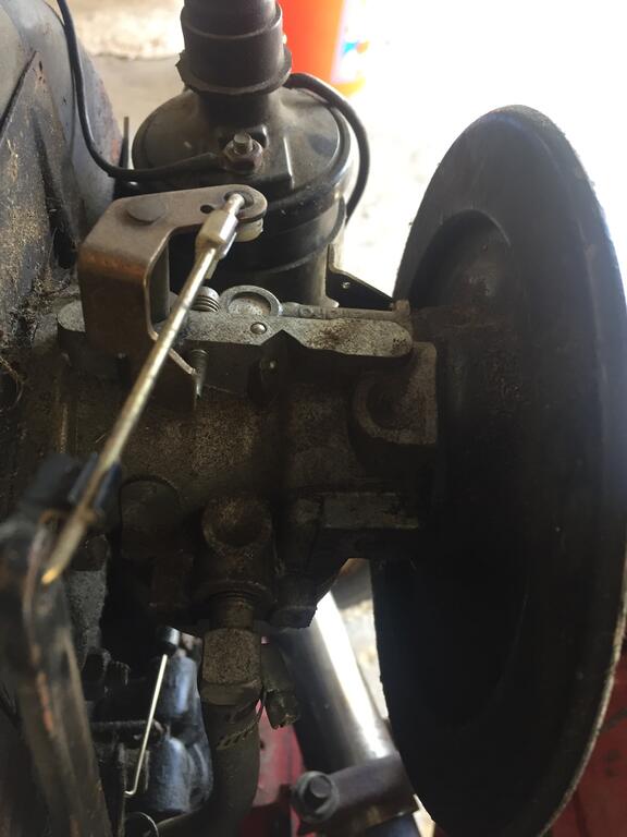

SylvanLakeWH 32,613 #5 Posted December 27, 2020 Few more: 4 Share this post Link to post Share on other sites
kevincva1 24 #6 Posted December 27, 2020 Awesome, thank you all for sending the pictures. That really helps 1 1 1 Share this post Link to post Share on other sites

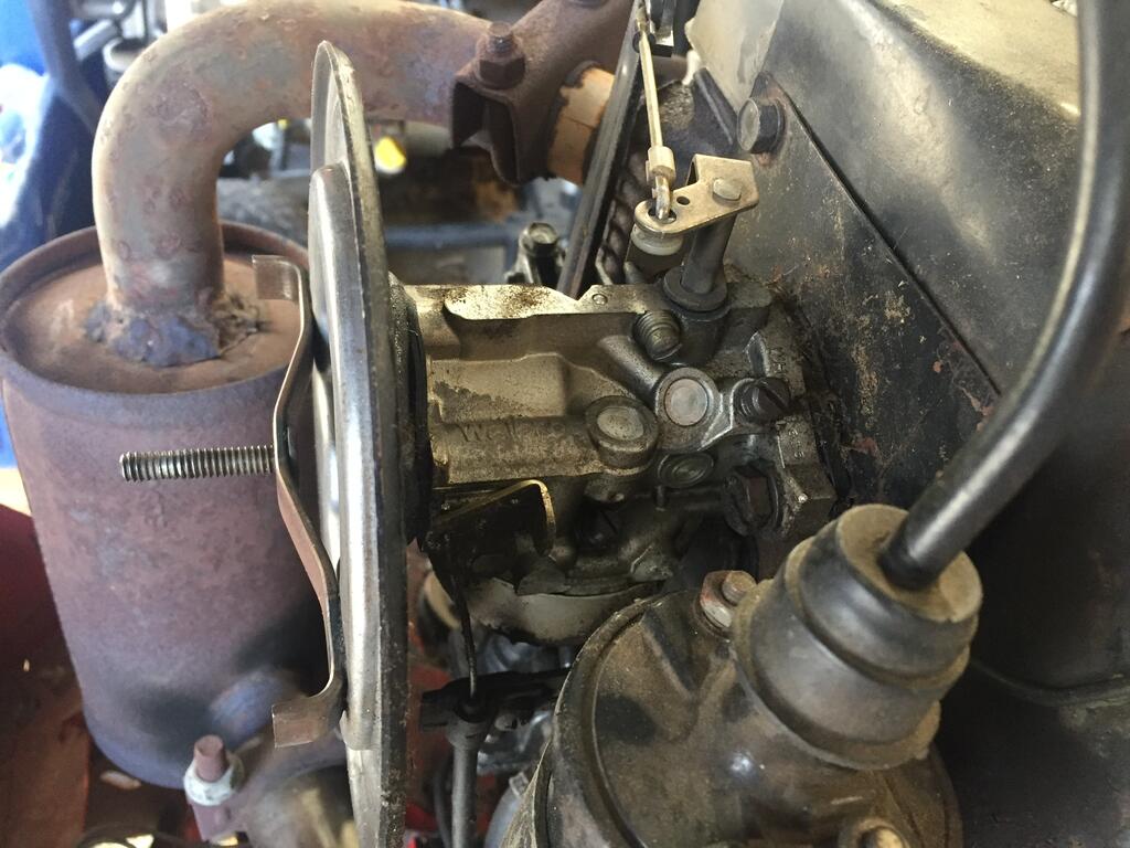

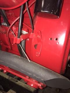

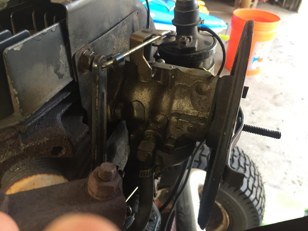

kevincva1 24 #7 Posted December 27, 2020 Here are some pictures, not sure where to mount the lever that the throttle cable connects to. 1 Share this post Link to post Share on other sites
953 nut 69,559 #8 Posted December 28, 2020 Your ignition coil may be covering the hole where the linkage mounts. Share this post Link to post Share on other sites
oldredrider 2,553 #9 Posted December 28, 2020 Also, your choke cable clamp should be mounted higher on the shroud. 1 Share this post Link to post Share on other sites
kevincva1 24 #10 Posted December 28, 2020 Ok so here is what I think may have happened. I just bought this tractor from a guy in the next county over from me. It was a Father/son project. There was supposed to be a parts tractor to come with the sale but it was taken off his property at some time in the last couple weeks. So I am thinking they either swapped the engine from the other tractor or the shroud is wrong for this application. Any one out there have a spare shroud for a K241 they would be willing to part with and for how much? Thank you everyone for your help. 1 Share this post Link to post Share on other sites

kevincva1 24 #14 Posted January 18, 2021 35 minutes ago, ebinmaine said: My apologies for dropping the ball here..... Are you still looking for that shroud? Hey no worries. I am going to drill a hole in mine and weld a nut in place to make it work. 2 Share this post Link to post Share on other sites
