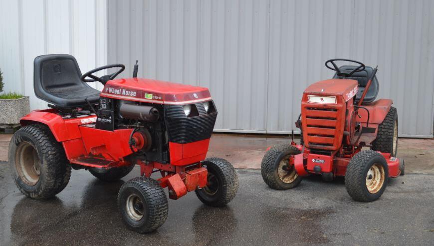

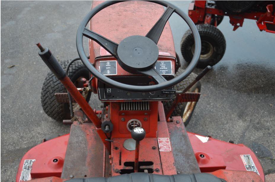

Maxwell-8 4,371 #1 Posted December 23, 2020 A Belgium made Raider 10 with the 4speed and a Kohler M12 Saved from a mudhole 7 2 Share this post Link to post Share on other sites
Pollack Pete 2,273 #2 Posted December 23, 2020 Looks good to me.Why would someone leave it in a mud hole?? Does it need a lot of work?Have fun with your new toy. 2 1 Share this post Link to post Share on other sites
ebinmaine 80,642 #3 Posted December 23, 2020 So I take it the M12 is a repower because it should have had a K12? What are your plans for this tractor and how many do you have now? 1 Share this post Link to post Share on other sites
953 nut 69,148 #4 Posted December 23, 2020 Looking good, I think you have a great find there. 1 1 Share this post Link to post Share on other sites

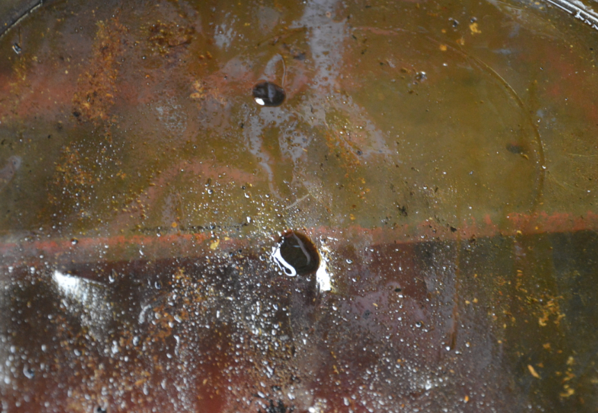

Maxwell-8 4,371 #5 Posted December 24, 2020 (edited) 22 hours ago, Pollack Pete said: Looks good to me.Why would someone leave it in a mud hole?? Does it need a lot of work?Have fun with your new toy. It needed some carb work, because of the ethanol the carb bowl had holes in it The carb bowl was no longer available, so we solderd it Runs great now! If something is old, it automatically gets seen as worthless. But i don't need that modern junk Edited December 24, 2020 by Maxwell-8 Correcting autocorrection 1 1 Share this post Link to post Share on other sites

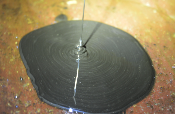

Maxwell-8 4,371 #11 Posted January 20, 2021 I replaced the transmission oil on the mudhole raider, so i jacked the front up. remove the drain plug and .... 2 drips Mmhh no oil in the trans?? the outside of the case looked so clean. The shine in the rest of the pain gives you a clue how the oil looked that i changed today on the Kohler Expess 312-8. But after some pooking around in the drain hole on the raider, this came dripping out. Yaiks!! So thick, must have some mud mixed in it, And do i see metal flaks? 1 Share this post Link to post Share on other sites
ebinmaine 80,642 #12 Posted January 20, 2021 46 minutes ago, Maxwell-8 said: I replaced the transmission oil on the mudhole raider, so i jacked the front up. remove the drain plug and .... 2 drips Mmhh no oil in the trans?? the outside of the case looked so clean. The shine in the rest of the pain gives you a clue how the oil looked that i changed today on the Kohler Expess 312-8. But after some pooking around in the drain hole on the raider, this came dripping out. Yaiks!! So thick, must have some mud mixed in it, And do i see metal flaks? That is most certainly gray enough to have some metal mixed in. But after who knows how many years since it's been changed. It's hard to get that worried about it. Best bet is to run a couple of diesel flushes through it and when you go to put the gear oil back in, add a magnet somewhere. Drain plug. Neodymium magnet on the outside. Something to catch the filings. 1 1 Share this post Link to post Share on other sites
Maxwell-8 4,371 #13 Posted January 20, 2021 6 minutes ago, ebinmaine said: That is most certainly gray enough to have some metal mixed in. But after who knows how many years since it's been changed. It's hard to get that worried about it. Best bet is to run a couple of diesel flushes through it and when you go to put the gear oil back in, add a magnet somewhere. Drain plug. Neodymium magnet on the outside. Something to catch the filings. Can't do to many diesel flushes, or i will be getting in problems with my supervisors. Share this post Link to post Share on other sites
ebinmaine 80,642 #14 Posted January 20, 2021 9 minutes ago, Maxwell-8 said: Can't do to many diesel flushes, or i will be getting in problems with my supervisors. Can you do something instead like change the oil more often? 1 Share this post Link to post Share on other sites
Maxwell-8 4,371 #15 Posted January 20, 2021 3 minutes ago, ebinmaine said: Can you do something instead like change the oil more often? My parents don't like me to change that stuff all the time, And the oil is pretty cheap around here, so changing that stuff more often is perfect for me an the usage they will see witch isn't a ton. I just changed the oil in my 312-8 no flushes, and after some grading it's still very clean, i will see what is needed! 1 Share this post Link to post Share on other sites
ebinmaine 80,642 #16 Posted January 20, 2021 11 minutes ago, Maxwell-8 said: My parents don't like me to change that stuff all the time, And the oil is pretty cheap around here, so changing that stuff more often is perfect for me an the usage they will see witch isn't a ton. I just changed the oil in my 312-8 no flushes, and after some grading it's still very clean, i will see what is needed! That would be the way to do it. Any chance you can get a hold of a magnetic drain plug or a neodymium magnet? 1 Share this post Link to post Share on other sites
Maxwell-8 4,371 #17 Posted January 20, 2021 1 minute ago, ebinmaine said: That would be the way to do it. Any chance you can get a hold of a magnetic drain plug or a neodymium magnet? I will have to go search for that. Or maybe magnatize my plug 1 Share this post Link to post Share on other sites

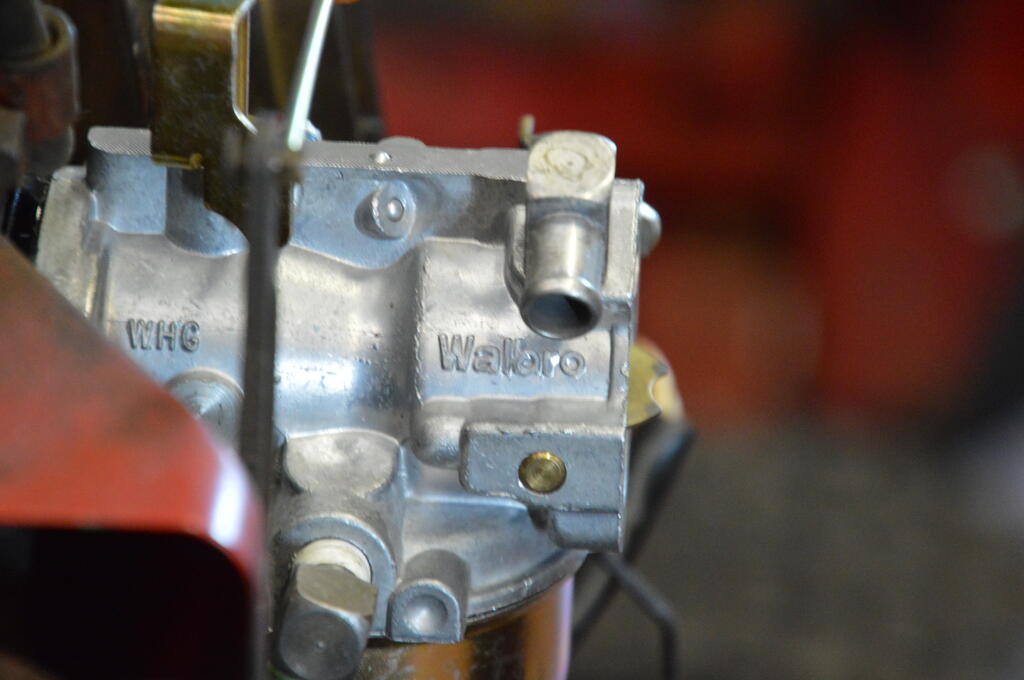

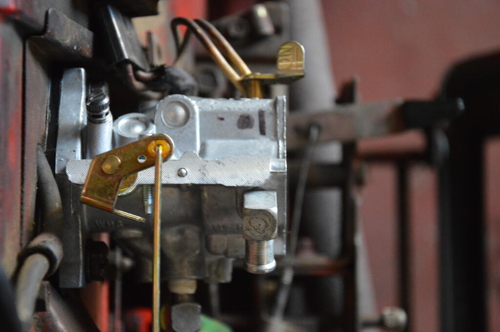

Maxwell-8 4,371 #18 Posted September 16, 2021 Have had a wanted ad on our local CL for a couple of months, searching an good non-chinees carb for the M12. Finaly someone answered. A brand NOS walbro carb and lots of parts that are untraceable here in Belgium. 2 Share this post Link to post Share on other sites

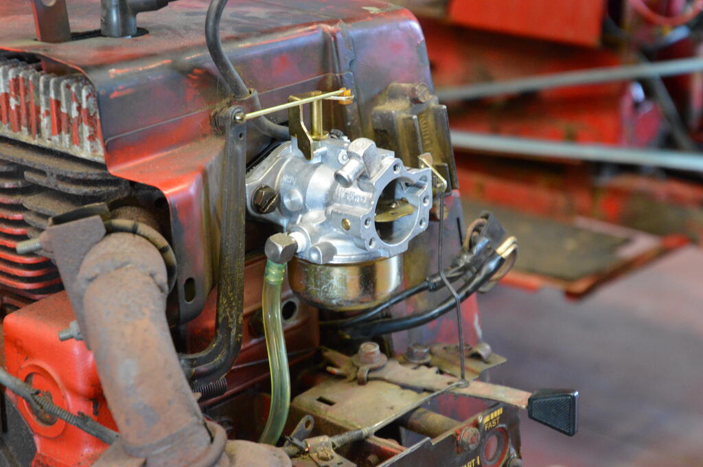

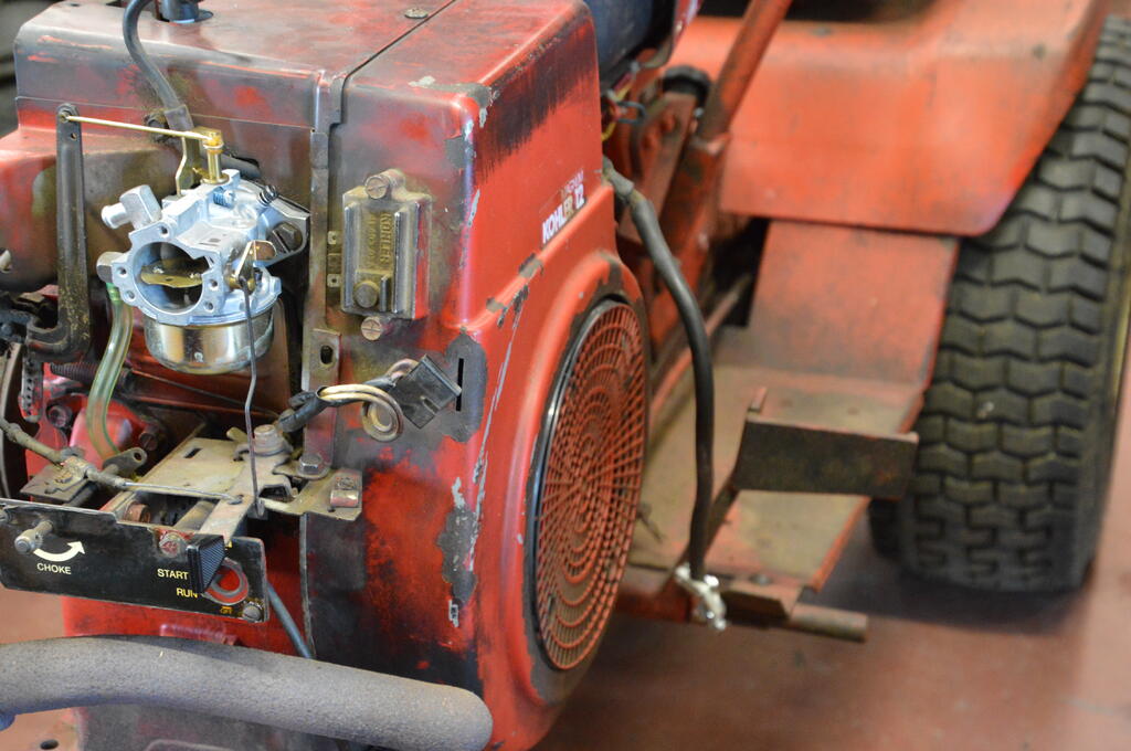

Maxwell-8 4,371 #20 Posted September 28, 2021 Had time to work on the horses today, but dang.. choke lever won't allow me to use an airfilter Share this post Link to post Share on other sites
ebinmaine 80,642 #21 Posted September 28, 2021 Take the choke out, cut adjust and reattach the lever.. Or swap it with another lever. I'd rather have no choke than no air filter any day. 1 Share this post Link to post Share on other sites

kpinnc 18,939 #24 Posted November 26, 2021 Somebody correct me here if I'm wrong, but can't he use a K series breather on that carb? It would give room to that choke tab... Might be harder to find overseas, but regularly available on fleabay. 1 1 Share this post Link to post Share on other sites
Maxwell-8 4,371 #25 Posted November 26, 2021 9 hours ago, kpinnc said: Somebody correct me here if I'm wrong, but can't he use a K series breather on that carb? It would give room to that choke tab... Might be harder to find overseas, but regularly available on fleabay. Yes, I would have fitted since I run a K-series carb. But I have searched for it for a couple of months without any luck. Share this post Link to post Share on other sites
