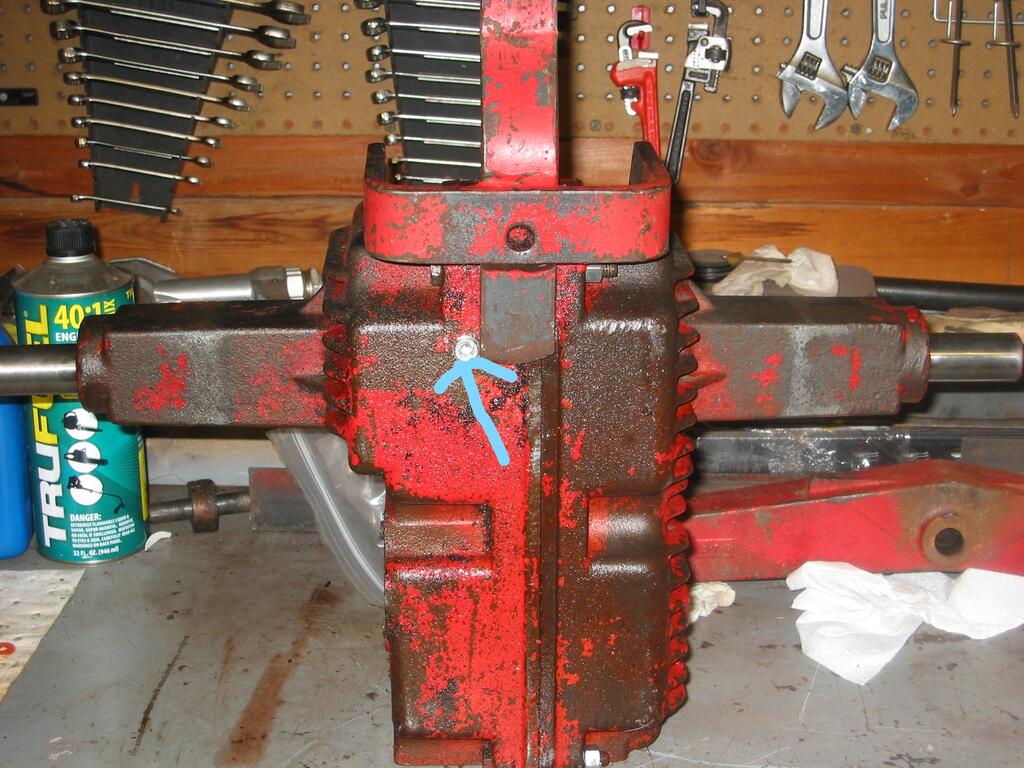

RICH FRO 16 #1 Posted December 22, 2020 Hi I'm new to this site and will appreciate any information you can give me. I have a 1977 C-160 8 speed and I am looking to change the tranny oil. I see the fill hole but I don't see a drain plug . How do I drain the tranny oil ? How much will it take to refill it and with which oil ? Thanks for any info. Rich edit:: Rich, I took the liberty to erase your personal information from this post. You should not post that kind of information. The members will answer you here and if they want to talk with you on the phone...I suggest you exchange that information with Personnel Messages. Stevasaurus 2 Share this post Link to post Share on other sites
pfrederi 19,941 #2 Posted December 22, 2020 it is a 1/4" hex (allen type) plug on the bottom. maybe packed with crud. Raise front of tractor to help better drain the oil. 3 Share this post Link to post Share on other sites
peter lena 9,779 #3 Posted December 22, 2020 RICH FRO, excellent picture from PFREDERI ABOVE ! THE CAPACITY IS 2 QTS , 75-90 wt or in that range , question is your shifter boot torn or damaged ? replace it , that is also the main entry spot for water entry. is the oil a milky color ? that's water / oil mix . if the oil is milky , it would be good to flush it out with kerosene or atf fluid , using some road time if possible to increase the flushing action. also while on the road use every gear and hi/lo range changes to improve the flushing and ensure easy gear changes' I would put some time on the flush oil. like hours , till that oil looks dirty , before going to the regular gear oil . another thing is to LUBRICATE every movement point on your clutch linkage , to ensure smooth / easy shifting. let us know how you make out , pete Share this post Link to post Share on other sites
RICH FRO 16 #4 Posted December 22, 2020 You were right , packed with crud . I got it now . Thanks a lot ! ! Rich 2 Share this post Link to post Share on other sites
RICH FRO 16 #5 Posted December 22, 2020 Yeah its the first time I have changed it and is very milky . Where would be a good place to locate a shifter boot ? 1 Share this post Link to post Share on other sites
