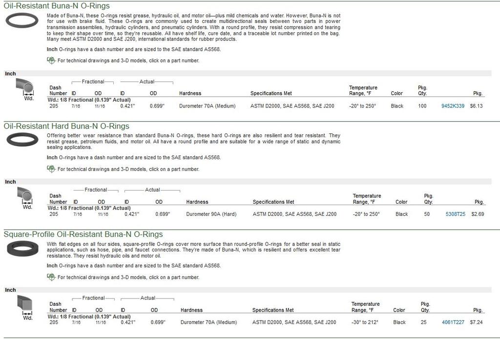

I am not sure about the Sunstrand unique numbers Is it a square profile or round.??? these are 205 dimensions

Funny thing is that I don't recall removing an o-ring from there.  And I don't think one in that location will make any difference.  That said I will pick up a pack of the square cut ones and then I put it back together I can see which one fits better.
For the backup o-ring used on the manifold, in the past I have used the contoured backup rings, because they sit nicer on the o-ring.  Do you think I should use the square cut split ones instead?

 The O-ring on page 60/62, Item #82, Part# 200205 is not a -205.  A dash 205 is too small to allow the motor shaft through.
The space between the centering pilot and the motor shaft is too large to use any size o-ring.  Also any oil that leaks from the case through the motor shaft should be minimal and will just drip into the tank (trans).
