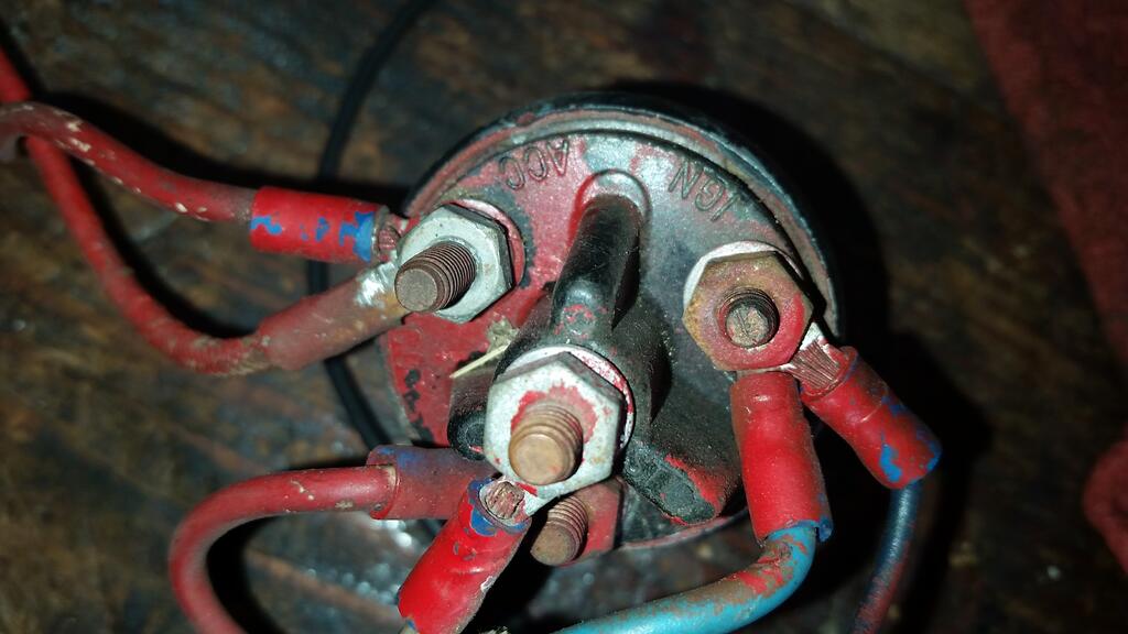

WHX?? 58,218 #4 Posted December 22, 2020 (edited) If you are running the four term switch. If it still has the orginal 70 amp three term just go to the L term on the regulator. 867 should have a cigar lighter that goes to L too. Fuse it and make sure the lights get a decent ground... grounding to the hood may not cut it and they flicker. Edited December 22, 2020 by WHX24 pic 1 Share this post Link to post Share on other sites

WHX?? 58,218 #7 Posted December 23, 2020 3 hours ago, Achto said: I like to tap into accessory power on the switch. This way the lights go out when you shut the tractor off. Less chance of a dead battery do to lights being left on with this set up. You can also plug the pellet grill into the cigar lighter if that's wired to acc. Turn the key to acc. and have pulled pork at shows! 3 1 Share this post Link to post Share on other sites
