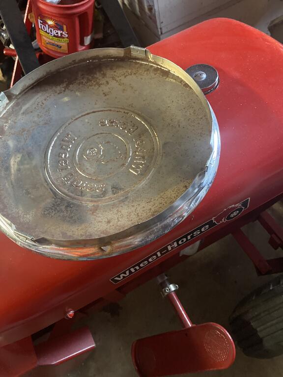

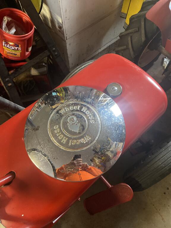

Horse Newbie 7,405 #6 Posted December 20, 2020 (edited) 4 hours ago, WVHillbilly520H said: @Horse Newbie, how much did it set you back for blasting and powdercoating your 520 wheels? @Mikefeds 2 front rims= $100 2 back rims= $150 4 hub caps= $40 Wheels- gloss white powder coat Hub caps- shiny chrome powder coat, they didn't have stainless steel like you showed, but I think the shiny chrome will be nice if it matches their sample Supposed to pick them up Monday... Edited December 20, 2020 by Horse Newbie 1 Share this post Link to post Share on other sites
WVHillbilly520H 10,379 #7 Posted December 20, 2020 9 minutes ago, Horse Newbie said: @Mikefeds 2 front rims= $100 2 back rims= $150 4 hub caps= $40 Wheels- gloss white powder coat Hub caps- shiny chrome powder coat, they didn't have stainless steel like you showed, but I think the shiny chrome will be nice if it matches their sample Supposed to pick them up Monday... Hope to see those "shiny chrome" caps on here. Share this post Link to post Share on other sites

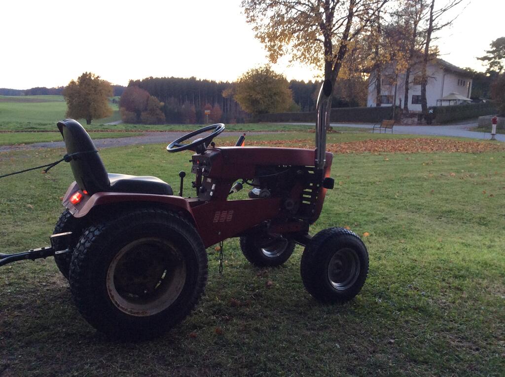

Tractorhead 9,217 #8 Posted December 20, 2020 I choosed also after an Tyre loosening Air to replace them. While Rubber went off, i decide to let them sandblast and powdercoat in Alu Silver like the Front Rims are. Will also pickup mine on Monday. 2 x Rear Rims Sandblasted and Powdercoated makes 150€ 2 Share this post Link to post Share on other sites

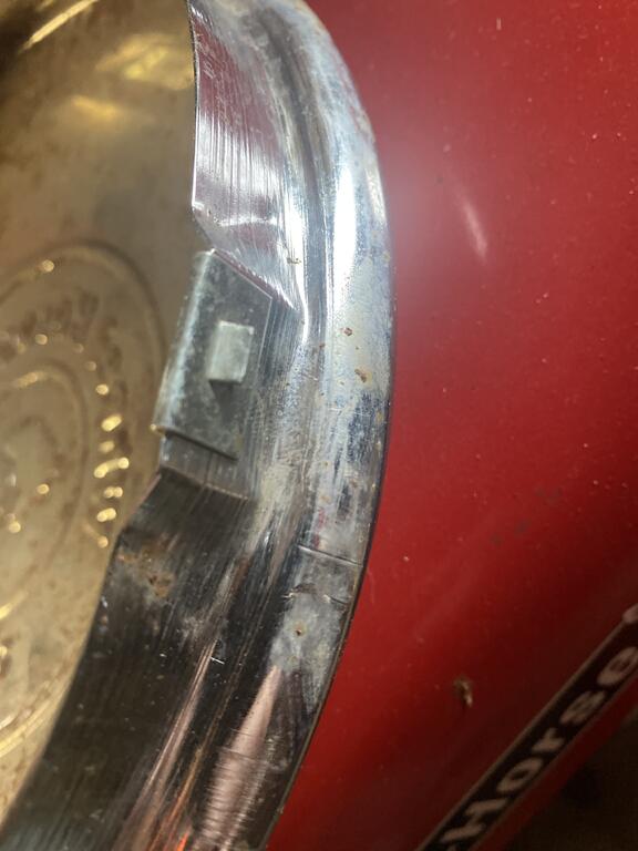

Horse Newbie 7,405 #9 Posted December 20, 2020 36 minutes ago, WVHillbilly520H said: Hope to see those "shiny chrome" caps on here Oh you definitely will...but probably not until I paint the "horse emblem " in the middle, and the black circle like yours...by the way Do you know where I could possibly get my hands on the clips that hold the hub caps on the wheels ? Share this post Link to post Share on other sites
Horse Newbie 7,405 #10 Posted December 20, 2020 5 minutes ago, Tractorhead said: I choosed also after an Tyre loosening Air to replace them. While Rubber went off, i decide to let them sandblast and powdercoat in Alu Silver like the Front Rims are. Will also pickup mine on Monday. 2 x Rear Rims Sandblasted and Powdercoated makes 150€ Man that silver looks good...I had a hard time deciding whether to go back with silver or white...finally decided on white mainly because of other guys tractors I've seen on Red Square. 1 Share this post Link to post Share on other sites

WVHillbilly520H 10,379 #15 Posted December 20, 2020 1 hour ago, Horse Newbie said: Do you know where I could possibly get my hands on the clips that hold the hub caps on the wheels ? Not off hand. Share this post Link to post Share on other sites
AMC RULES 37,259 #16 Posted December 20, 2020 (edited) Search Ebay... "hub cap clips" Edited December 20, 2020 by AMC RULES Share this post Link to post Share on other sites
Horse Newbie 7,405 #17 Posted December 20, 2020 53 minutes ago, AMC RULES said: Search Ebay... "hub cap clips" Good idea !... Thanks ! Share this post Link to post Share on other sites
Lane Ranger 12,111 #18 Posted December 20, 2020 (edited) 17 hours ago, WVHillbilly520H said: Not off hand. Check out Loves Truck stop. They have a big truck hubcap section. That’s where I bought my replacement metal clips for my hubcaps! I Edited December 20, 2020 by Lane Ranger 2 Share this post Link to post Share on other sites
WVHillbilly520H 10,379 #19 Posted December 20, 2020 11 minutes ago, Lane Ranger said: Check out Loves Truck stop. They have a big truck hubcap section. That’s dhere I bought my replacement metal clips for my hubcaps! I Got this one nearby... https://www.whitestravelcenter.com/ and a small Love's closer. Thanks Lane. 1 Share this post Link to post Share on other sites
Horse Newbie 7,405 #20 Posted December 20, 2020 43 minutes ago, WVHillbilly520H said: Got this one nearby... https://www.whitestravelcenter.com/ and a small Love's closer. Thanks Lane. I have a Love's that I can check out Monday when I go to Gotham(Charlotte NC) to work...thanks guys ! 1 Share this post Link to post Share on other sites
Wheelhorse Wes 279 #21 Posted December 20, 2020 Wheelhorse parts and more I believe has those clips 1 Share this post Link to post Share on other sites
