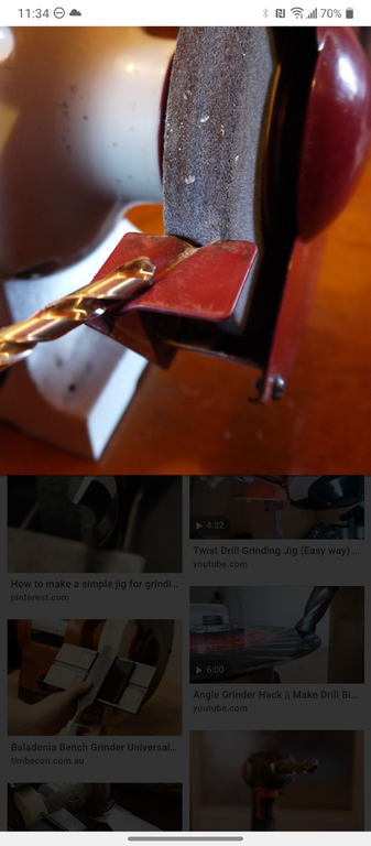

WVHillbilly520H 10,378 #25 Posted December 21, 2020 I learned to grind drill bits while working as a machinist in training but most of our bench grinders had a rest with the correct angle to follow. But after learning the basics a belt sander works just as good especially for larger say 3/4" and up. Also depending on material you are working with aluminum,brass, bronze, tool steels, or more common low carbon steels cold/hot rolled ect, or even wood sharper or flattering angles are needed for better smoother faster cutting than the standard 118° or 135° angles as I was taught by my mentor being in the trade for 40 years, the biggest thing to remember is to have a thin sharp cutting edge on both sides with enough chip relief below that edge as not drag in the bottom of the hole you are trying bore. Then speed and feed and lube depending on materials plus don't try to drill a 3/4" hole in 1 pass step it up (under 1/4" single pass should work) at least 2-4 sizes till the one you want works best then of course a 60° center drill helps greatly too. 2 Share this post Link to post Share on other sites
