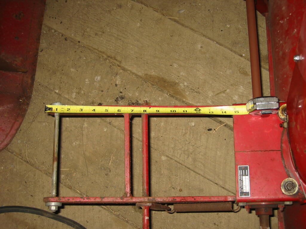

adsm08 5,006 #1 Posted December 19, 2020 So this summer I picked up an ST326 blower for my 855. I went to mount it up a few weeks ago to test it out and couldn't find a setup that looked like it would work. It looks like I am in need of a set of mounting plates that go in front of the axle, similar to the 8-5551 set I put on my 800 Special, but I don't see a set of holes to mount that set to. Is the 8-5551 kit correct for a short-frame tractor as well, or is there something else? Share this post Link to post Share on other sites
pfrederi 21,049 #2 Posted December 19, 2020 You need a 8-1/2 inch 3/8NC bolt and two 3/8 ID 1/2 OD sleeves (silver bolt in picture) It goes through the first side holes on the tractor frame 1 1 Share this post Link to post Share on other sites
adsm08 5,006 #3 Posted December 19, 2020 5 hours ago, pfrederi said: You need a 8-1/2 inch 3/8NC bolt and two 3/8 ID 1/2 OD sleeves (silver bolt in picture) It goes through the first side holes on the tractor frame Ok, awesome. The bolt came with the blower and I thought it was just a ghetto-fab pivot bar. That means the only thing I need that I don't have are a chute cable and a running engine, and @wheelhorseman has the cables for like $10. Share this post Link to post Share on other sites

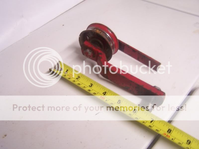

adsm08 5,006 #4 Posted January 10, 2021 Learned today I am missing a piece. I don't have the 5619 mounting bracket or the MW-8821 idler pulley. The pulley Lowell has. That bracket for the puller seems to be unobtainable. Any chance anybody has one and can get me dimensions on it? I have found a picture and it looks like I can build one easy enough, I just need to know the sizes/lengths. Share this post Link to post Share on other sites
wildman 205 #5 Posted February 21, 2021 On 1/10/2021 at 4:40 PM, adsm08 said: Learned today I am missing a piece. I don't have the 5619 mounting bracket or the MW-8821 idler pulley. The pulley Lowell has. That bracket for the puller seems to be unobtainable. Any chance anybody has one and can get me dimensions on it? I have found a picture and it looks like I can build one easy enough, I just need to know the sizes/lengths. I am also looking for these dimensions Share this post Link to post Share on other sites
