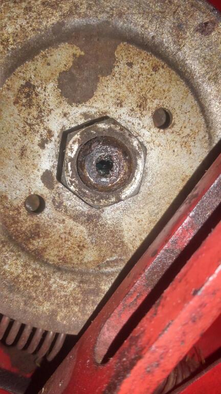

Rusty Tinsnips 477 #1 Posted December 18, 2020 The model number sticker is gone. Seems I'm missing the center spindle grease zirk? Share this post Link to post Share on other sites

Charbs152 257 #3 Posted December 18, 2020 1 hour ago, Rusty Tinsnips said: The model number sticker is gone. Seems I'm missing the center spindle grease zirk? 42 inch deck, what do you want to know exactly? They are all mostly the same for the most part 2 Share this post Link to post Share on other sites
Rusty Tinsnips 477 #4 Posted December 18, 2020 Just wanted to know the model number for parts and the correct blades and OEM maintenance procedures. Share this post Link to post Share on other sites
Charbs152 257 #5 Posted December 18, 2020 11 minutes ago, Rusty Tinsnips said: Just wanted to know the model number for parts and the correct blades and OEM maintenance procedures. it looks like a later model, you'll have to lookup all the model #s provided and find the one that looks the most correct. what tractor did it come off of? 1 Share this post Link to post Share on other sites
johnnymag3 2,647 #6 Posted December 18, 2020 The grease zerk is the same on all of those 42" decks. Clean out the hole, check the threads, and insert zerk. Seems pretty solid. Most of all the parts you need are readily available John 1 1 Share this post Link to post Share on other sites
Rusty Tinsnips 477 #7 Posted December 18, 2020 Thank you. This came with a 1972 Raider 14. I just found a manual for a 72 deck and it looks similar. Share this post Link to post Share on other sites
Charbs152 257 #8 Posted December 18, 2020 (edited) 38 minutes ago, Rusty Tinsnips said: Thank you. This came with a 1972 Raider 14. I just found a manual for a 72 deck and it looks similar. That deck is CLEAN for a 72! I am restoring a 48 inch deck this winter, just rebuilt the spindles, new paint, bushings etc.. Feel free to ask any questions. my center grase zerk was broke too... It hits my lift carriage..i have to either p[properly adjust the deck, or if theres too much slop, ill put a set screw in the spindle and pop the grease zerk in a couple times a summer to grease it. (common problem with that center grease zerk... You can also convert to completeness sealed bearings and eliminate greasing the spindles all together but i prefer to pack them full of grease. Edited December 18, 2020 by Charbs152 1 Share this post Link to post Share on other sites
Rusty Tinsnips 477 #9 Posted December 18, 2020 3 hours ago, Charbs152 said: That deck is CLEAN for a 72! I really don't know anything about this deck, just started messing with it. I cleaned it up per advise from pete-lena. Looks to be in very good condition. Will a 90 degree zerk work without breaking off? Share this post Link to post Share on other sites
lynnmor 9,012 #10 Posted December 18, 2020 11 minutes ago, Rusty Tinsnips said: Will a 90 degree zerk work without breaking off? A 90 degree will stick up nearly as high as straight one and might hit even more. My zerks are real close, but I have never broken one. If you have excessive wear in the hitch that may be the problem. 1 Share this post Link to post Share on other sites
Lee1977 7,750 #11 Posted December 18, 2020 (edited) That looks to be a later model deck...I think its a 1990 or later Deck. Edited December 18, 2020 by Lee1977 1 Share this post Link to post Share on other sites
johnnymag3 2,647 #12 Posted December 18, 2020 28 minutes ago, Lee1977 said: That looks to be a later model deck...I think its a 1990 or later Deck. I agree, the extra black welded support plate under the rear tires bar is a dead giveaway, and the decal is not 1970 ish era. There is also a rod welded to the front of the deck, it follows the contour.Another later addition My .02 cents....with 20-20 vision 1 Share this post Link to post Share on other sites
Rusty Tinsnips 477 #13 Posted December 19, 2020 Well, now I have downloaded a file for a 1995 deck with some good color pictures and it looks exactly like that. It says that it is for the 300, 400 and 500 series machines. Will it work on my 1972 Raider? 1 Share this post Link to post Share on other sites
953 nut 68,508 #14 Posted December 19, 2020 4 minutes ago, Rusty Tinsnips said: Will it work on my 1972 Raider? If you have a front mule drive or can attach one to the Raider it should work OK. 1 Share this post Link to post Share on other sites
Rusty Tinsnips 477 #15 Posted December 19, 2020 1 minute ago, 953 nut said: If you have a front mule drive or can attach one to the Raider it should work OK. Thanks, one came with it. Will probably never mow with it but nice to know it will work. 1 Share this post Link to post Share on other sites
Rusty Tinsnips 477 #16 Posted December 19, 2020 2 hours ago, Lee1977 said: That looks to be a later model deck...I think its a 1990 or later Deck. Have looked at all the 90's manuals, I'm 90 percent sure ( looking at VinylGuy's decals for decks ) that this is a 1990. Thanks for everyone's help. 1 1 Share this post Link to post Share on other sites
