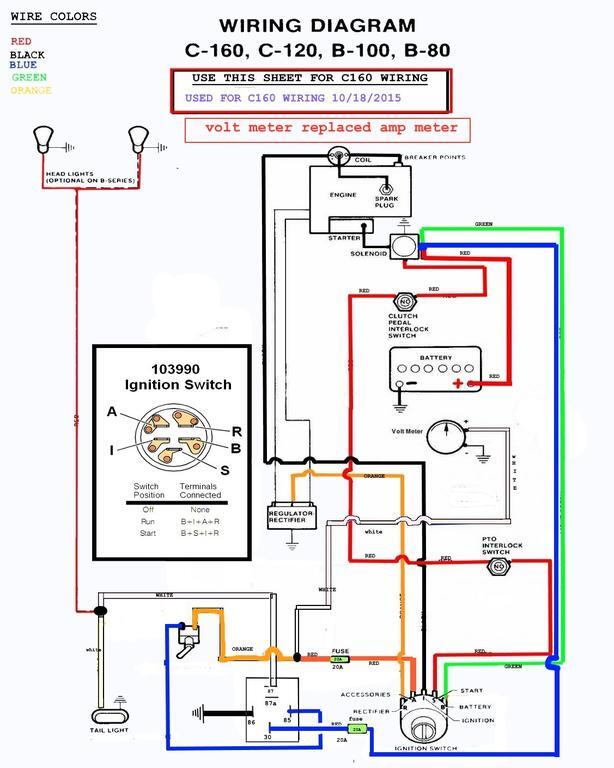

jmpianoman19 1 #1 Posted December 18, 2020 Looking for a wiring harness to fit a c101. With or without lights Share this post Link to post Share on other sites
953 nut 67,235 #2 Posted December 18, 2020 A direct fit wiring harness for a that is four decades old is going to be hard to find. But, you can make your own and have the opportunity to add lights or a power outlet if you wish.. Here are a couple diagrams to get you started. Many of us prefer to use a volt meter rather than an amp meter as shown in the first drawing by @BOB ELLISON. 2 Share this post Link to post Share on other sites
