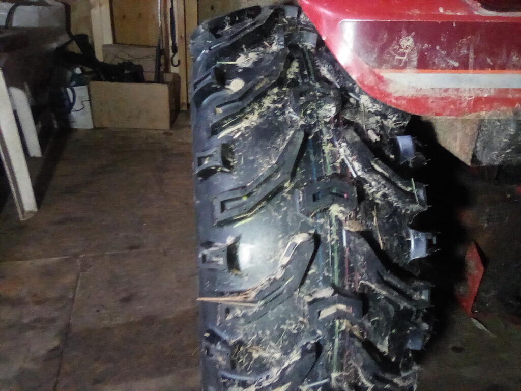

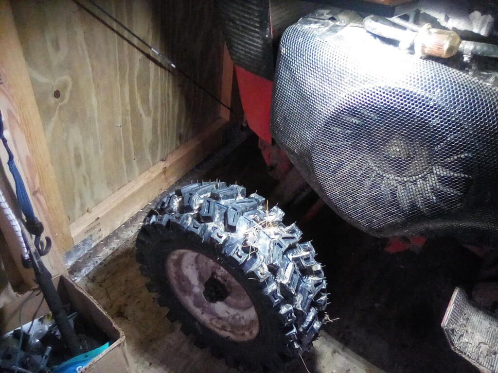

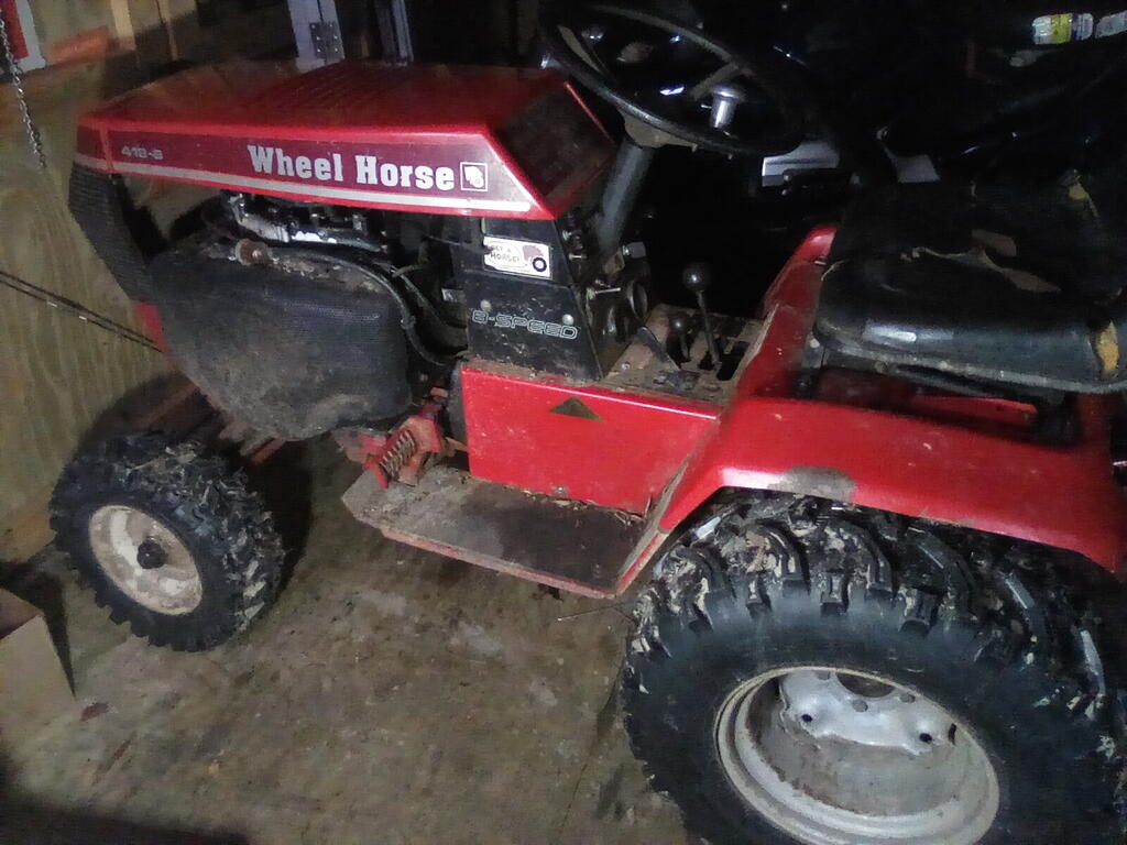

mike67 33 #35 Posted December 30, 2020 (edited) I have an '87 418-8 with Carlisle x-trac 16x6.50-8 on the front, Kenda Bear Claw 25x10-12 on the rear (one inch fender lift for clearance), pulley swapped to a top speed of around 15mph, open diff for now. Goes very well anywhere I point it. I plan on locking the diff at some point. On YouTube, look up 'mud mowers'. Some of those guys insist on locking the diff, others not so much. Look for 'mud mowers from hell- hill climb'. A wheel horse named Stiletto is pretty impressive. (No, its not mine). Edited December 30, 2020 by mike67 1 Share this post Link to post Share on other sites
