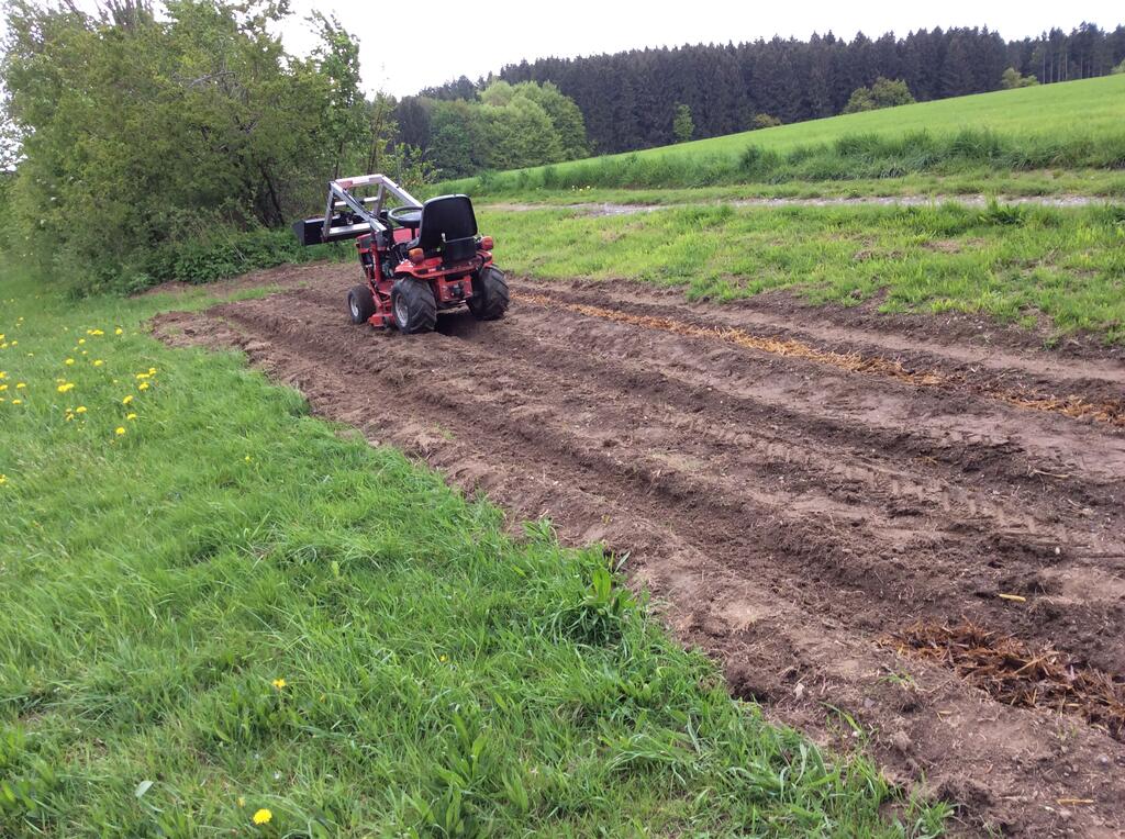

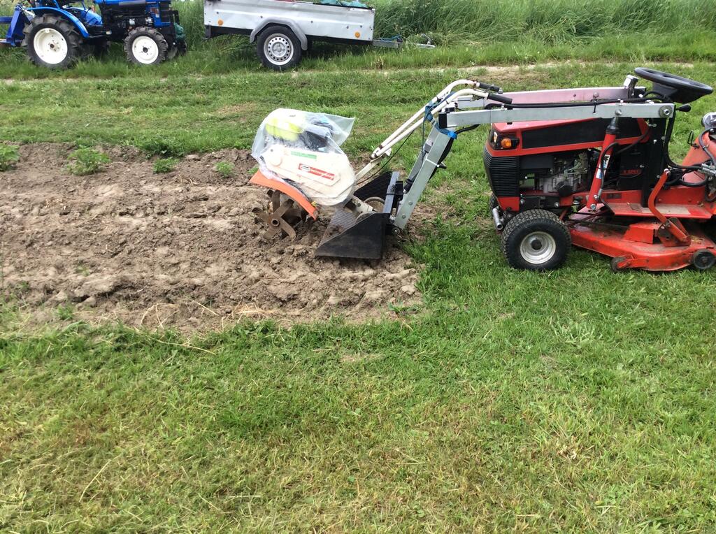

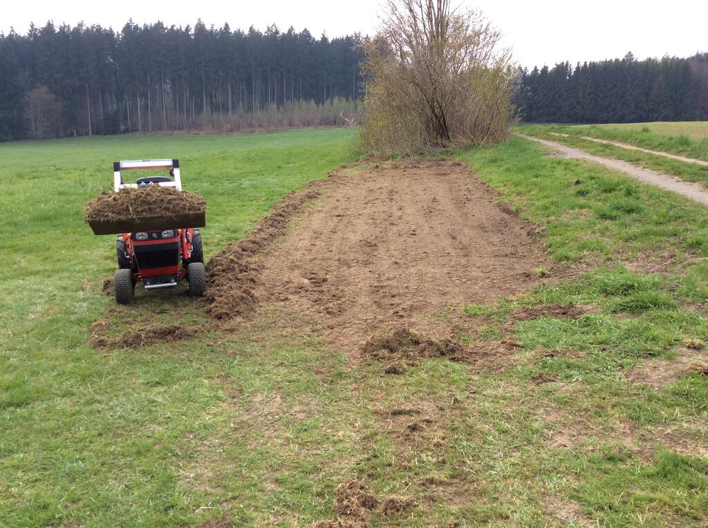

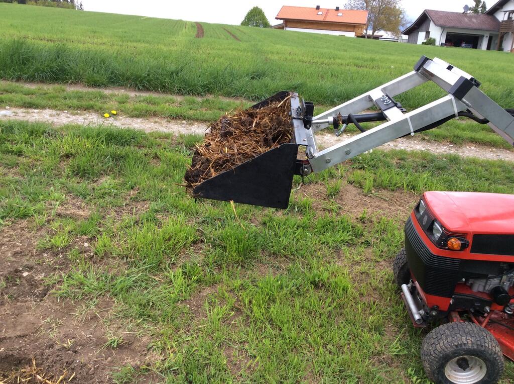

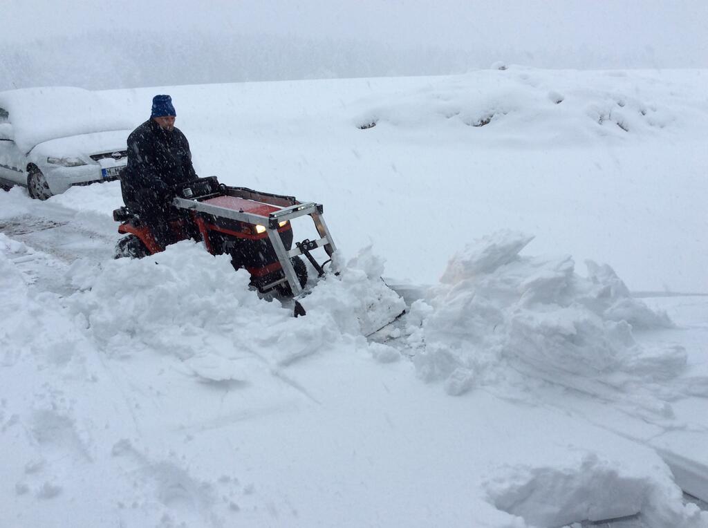

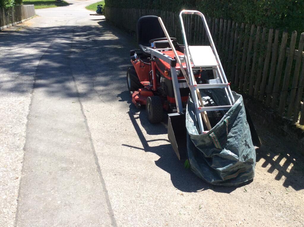

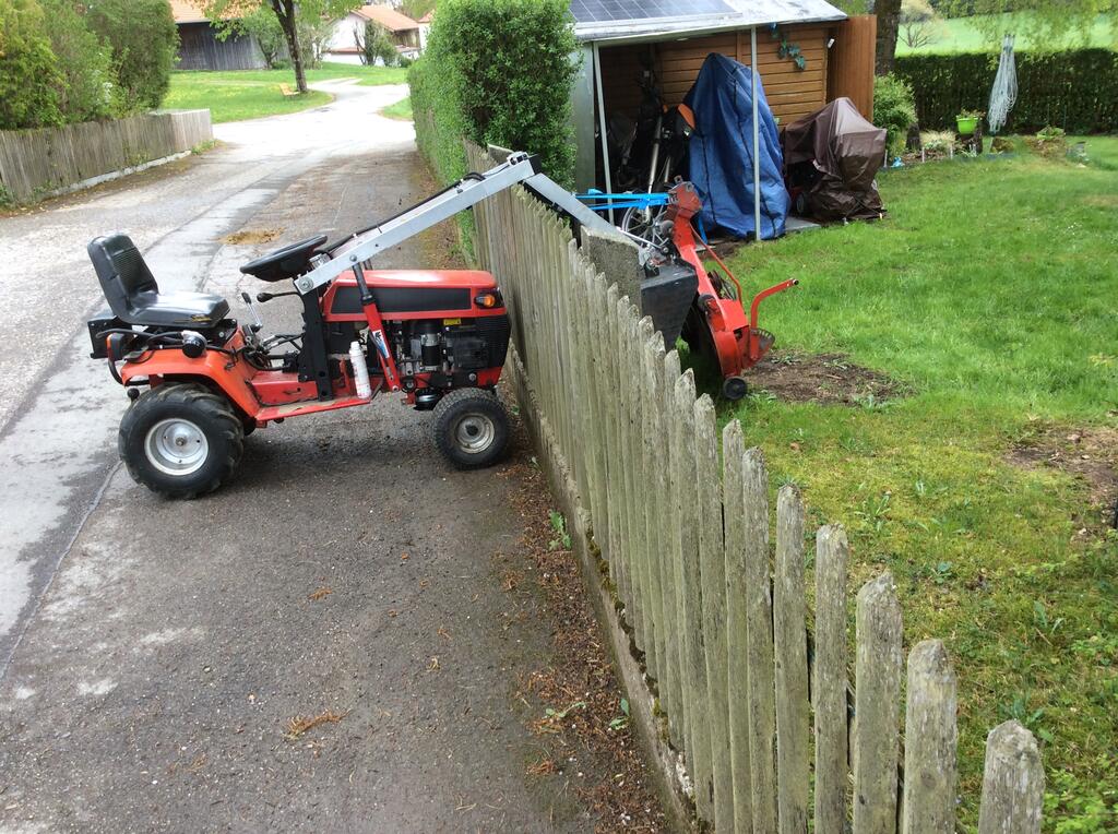

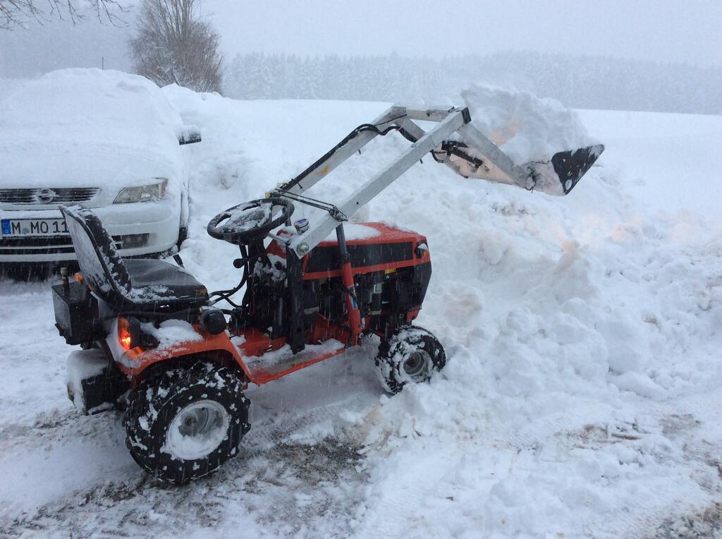

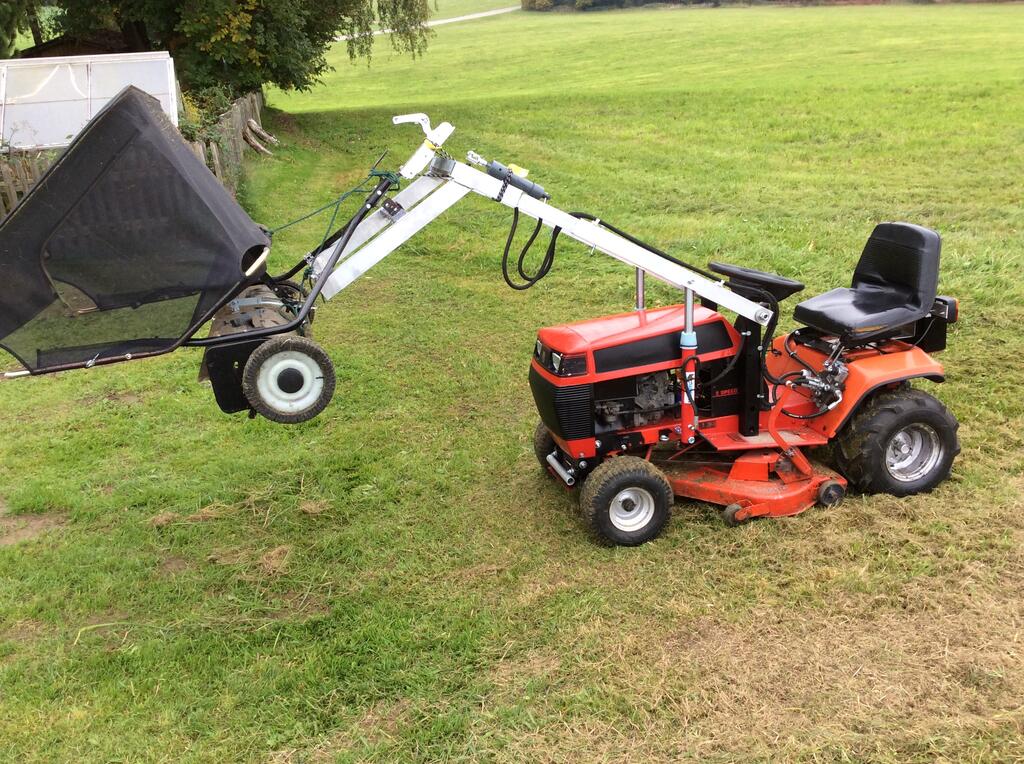

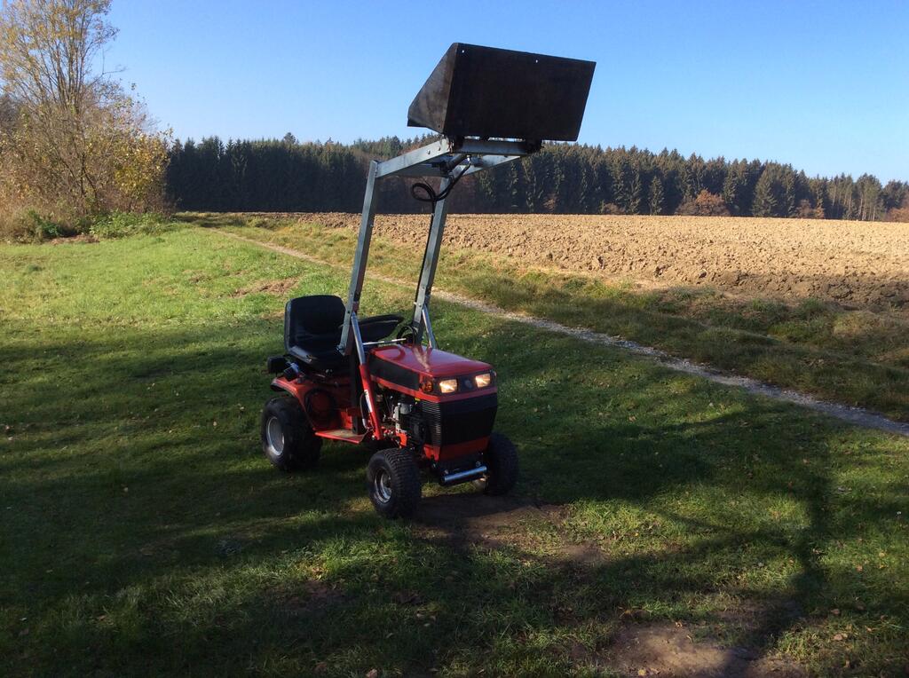

Tractorhead 9,217 #9 Posted December 15, 2020 Let me say it with pictures.. I using my vertical 212 for a lot more tasks, it ever be designed or made for. Firstly i built an FEL made of Aircraft Aluminum. in second step i increased the lift height up to over 2 meters. A ride with load in that height can tilt you and your Tractor very quickly, so you have to be carefully of what you do. The FEL was a massive helper, i enjoyed on several Tasks... i.eg lift the Mowerdeck Doing some Fieldwork.. Servicing my Equippment Prepare the little Field for the first Time... and even in Winterjobs.. It surprises me allway’s with it‘s flexibility and durability, no doubt about. It worked like a champ several times, without my first vertical horse i had little more problems in January 2019 to fight the massive Snow we had. The Gearbox lasts, all my doings but the front axle wears little faster than i hoped. That was my reason to release the 212 with the hardcore FEL Jobs to another bigger Machine. The gearbox wasn‘t my problem at all, but i don‘t rape it hardly. The maximum load i give it, was my own Weigh, + a 38 Kilo Battery and in Winter chains. In summer it works just on it’s own weight plus a counterweight double the Bucket weight of the FEL. The Battery can be seen in the first Snowpict behind the Rear axle. The Tranny annoy‘s me, because the reverese gear was just as fast as the 3 forward.( 5 speed) That was not enough for a quick moving and too slow for me to work efficiently on short Way‘s Snowplow. As long as the Tranny doesn’t block, it seems to last, but it can be also differently on your‘s. I did all this Tasks with carefully moving, to not to destroy the I‘m sure a full block on the Rear axle can crack the Gearbox definitely. But at least, it definitely my Vertical was able to do much more than i ever could believe or imagine, even lot of guy’s told me - it‘s just a Mower. That is also a reason i keep it after purchasing my 656, because it‘s one of my Horses. However, this Gearboxes can not be compared to any Unidrives from the Horizontal machines. 1 1 Share this post Link to post Share on other sites
