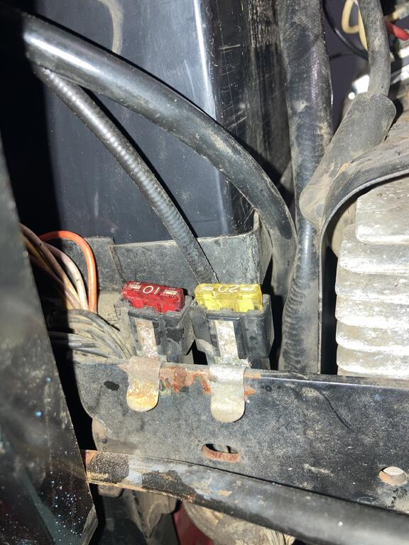

WH08205 15 #66 Posted March 5, 2021 Here are the fuses I was speaking about, only 2, not a block. Next to pto switch. engine connector meaning 9 pin? Share this post Link to post Share on other sites
lynnmor 9,005 #67 Posted March 5, 2021 Since you said "fuse box" I thought that you may have the troublesome fuse block, what you have should be simple to check. Yes, the 9 pin connector needs to be checked thoroughly. Ignition switches are available at places like NAPA, be aware that there are several different types that all look the same. Share this post Link to post Share on other sites
WH08205 15 #68 Posted March 5, 2021 Fuses test fine. Will check the holders next. located the 9 pin, will test that too. found a 5 pin, 3 position ignition at Lowe’s. Share this post Link to post Share on other sites
