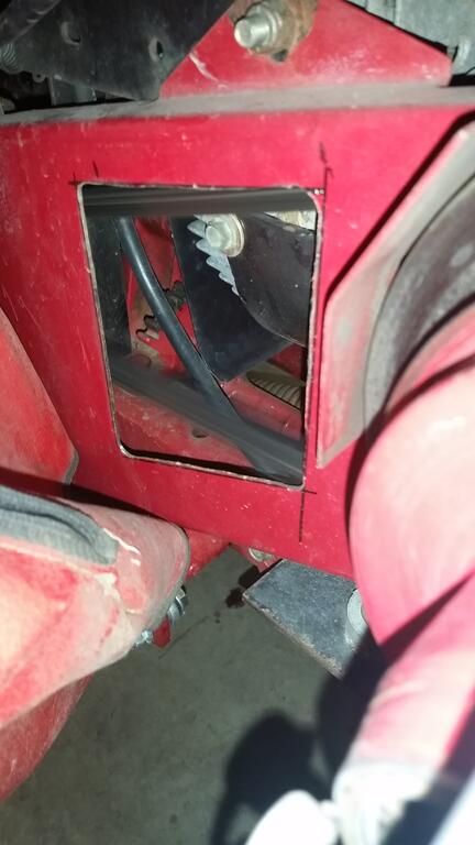

Bill D 3,090 #41 Posted December 15, 2020 If you're interested in a major modification for better cooling consider a remote oil filter kit. There was one on eBay awhile back. It was for a B43/48 but I believe it will fit the P220 as well. This would greatly increase air flow across the rear cylinder, give you a chance to clean the rear cylinder cooling fins during the install, and prevent further oily buildup on the rear cylinder from future oil changes. Not sure where you can mount the oil filter though. Bill 1 Share this post Link to post Share on other sites
oliver2-44 11,694 #42 Posted December 15, 2020 I don't own a 520, but I've read where many ventilate the belt guard to improve air flow to the rear cylinder. I've seen pictures on here of vertical slots and rows of holes. Maybe some of the 520 owners can comment on this modification. 2 1 Share this post Link to post Share on other sites
WHX?? 57,753 #43 Posted December 15, 2020 (edited) I have three 520's, four with a parts 520, and while they have their quirks are a great tractor. I have them all set up for snow duty but should set one up for mowing. Well I got three mowers and a z turn so maybe not! May have been mentioned before but the some of the quirks are the fuse block getting dirty and heating up due to corrosion and the nine pin connector to the engine. On ventilating the belt guard this is what I did. Was always going to put some hardware cloth over it but never got around to it. Edited December 15, 2020 by WHX24 manners 2 Share this post Link to post Share on other sites
WH08205 15 #44 Posted December 15, 2020 Thanks for that imagine. I am interested in doing a similar mod of some sort. Do you have a photo zoomed out more? Any others do this or similar and have photos? Would be nice to have some ideas. Share this post Link to post Share on other sites
ebinmaine 80,260 #45 Posted December 15, 2020 5 hours ago, WH08205 said: Thanks for that imagine. I am interested in doing a similar mod of some sort. Do you have a photo zoomed out more? Any others do this or similar and have photos? Would be nice to have some ideas. @WHX24 Share this post Link to post Share on other sites
WHX?? 57,753 #46 Posted December 15, 2020 (edited) Yah lots of other guys here did it. 520 vented belt guard - Restorations, Modifications, & Customizations - RedSquare Wheel Horse Forum 520 Belt Guard - Wheel Horse Tractors - RedSquare Wheel Horse Forum Probably a lot more 6 hours ago, WH08205 said: Do you have a photo zoomed out more? No in fact with the cab on now it blocks most of it off but that's how it heats the cab. The best mod you can do to a 520 is one of Matt's pedal kits. Moves the motion lever to the foot. Complete Pedal Kits for Hydrostatic Wheelhorse / Toro Tractors - Matt's Custom Hydro Pedal Kit - RedSquare Wheel Horse Forum Edited December 15, 2020 by WHX24 Share this post Link to post Share on other sites
Lee1977 7,750 #47 Posted December 15, 2020 As the belt guard on a hydro is just that a guard it's not need to operate a clutch like an 8 speed. I just removed the front section. I ran it all summer the first year I got it with the belt guard off. Share this post Link to post Share on other sites

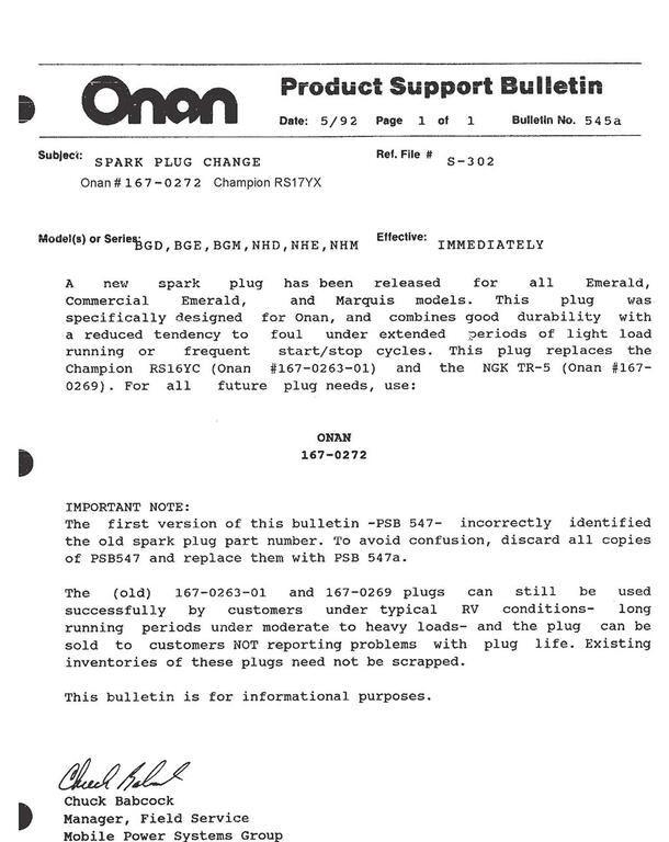

onanparts.com 185 #48 Posted December 16, 2020 (edited) On 12/14/2020 at 9:09 AM, gwest_ca said: I see a NGK item 2223 also so this warrants more research. Garry Original plugs in the early P series Onan's was the Champion RS14YC. Crossed to NGK 2238/TR5. Onan changed over to the Champion RS17YX. Crossed to NGK TR4. Issues with plug fouling caused them to go with a hotter plug. NGK 3754/TR4 is the correct plug for Horse's with P216, P218 & P220 engines. The TR5 is ok if you run your horse under heavy loads all the time. If you run it light, heavy and everything in between, TR4 is the way to go. It's the all around plug. Attaching Onan Factory PSB concerning the issue. The gensets they refer to use the P218 and P224 engines, so info is applicable. From the "Horse's Mouth".....:) Edited December 16, 2020 by onanparts.com 2 Share this post Link to post Share on other sites
WH08205 15 #49 Posted December 16, 2020 16 hours ago, onanparts.com said: Original plugs in the early P series Onan's was the Champion RS14YC. Crossed to NGK 2238/TR5. Onan changed over to the Champion RS17YX. Crossed to NGK TR4. Issues with plug fouling caused them to go with a hotter plug. NGK 3754/TR4 is the correct plug for Horse's with P216, P218 & P220 engines. The TR5 is ok if you run your horse under heavy loads all the time. If you run it light, heavy and everything in between, TR4 is the way to go. It's the all around plug. Attaching Onan Factory PSB concerning the issue. The gensets they refer to use the P218 and P224 engines, so info is applicable. From the "Horse's Mouth".....:) Thank you! I returned the TR5's for TR4's Share this post Link to post Share on other sites
WH08205 15 #50 Posted December 16, 2020 19 hours ago, Lee1977 said: As the belt guard on a hydro is just that a guard it's not need to operate a clutch like an 8 speed. I just removed the front section. I ran it all summer the first year I got it with the belt guard off. This sure looks like the simplest method without making permanent modifications to the guard. You mentioned 1st summer, have you since modified and reinstalled? 1 Share this post Link to post Share on other sites
