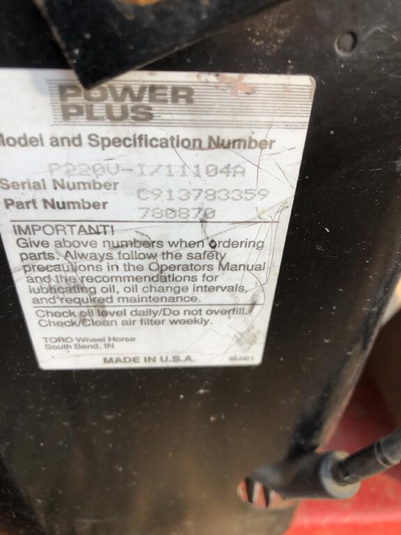

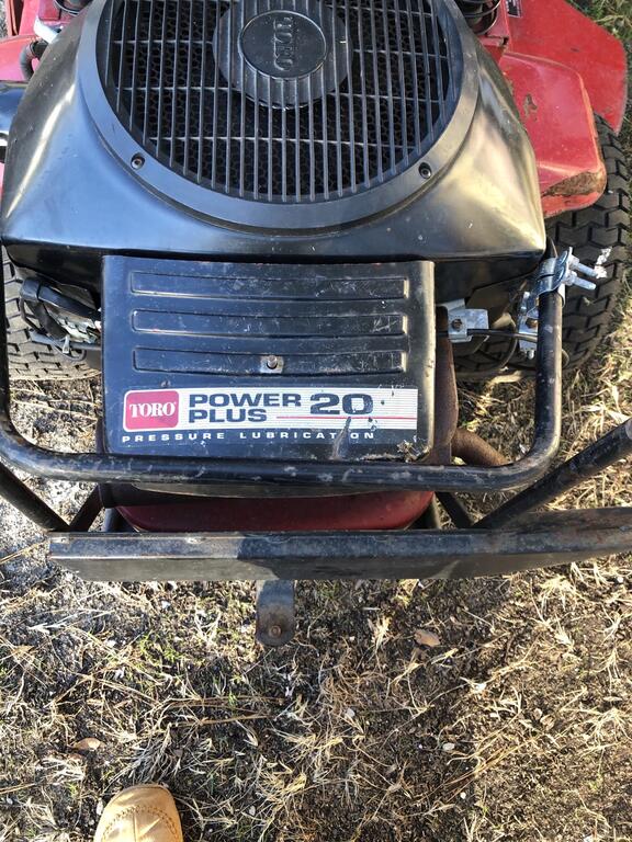

brian620z 0 #1 Posted December 13, 2020 Hello. I am new here and hope someone can help me. I have a Toro 620Z Wheel horse and I need to replace my motor. I had someone who said he was knowledgeable on fixing mowers work on mine and he said he blew a rod and that engine needs to be replaced or rebuilt. I have been trying to find a replacement but had no luck. Can a toro mower use any kind of motor? Mine is a 20hp. I have seen other brands of 20hp or higher but was not sure if I can use them. Any help would be greatly appreciated. Share this post Link to post Share on other sites
