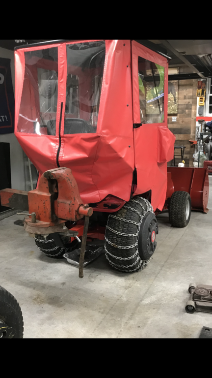

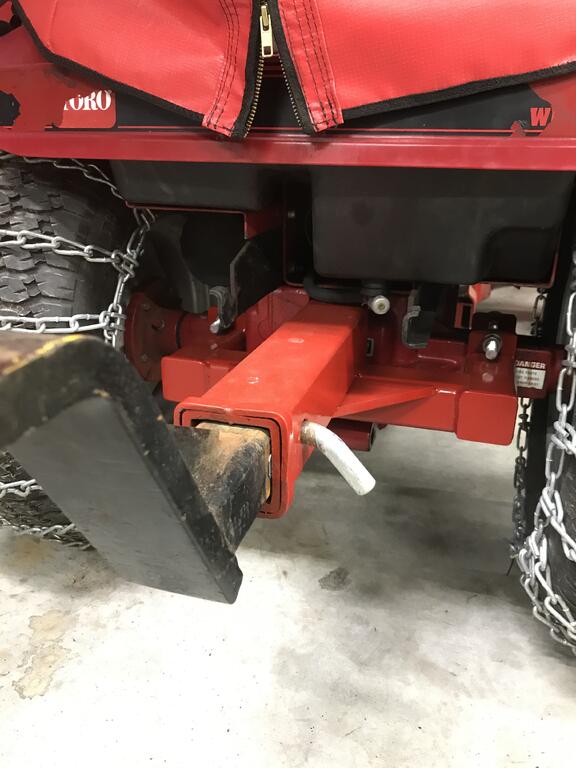

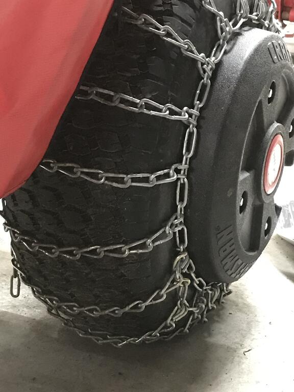

Randy Lindblad 71 #1 Posted December 13, 2020 (edited) Hello , I have 55 lb weights in wheels 44 blower out front , my question is how much weight can I hang off the rear on my 2 inch reciever I made without damaging axle seals or any other part I have a 180 lb vise I could use but don’t want to damage anything Edited December 13, 2020 by Randy Lindblad 1 Share this post Link to post Share on other sites

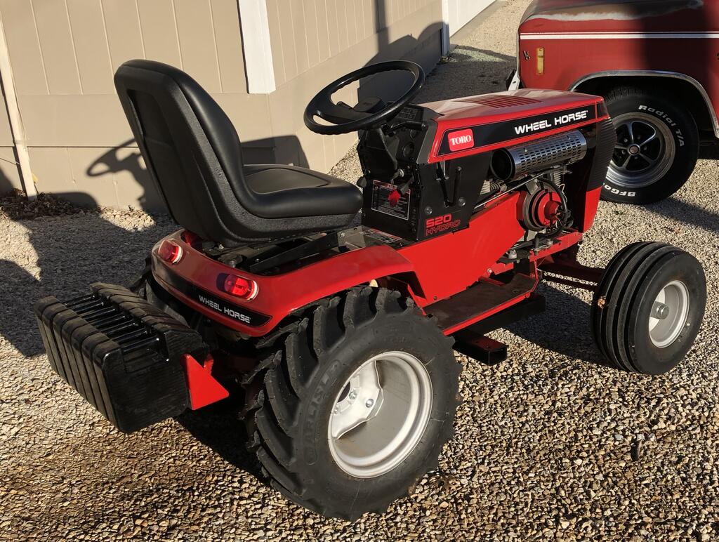

cschannuth 3,821 #2 Posted December 13, 2020 (edited) I have 7 - 42 pound suitcase weights. I’m probably pushing it but so far so good. I still plan to run supports from the weight bracket to my FEL sub frame to shore it up more. Edited December 13, 2020 by cschannuth Clarification 2 Share this post Link to post Share on other sites
953 nut 70,354 #3 Posted December 13, 2020 I would begin by filling the rear tires with RV Antifreeze, lots of weight where you need it, Weight hanging from the rear of the tractor shouldn't be a problem and it will improve your steering. My GT-14 with a FEL has about two hundred pounds of counterweight hanging from the three point hitch all the time. 1 Share this post Link to post Share on other sites
cschannuth 3,821 #4 Posted December 13, 2020 9 hours ago, Randy Lindblad said: Hello , I have 55 lb weights in wheels 44 blower out front , my question is how much weight can I hang off the rear on my 2 inch reciever I made without damaging axle seals or any other part I have a 180 lb vise I could use but don’t want to damage anything I agree with 953 nut. I have antifreeze in the tires and inside wheel weights as well along with my suitcase weights. All that plus me in the seat really keep it planted for my FEL. 1 Share this post Link to post Share on other sites
rjg854 13,422 #5 Posted December 13, 2020 That vise hanging out the back, sure likes it could put a great big dent in something 1 Share this post Link to post Share on other sites
squonk 48,339 #6 Posted December 13, 2020 9 minutes ago, rjg854 said: That vise hanging out the back, sure likes it could put a great big dent in something Like your shins and kneecaps! Share this post Link to post Share on other sites

ebinmaine 81,156 #8 Posted December 13, 2020 If you have a nicely compacted yard and denting the lawn isn't a concern I too highly recommend fluid filled tires. I have a local shop that installs Rimguard cheaper than I can even buy any other fluid. As to the rest weight I wouldn't even begin to question it until around 200lbs provided you have a good attachment point. My Cinnamon Horse runs around 1350 lbs total weight while in plowing mode. 1 Share this post Link to post Share on other sites
lynnmor 9,073 #9 Posted December 13, 2020 The weight box for a loader attaches to the sub-frame and places the cantilevered load directly above the wheel bearings. Putting considerable weight far behind the axles can torque the transaxle housing to the point of cracking. Ask me how I know. 1 Share this post Link to post Share on other sites
ebinmaine 81,156 #10 Posted December 13, 2020 15 minutes ago, lynnmor said: The weight box for a loader attaches to the sub-frame and places the cantilevered load directly above the wheel bearings. Putting considerable weight far behind the axles can torque the transaxle housing to the point of cracking. Ask me how I know. Valid points. Do you remember the specifics behind the cracking episode? Like how much weight? Rough ground? Whatever? Share this post Link to post Share on other sites
lynnmor 9,073 #11 Posted December 13, 2020 Just now, ebinmaine said: Valid points. Do you remember the specifics behind the cracking episode? Like how much weight? Rough ground? Whatever? I found a very slow leak and don't know exactly when or how it developed. After looking at the considerable distance between the bolts, I see why it happened. I had a box with perhaps 200 lbs. that attached to the draw bar and the axle housings, much like some aftermarket trailer hitches. 1 Share this post Link to post Share on other sites
ebinmaine 81,156 #12 Posted December 13, 2020 2 minutes ago, lynnmor said: I found a very slow leak and don't know exactly when or how it developed. After looking at the considerable distance between the bolts, I see why it happened. I had a box with perhaps 200 lbs. that attached to the draw bar and the axle housings, much like some aftermarket trailer hitches. Was this on a tractor you'd had for awhile or fairly new-to-you? I've seen one transmission that was broken because of a 3 foot drop off a truck bed. Share this post Link to post Share on other sites
lynnmor 9,073 #13 Posted December 13, 2020 Just now, ebinmaine said: Was this on a tractor you'd had for awhile or fairly new-to-you? I've seen one transmission that was broken because of a 3 foot drop off a truck bed. I bought the 520H new in 1991. I take care, but do work it to the max. 1 Share this post Link to post Share on other sites
lynnmor 9,073 #14 Posted December 13, 2020 The crack is located midway between the top and bottom bolts, think about that unsupported distance. 1 Share this post Link to post Share on other sites
