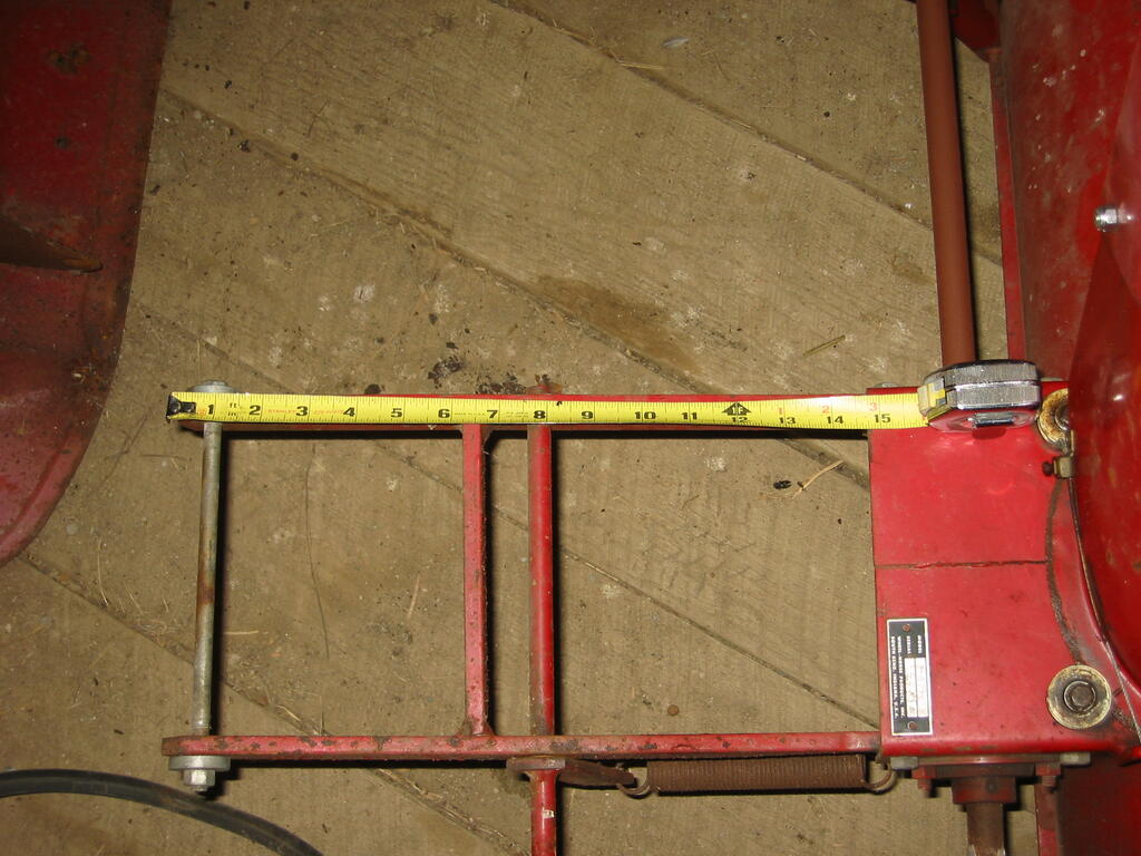

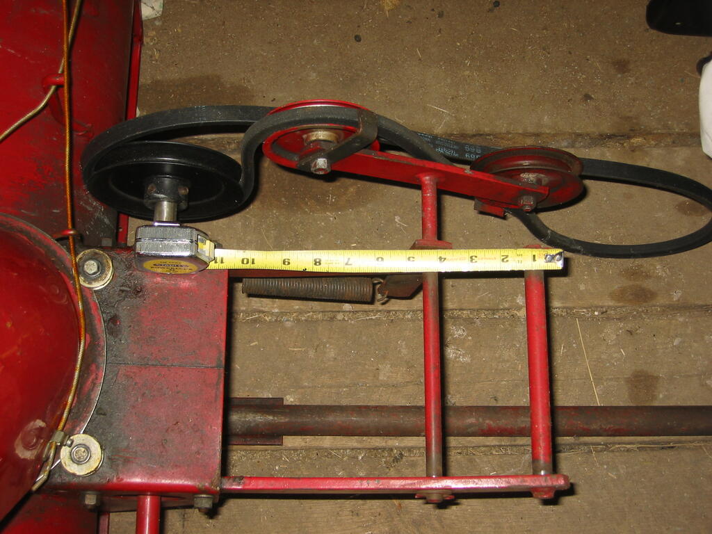

pfrederi 20,870 #3 Posted December 13, 2020 The difference is the mounting bracket. I think you just need the long bolt like in picture. Long frame is old style shorter is front tachmatic. Blower is the same. 1 Share this post Link to post Share on other sites
gwest_ca-(File Mod) 12,357 #4 Posted December 13, 2020 The bolt at the rear is 3/8" x 8-1/2". The hole in the frame is much larger so the bushings on the bolt above make the 3/8" bolt work. The drive belt for the STR-324 is 1/2" wide and the correct blower would use a 5/8" wide belt. Garry Share this post Link to post Share on other sites

haydendavid380 759 #6 Posted December 13, 2020 46 minutes ago, pfrederi said: The difference is the mounting bracket. I think you just need the long bolt like in picture. Long frame is old style shorter is front tachmatic. Blower is the same. It looks like the bracket is short but still has the bolt Share this post Link to post Share on other sites
pfrederi 20,870 #7 Posted December 13, 2020 1 hour ago, haydendavid380 said: It looks like the bracket is short but still has the bolt Measure it The solid bar in you pic looks like the old style Share this post Link to post Share on other sites
