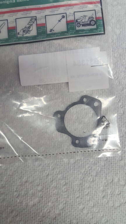

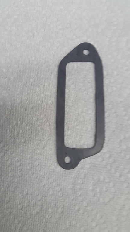

Gregor 4,847 #5 Posted December 13, 2020 For whatever reason, you don't get one of these. At least I didn't. It is the gasket between the carb and the air breather base. You have to order it separate I did get one of these, even though I don't know what it's for. About 5" long. 1 Share this post Link to post Share on other sites
squonk 44,866 #6 Posted December 13, 2020 That gasket is for the cover for where the cam gear cover. 1 Share this post Link to post Share on other sites

Howie 900 #10 Posted December 13, 2020 Gregor those gaskets are how you control the end gap on the side cover. That's why there is usually several of different thickness in the gasket kit. 1 Share this post Link to post Share on other sites
