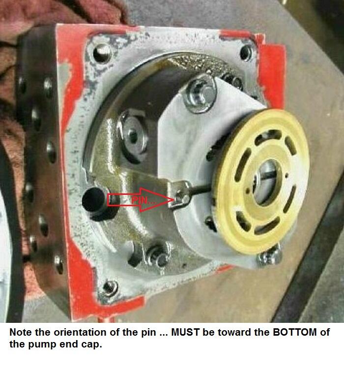

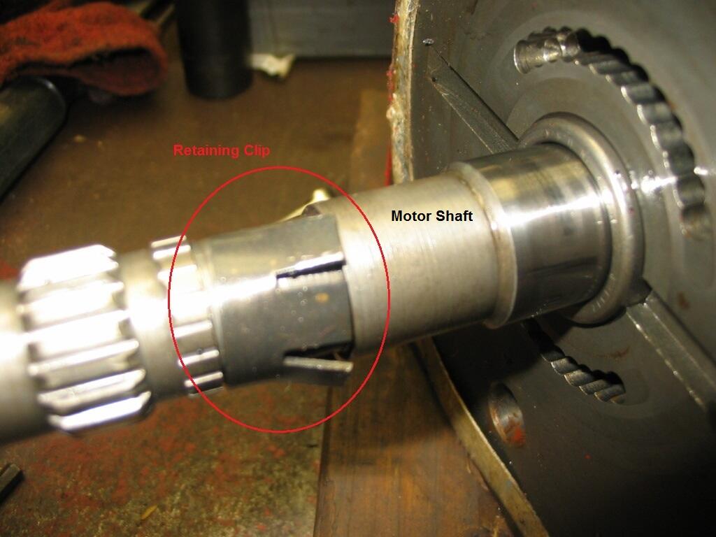

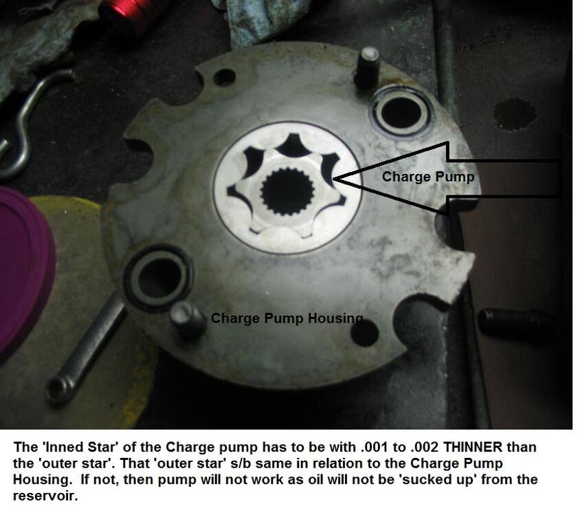

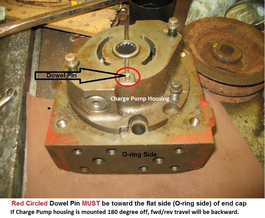

daveoman1966 3,881 #5 Posted December 13, 2020 A couple ideas come to mind: (1) The flow and pressure are created in the GEROTOR set on the backside of the Charge Pump Housing. These two parts (Gerotor set) set in a cavity of the Charge Pump housing and MUST be perfectly flat and smooth on both sides. If you machine the set down by .002, then the CAVITY must also be machined down by .002 to preclude oil bypass and pressure loss. (2)It is possible to mount the Charge Pump Housing 180 degree off, in which case, there would be no fwd or rev motion...not sure about lift pressure. Look at the PIN shown in this pic. (3) Did you use the correct OIL FILTER. Some after-market filters may spin on and seal ok, but the internals may not be to Wheelhorse specs. The correct filter is 79-5270 on for about $13. (4) Is the RETAINING CLIP on the MOTOR shaft in tact and positioned correctly on the shaft. 1 Share this post Link to post Share on other sites

Richard England 1 #8 Posted December 13, 2020 (edited) 10 hours ago, daveoman1966 said: A couple ideas come to mind: (1) The flow and pressure are created in the GEROTOR set on the backside of the Charge Pump Housing. These two parts (Gerotor set) set in a cavity of the Charge Pump housing and MUST be perfectly flat and smooth on both sides. If you machine the set down by .002, then the CAVITY must also be machined down by .002 to preclude oil bypass and pressure loss. (2)It is possible to mount the Charge Pump Housing 180 degree off, in which case, there would be no fwd or rev motion...not sure about lift pressure. Look at the PIN shown in this pic. (3) Did you use the correct OIL FILTER. Some after-market filters may spin on and seal ok, but the internals may not be to Wheelhorse specs. The correct filter is 79-5270 on for about $13. (4) Is the RETAINING CLIP on the MOTOR shaft in tact and positioned correctly on the shaft. (1) I will need to bust out the measuring tool for that. Do you know of any measurements that are not in the manual that I should check? (2) It was working before, but I will take notice of it when I reassemble it. (3) I use the one pictured for my D160 and my D200. (4) It was correct when I took it apart. On that note, I watched 4 video's from "CarterCreekFarm" on youtube about the motor. When he resembles the "slipper body"(see pic) he installs the spring in it and retains it with a "round spring clip" (see pic) My round spring clip was on the shaft. I really don't want to reassemble it just to find out it's still not working and I still don't know what part needs to be replaced. Right now it's the pump or motor. Edited December 13, 2020 by Richard England Share this post Link to post Share on other sites

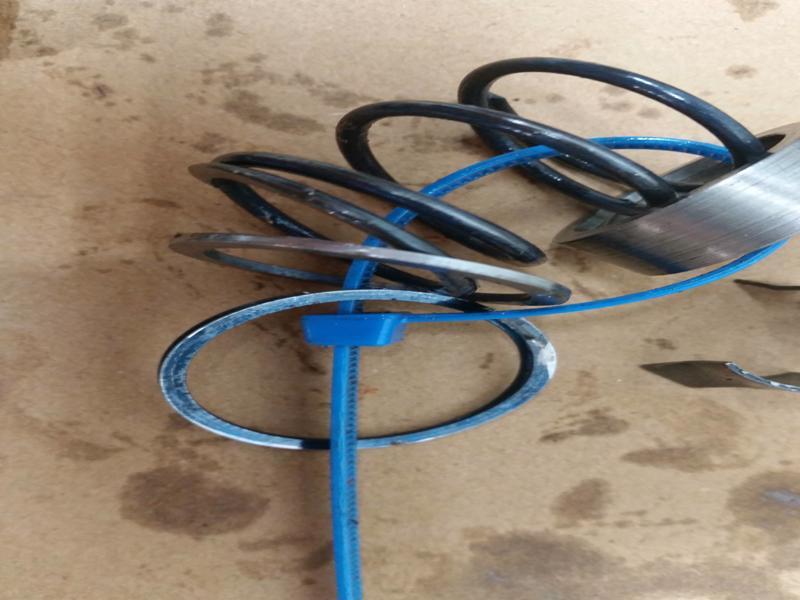

Richard England 1 #10 Posted December 13, 2020 2 hours ago, pfrederi said: If it worked after you replaced the O rings but then suddenly failed are you sure your relief valves and springs are OK both charge and implement??? if one is stuck open or the spring has failed charge pump would move fluid but it wouldn't build up pressure.... I should have checked them before i pulled the pump. I did put pressure gauges on the reliefs hoses on the motor and they read zero. I could have used a flow meter, but did not want to spend the money. When I disassembled them every thing looks clean (scratches/dirt). The only thing I found is that the spiral lock ring was not in the cylinder block. Now it might have popped out during disassembling or that may be the problem because it's mentioned in supplement 2 as a common issue. Share this post Link to post Share on other sites

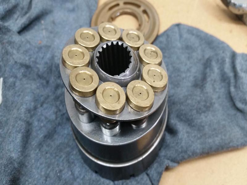

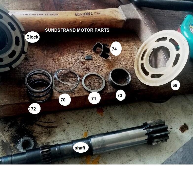

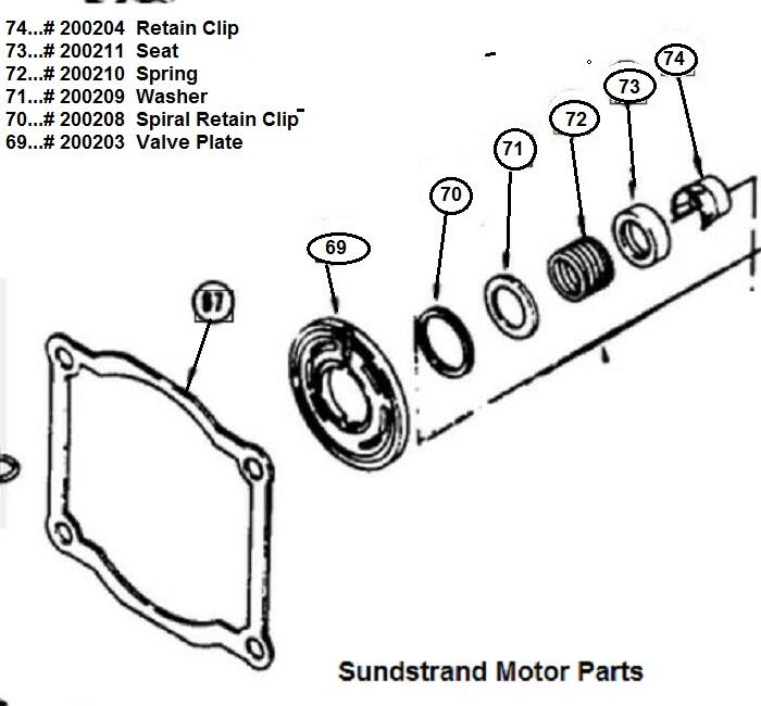

daveoman1966 3,881 #11 Posted December 14, 2020 YOUR COMMENT: On that note, I watched 4 video's from "CarterCreekFarm" on youtube about the motor. When he resembles the "slipper body"(see pic) he installs the spring in it and retains it with a "round spring clip" (see pic) My round spring clip was on the shaft If your Spiral Retaining Ring (# 200208) (your "round spring clip") was just laying loose on the shaft, then THAT very likely would be yor problem. That Spiral ring can be had new for about $10. It is the ONLY thing maintaining spring TENSION of the CYLINDER BLOCK (your 'slipper body') and 9 Pistons against the Valve plate. If it is twisted or damaged in any way, it'll fail. The sequence is: Spiral Ring (200208), Washer(200209), Spring (200210). From the pic, your WASHER looks ok. If you need a NEW SPRING # 200210, they are NLA, but I have 3 of them available. These pics may help: NOTE.. I also have 3 of the RETAINING CLIP # 200204 available...new and NLA from Toro W/horse. I can also order the correct oil filter 79-5270 if prepaid by you. NOTE 2... In this color image, BOTH the SPIRAL RET RING (70) and the RETAINING CLIP (74) are JUNK...twisted and broken. My direct email is: daveoman@windstream.net Share this post Link to post Share on other sites

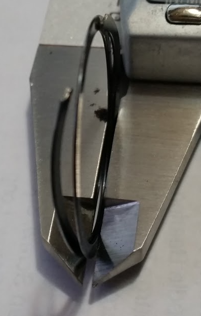

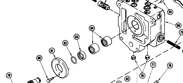

Richard England 1 #12 Posted December 14, 2020 (edited) @daveoman1966 This is a better angle of my spiral retaining ring. I ordered a new one from mcmaster. It looks to be the correct size. Spiral Internal Retaining Rings for 1-1/8" ID, 1060-1090 Spring Steel 92602A160 I don't recall there being an o-ring #82 200205 when I took it apart. I did ordered one yesterday for a whopping $20, but now I don't see a need for it. #83 83-3800 has an internal o-ring that I don't think is replaceable. That one has some play to it, but does it matter? Edited December 14, 2020 by Richard England Share this post Link to post Share on other sites
daveoman1966 3,881 #13 Posted December 14, 2020 As stated before, this is a source for OEM parts...the 200205 o-Ring is $13.. not $20. The Spiral ring 200210 is $10. https://www.psep1.biz/arinet.asp?aribrand=TO#/s/TO//200205/1/ Share this post Link to post Share on other sites
