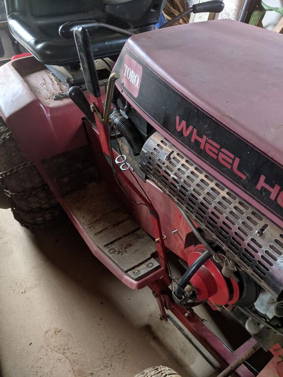

DAP 0 #6 Posted December 15, 2020 The plow seems to hook up, but the lever that shifts the plow to angle, the foot pad on the tractor is in the way. I don't if welding the bracket forward is the answer. Also the lift mechanism is a little different Share this post Link to post Share on other sites

1990Onan520-H 15 #8 Posted December 15, 2020 (edited) 3 hours ago, DAP said: The plow seems to hook up, but the lever that shifts the plow to angle, the foot pad on the tractor is in the way. I don't if welding the bracket forward is the answer. Also the lift mechanism is a little different Not sure if I have the same plow, but when hooking mine to my 416 I had to put two bends in my handle (straight handle) to clear my muffler, and there is a notch in the handle to clear the foot rest. Then used an old coat hanger to connect it to the release mechanism and added a few eyelets to hold it in place. Hope this helps. Trying to add a pic but for some reason can't at the moment. Could be my work computer blocking things. I'll keep trynig. Edited December 15, 2020 by 1990Onan520-H Share this post Link to post Share on other sites
