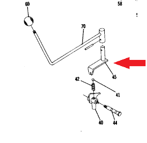

rmaynard 17,634 #8 Posted December 12, 2020 47 minutes ago, Jantastic said: I had to replace the input pulley so I know it’s not an issue... The pulley should be affixed to the shaft with a Woodruff key and a set-screw. Just sayin'.... It sounds to me like you may have a broken hi/lo shifter mechanism. It is a weak spot in those trannys. If it broke and you are in-between hi and lo, you will not go. Share this post Link to post Share on other sites

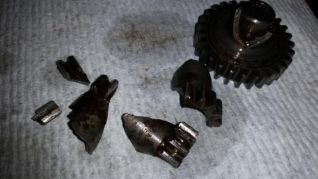

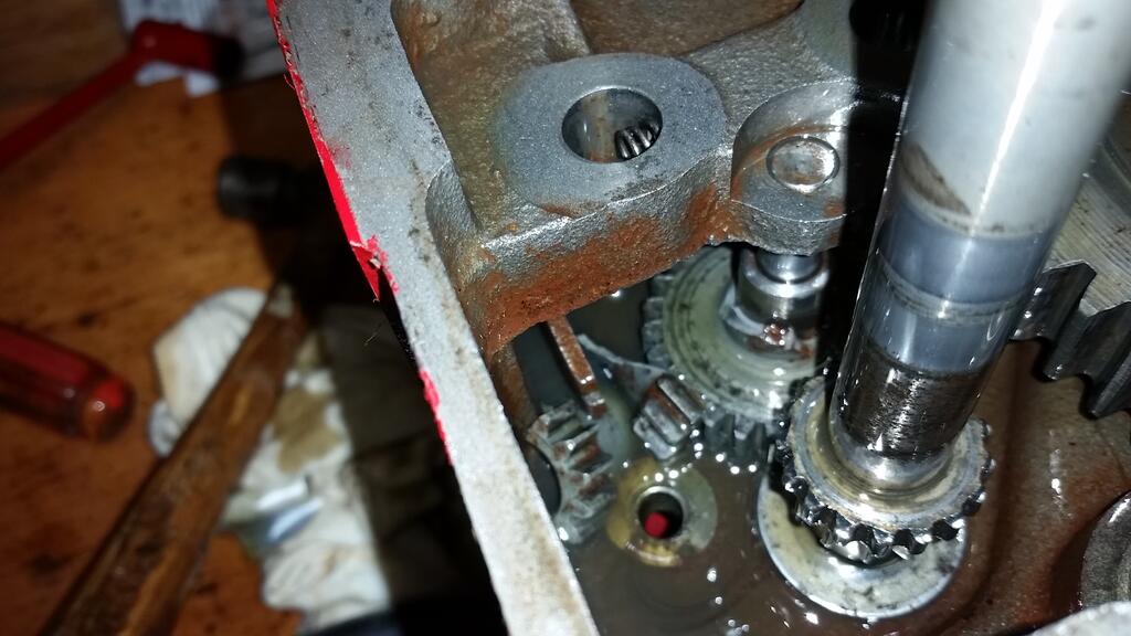

WHX?? 58,324 #10 Posted December 12, 2020 (edited) 50 minutes ago, rmaynard said: you may have a broken hi/lo shifter mechanism Kinda where I was going ... i have had it happen. That's a shattered hi/lo gear. Just for checking pull the shifter to inspect the ball on the end. I wouldn't put power to the tranny until i figure out whats goin on. Edited December 12, 2020 by WHX24 1 Share this post Link to post Share on other sites
stevasaurus 23,861 #11 Posted December 13, 2020 One way to verify a broken hi/low mechanism...put tractor into one of the forward gears. Now, with rear end on blocks, try to turn one of the tires in the forward direction. It will not be easy, you will be turning all of the inside gears from the opposite direction. Notice the brake shaft turning...now see if the input shaft is turning. If the input shaft is not turning, then your hi/low is either in neutral or the mechanism is broken. Time to open up transmission. Check out this thread. Share this post Link to post Share on other sites
