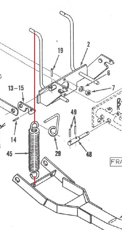

gwest_ca-(File Mod) 12,454 #3 Posted December 11, 2020 If you were to lift the dozer at the front of the tractor that would cut the speed in about 1/2 or 1/8" per second. To get an acutator to lift that weight that far it will be expensive and I question their durability for the occasional shock load the blade may see. Have you thought about using springs to assist? Some heavy front mounted snowthrowers use springs similar to garage door balance springs to assist and works well. Add a frame to the front quick hitch and hook springs to it. These springs come in different strengths. The snowthrower attaches to the front of the frame at the bottom. The rods mount to the fractor frame in front of the grill. The 29 handle is in the top spring hook and allows you to lift the spring to hook on the rod. In this application each spring is a good 80 pound lift to hook it on. Garry 1 Share this post Link to post Share on other sites
ebinmaine 80,288 #4 Posted December 11, 2020 17 minutes ago, gwest_ca said: using springs to assist This might sound like a silly question.... Am I correct in assuming that if one removes 80 lbs from the "felt weight" of a plow that you're also removing that from the down pressure at the blade? Share this post Link to post Share on other sites
gwest_ca-(File Mod) 12,454 #5 Posted December 11, 2020 Yes but you have transferred the weight to the front wheels. Garry 1 Share this post Link to post Share on other sites

DennisThornton 4,773 #7 Posted December 11, 2020 4 hours ago, ebinmaine said: This might sound like a silly question.... Am I correct in assuming that if one removes 80 lbs from the "felt weight" of a plow that you're also removing that from the down pressure at the blade? That's why I don't care for helper springs. Weight scrapes! 1 Share this post Link to post Share on other sites
