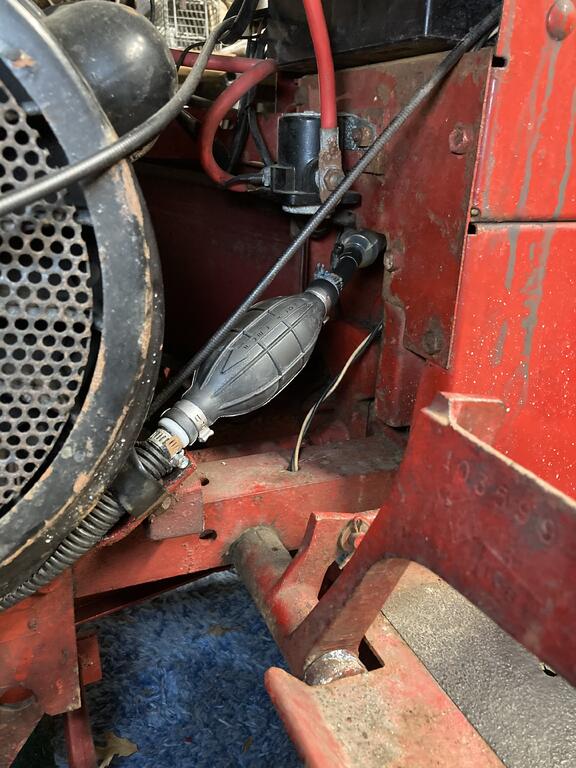

WheelhorseBob 1,550 #76 Posted December 15, 2020 312-8 and 310-8 both failed. Replaced with aftermarket due to cost, two of those failed. The ones I have now work but take forever to get fuel to the carb if the tractor sits. I’ve tried closing the fuel shut off’s etc. I think Kohlers should probably be converted to electric. I should say Kohlers with fuel tanks below ( under seat pan) carb level. 2 Share this post Link to post Share on other sites

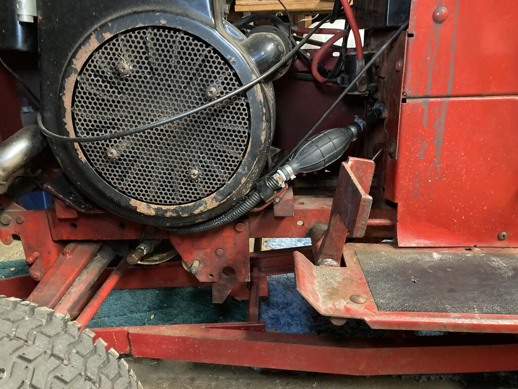

SylvanLakeWH 32,823 #77 Posted December 15, 2020 @WheelhorseBob maybe try a marine style in line primer bulb... works great, cheap and easy...! Here’s mine... 4 1 Share this post Link to post Share on other sites

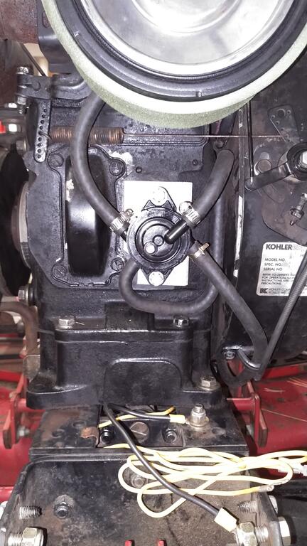

Bill D 3,193 #79 Posted December 15, 2020 56 minutes ago, WheelhorseBob said: My first horse had a 16 horse Briggs. It ran every time with no issues. Those opposed twin Briggs’s are great and foolish me sold it cause it wasn’t a real Wheel Horse, it was a Work Horse! Now I own Kohlers and Onans. Besides the absolutely junk Kohler fuel pumps I like them all. Consider something like this for a fuel pump. The pump in the picture is a Kawasaki. I would recommend the Briggs pump 808656. Works good. Bill 1 Share this post Link to post Share on other sites
ebinmaine 81,138 #80 Posted December 15, 2020 6 hours ago, Gregor said: "here are a couple of my all original horses" OK I know very little about Wheel Horse tractors. I'll be the first to admit it. Are those square headlights original? As a side note. If my C-141 doesn't start like it should next spring, I have an electric fuel pump on hand. Those lights are not original, no. I've got 4 of the primer bulbs on order. Need one for Cinnamon Horse for sure. They can be had for less than $5 each delivered. @WheelhorseBob that might be a solution too. Share this post Link to post Share on other sites
WheelhorseBob 1,550 #81 Posted December 16, 2020 23 hours ago, SylvanLakeWH said: @WheelhorseBob maybe try a marine style in line primer bulb... works great, cheap and easy...! Here’s mine... I love it when someone comes up with a KISS solution! It’s one of those “why didn’t I think of that” moments! 2 Share this post Link to post Share on other sites
