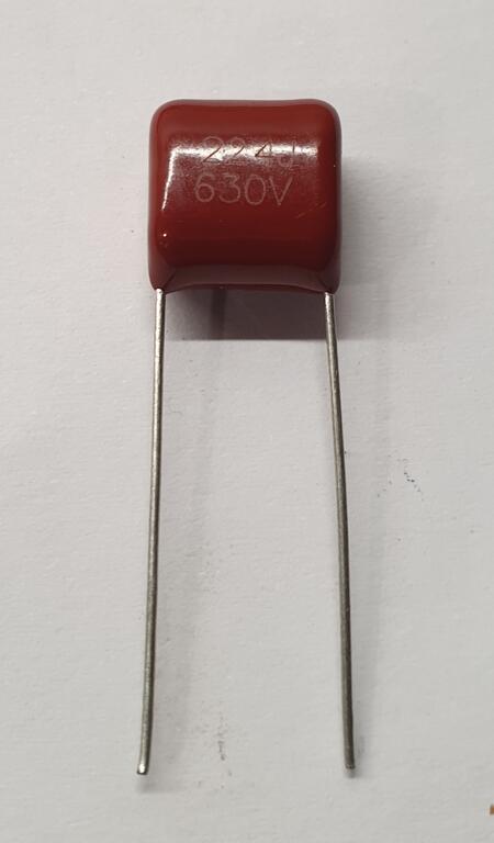

Mickwhitt 5,259 #1 Posted December 8, 2020 Hi all. Been looking at condenser matters for Fred since some of you mentioned a faulty condenser could cause all manner of problems. I learned how to test a condenser to see if its functioning. But that didn't show me the actual capacitance value for the condenser. So I bought a testing machine that can measure the value of a given capacitor. The condenser originally on Fred came in at 0.18 uF The one I bought from a motor spares shop came in at 0.20 uF Most websites with information on condensers relate to vintage cars and bikes, they state a value of 0.22uF is best for an ignition system. So I bought an electronic components capacitor with that value which I will trial on Fred to see how it runs and if it prevents points burning. Does anyone have any opinions, comments, suggestions about such a strategy? One guy even said he hollowed out old condenser cans and inserted a modern capacitor in it to look authentic. Mick 2 Share this post Link to post Share on other sites

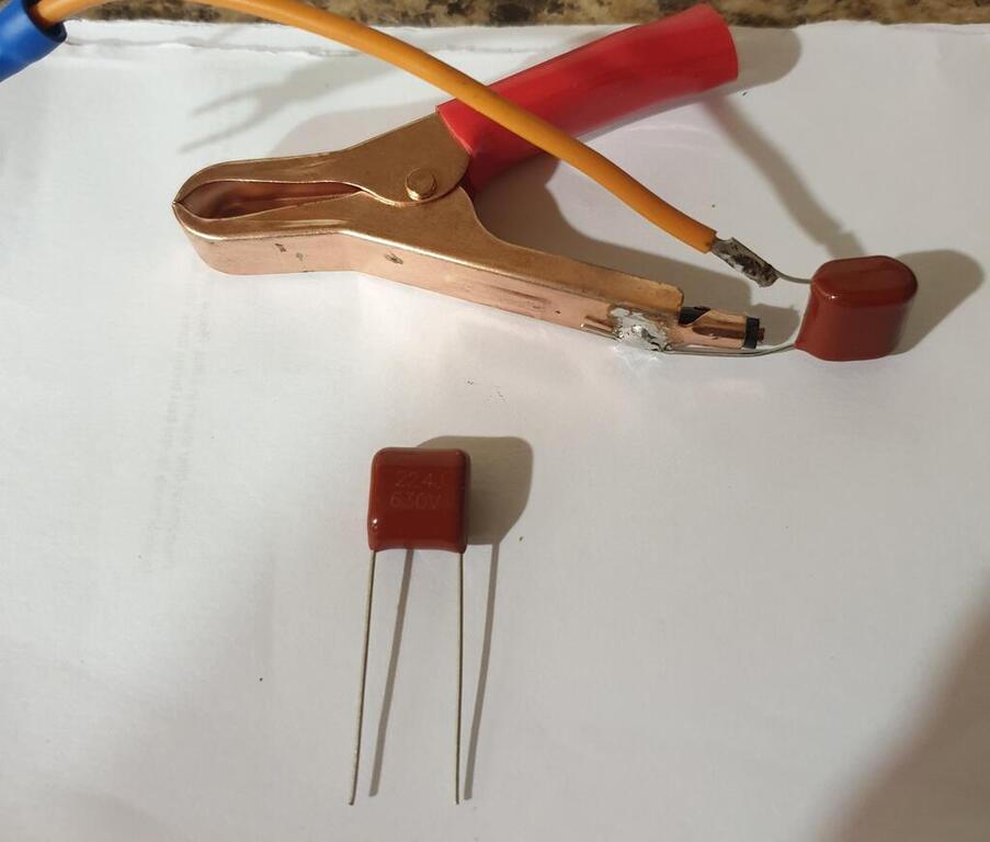

Mickwhitt 5,259 #8 Posted December 13, 2020 So. Today I soldered up a test wire to connect one of the new capacitors into Fred's ignition circuit. Effectively im able to swap between the existing condenser and the new capacitor. Running and warmed up I unplugged the condenser. Immediately the engine started to die so I plugged in the capacitor and it ran great, no discernable difference. So the theory works, this new fangled orange drop works just like a car condenser. Obviously its not very robust and I will make one up in a metal can which will make it tougher and easier to replace. At 8 pence each its way cheaper than a new condenser. Its rated at 630v so should be up to the job and its a 0.22uF capacitor. A nice metal box to house it will be knocked up on the milling machine and I can examine points burning to see if we are in the right value area. Mick 2 Share this post Link to post Share on other sites

Mickwhitt 5,259 #10 Posted December 14, 2020 Nut, yes I'm wondering the same thing. Im hoping that with a suitable case it will be protected from the environment. And that I will be able to swap a failed condenser fairly easily. Im imagining that the electronic component is no different to a condenser but im sure one of our electronic boffins will be able to comment. Mick Share this post Link to post Share on other sites
