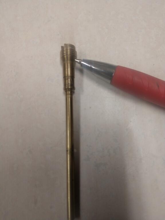

seven 202 #7 Posted December 8, 2020 50 minutes ago, gwest_ca said: Have had good luck applying Teflon pipe thread sealer on the tapered seat with a toothpick. Think it is a Permatex product. Garry Share this post Link to post Share on other sites
seven 202 #8 Posted December 8, 2020 Is this the area I would apply the teflon Share this post Link to post Share on other sites
gwest_ca-(File Mod) 12,371 #9 Posted December 8, 2020 Yes. It seals below the fuel level in the bowl. The holes in the tube are above the fuel level. I never applied sealer to the threads because installing it could allow some sealer to come off and interfere with the adjustment needle/jet I should have called the sealer a paste. Garry Share this post Link to post Share on other sites
seven 202 #10 Posted December 8, 2020 Ok thank you I will look at getting some teflon at auto parts store will let you know how it goes ☺️ Share this post Link to post Share on other sites
seven 202 #11 Posted December 8, 2020 1 hour ago, gwest_ca said: Yes. It seals below the fuel level in the bowl. The holes in the tube are above the fuel level. I never applied sealer to the threads because installing it could allow some sealer to come off and interfere with the adjustment needle/jet I should have called the sealer a paste. Garry Well I've come to the conclusion that my float needle (on original carb) was not seating like it should so that is fixed along with a tiny bit of teflon on tapered tube . Will see tomorrow if it all works out ☺️ 1 1 Share this post Link to post Share on other sites
