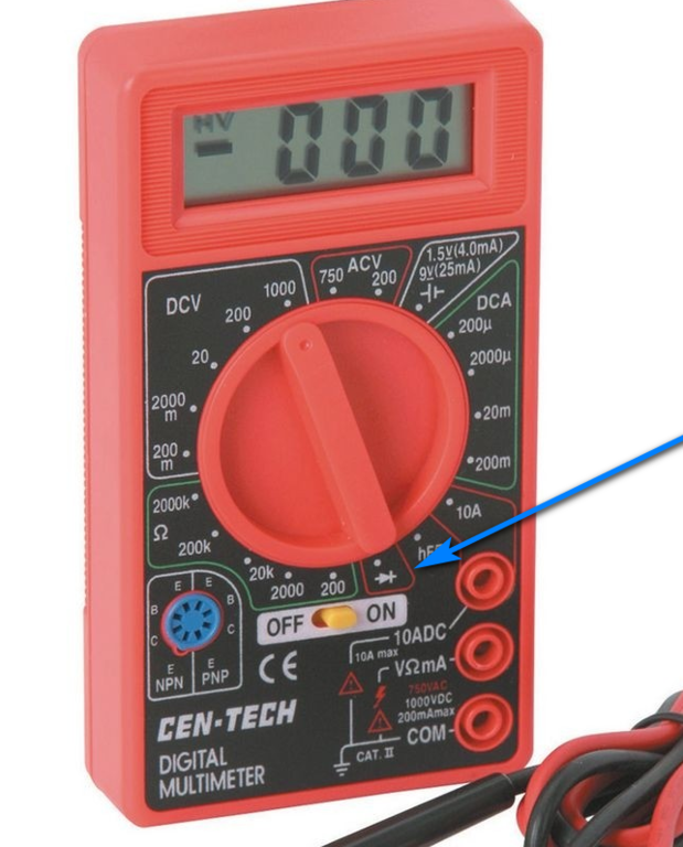

troutbum70 858 #29 Posted December 8, 2020 Does the walmart analog actually have a diode checker? The ability to generate signal to check current flow through the diode gate? Share this post Link to post Share on other sites
DennisThornton 4,773 #30 Posted December 8, 2020 7 minutes ago, troutbum63 said: Does the walmart analog actually have a diode checker? The ability to generate signal to check current flow through the diode gate? Even the cheap sometimes give-away Harbor Freight does: Share this post Link to post Share on other sites
troutbum70 858 #31 Posted December 8, 2020 Yes I have looked at those, but that is not an analog meter. There are analog meters out there like the simpsons and many others that have a diode checker, usually not found in the cheaper ones. I would have to rely on the fluke, unless it is having issues of its own. Share this post Link to post Share on other sites

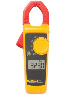

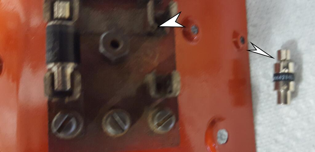

Gregor 4,847 #32 Posted December 8, 2020 My Fluke is not a high $ meter. I bought it mainly for the clamp on amp reading feature. It does not have a diode setting. Fortunately for me, the original diodes used on the Wheel Horse are still available. Also fortunate that Wheel Horse made the installation fool proof, as they will only go in one way. Hard to see in this photo, but there is a small groove in the top contact point in the diode. The top clip in the board also has a "spike" (I guess) to accept this groove. Share this post Link to post Share on other sites

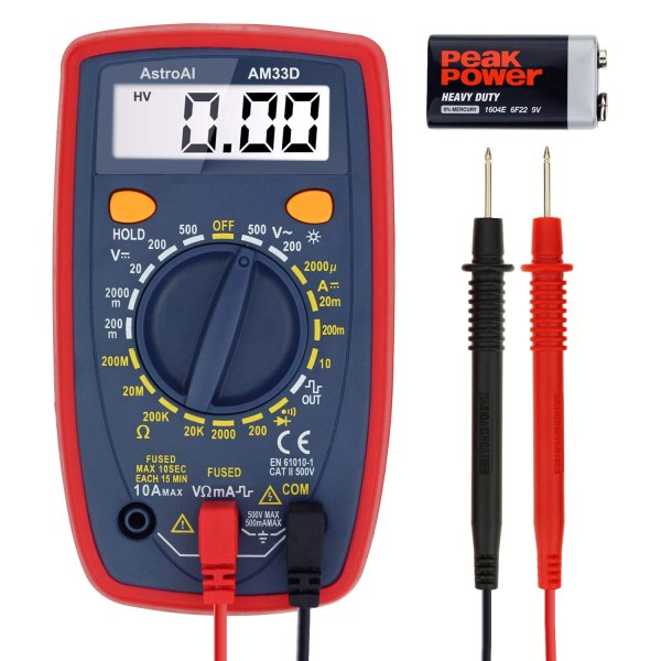

DennisThornton 4,773 #34 Posted December 8, 2020 8 minutes ago, Gregor said: Dennis. Is there a relatively cheap meter out there can can read very low ohms? I would like something to bench test coils ans stators. This can mean readings of as little as 1 or 2 ohms. Sometimes hard to read even on a 10 ohm scale with an analog meter. My digitals just jump around depending on how I ho;ld my mouth. I think we may need some clarification here. (hope I am right on this) An analog meter has a scale and a needle that swings across the scale. A digital meter gives a readings in numbers. I was NOT happy with the Harbor Freight and I didn't want to use my good meter everywhere so I bought a AstroAl AM3300 that I'm quite pleased with for low Ohms. 1 Share this post Link to post Share on other sites
Handy Don 16,049 #35 Posted December 8, 2020 11 minutes ago, Gregor said: Dennis. Is there a relatively cheap meter out there can can read very low ohms? I would like something to bench test coils ans stators. This can mean readings of as little as 1 or 2 ohms. Sometimes hard to read even on a 10 ohm scale with an analog meter. My digitals just jump around depending on how I ho;ld my mouth. I think we may need some clarification here. (hope I am right on this) An analog meter has a scale and a needle that swings across the scale. A digital meter gives a readings in numbers. Chiming in, Gregor. Your Fluke 323 can read down to 0.1 Ohms, with +/- .1 Ohm accuracy per the manual. It also has a "hold" button that lets you freeze the reading. Taking a few samples while holding your mouth in different positions will, hopefully, give you the info you need. Manual: https://dam-assets.fluke.com/s3fs-public/32x_____umeng0100.pdf 1 Share this post Link to post Share on other sites
Handy Don 16,049 #36 Posted December 8, 2020 7 minutes ago, DennisThornton said: AstroAl AM3300 This is a nice meter at a good price. The fixed Ω ranges are quite useful and less confusing than an auto-ranging meter. Share this post Link to post Share on other sites
DennisThornton 4,773 #37 Posted December 8, 2020 1 minute ago, Handy Don said: This is a nice meter at a good price. The fixed Ω ranges are quite useful and less confusing than an auto-ranging meter. Was the best bang for the buck I could find. Share this post Link to post Share on other sites
