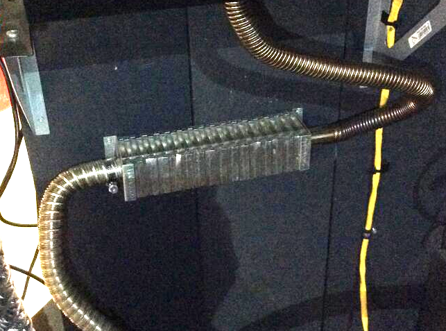

Wheel Horse 3D 3,825 #36 Posted March 19, 2021 On 12/8/2020 at 5:26 PM, DennisThornton said: Need to know a little more about this: I understand what you are doing but I've never seen one of these. How does it work? Exhaust cooler.. actually good idea, radiates some oth the exhaust heat off the fins there and keeps it in the room rather than sending that heat energy out the exhaust. 1 1 Share this post Link to post Share on other sites
