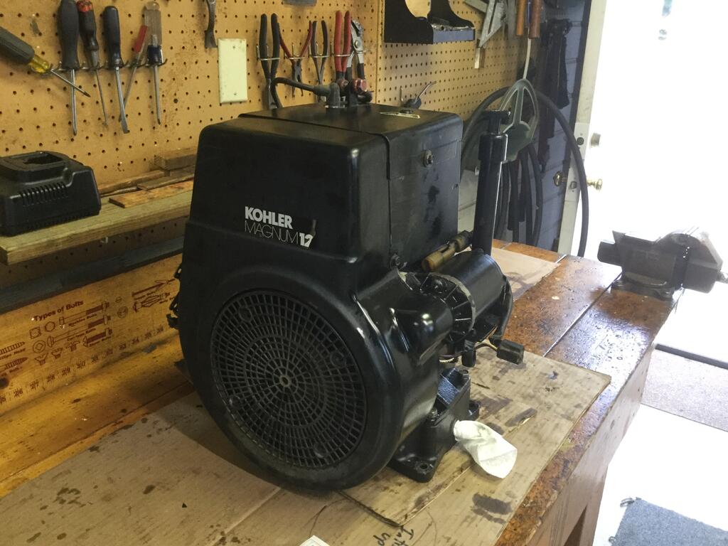

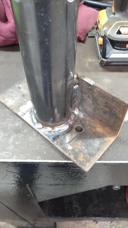

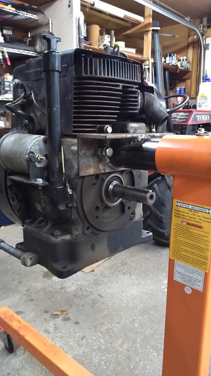

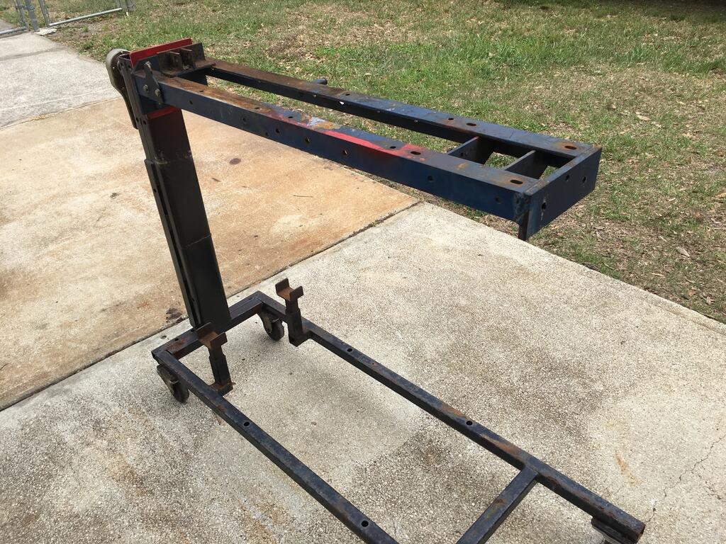

Bill D 2,599 #1 Posted December 7, 2020 I made this engine mount to fit an engine stand my neighbor loaned me. I have to pull the balance gears in this M16. It has a rattle that's making me nervous. I am curious how others mount their engines for repair. Thanks. Bill 6 4 Share this post Link to post Share on other sites

ebinmaine 77,360 #3 Posted December 7, 2020 Nice idea there. I've only had one engine apart and it's light weight. I put that on a small table for mobility. Share this post Link to post Share on other sites
Tractorhead 9,216 #4 Posted December 7, 2020 Like the idea, can be turned in each direction while rework. Great solution 👍 Share this post Link to post Share on other sites
peter lena 9,770 #5 Posted December 7, 2020 BILL D , I like the idea of that , think I would add more bolt support for the weight . like 2 vertical flat drilled steel downward , bars ,one on each side to pick up the other engine bolt flange holes . first thing I thought of was a weld pipe flange , about 4 - 6" size , might even bolt rite up . I don't weld any more but was always looking for anything premade that I could adapt to a problem , pete Share this post Link to post Share on other sites
richmondred01 2,333 #6 Posted December 7, 2020 (edited) That looks great. Most people use the starter mount to affix the stand bracket. However, the magnums don’t give the clearance you need for the bearing plate so your setup on the PTO side is nice for Magum rebuilds. Edited December 7, 2020 by richmondred01 1 Share this post Link to post Share on other sites

71_Bronco 1,072 #8 Posted December 7, 2020 I currently have a K181 on my bench. Once stripped of most of it's parts (muffler, carb, starter/generator, etc), it gets pretty light and can move around easily. However, that's where issues set in, specifically torqueing bolts (or loosening tight bots). Makes the engine want to slide across the bench. I can see how a stand may come in handy. 1 Share this post Link to post Share on other sites

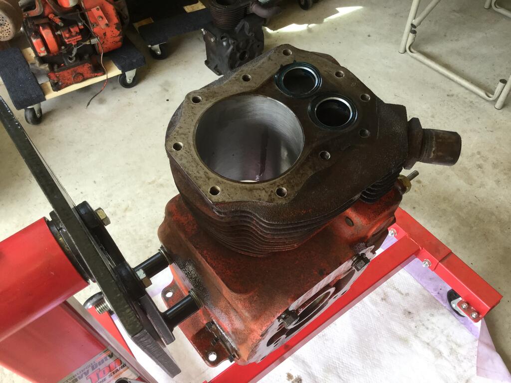

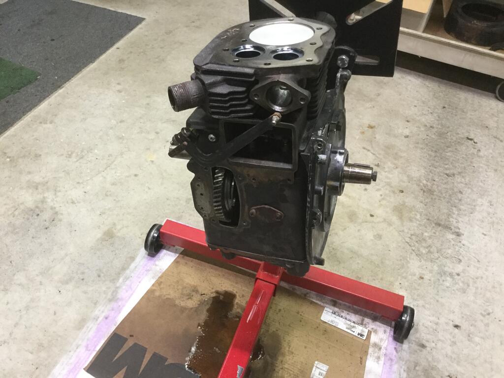

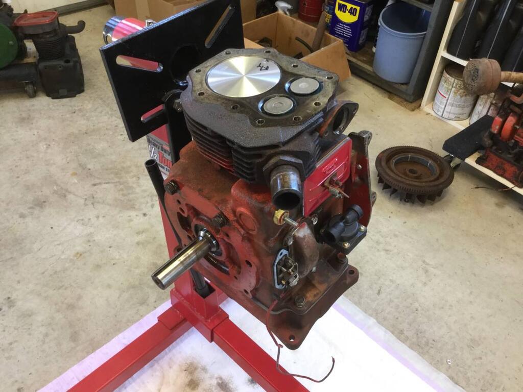

richmondred01 2,333 #9 Posted December 7, 2020 (edited) I only keep the engines on the stands until the pan is on. I do that because a dressed out k engine is a lot of weight for the two mounting bolts in the cast. I complete the rebuilds on the bench. Edited December 8, 2020 by richmondred01 5 Share this post Link to post Share on other sites
RJ Hamner 1,029 #10 Posted December 10, 2020 Mine is the same as @richmondred01 the only difference is mine folds up when not in use since I have limited space. BTW: Works GREAT! Share this post Link to post Share on other sites
