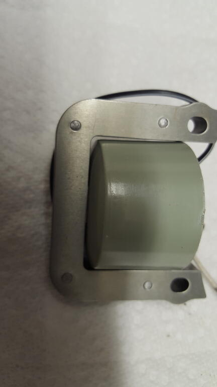

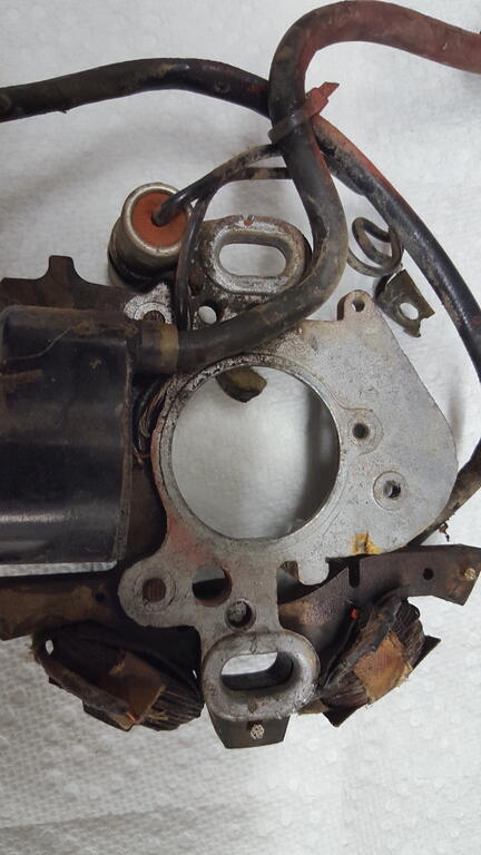

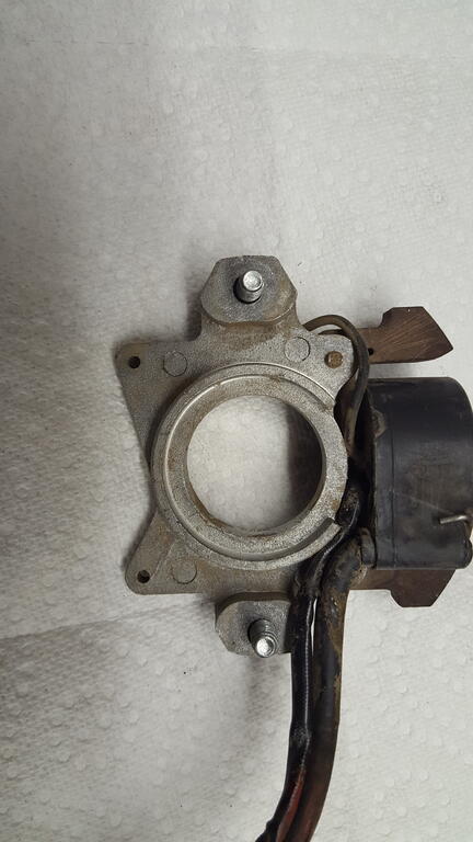

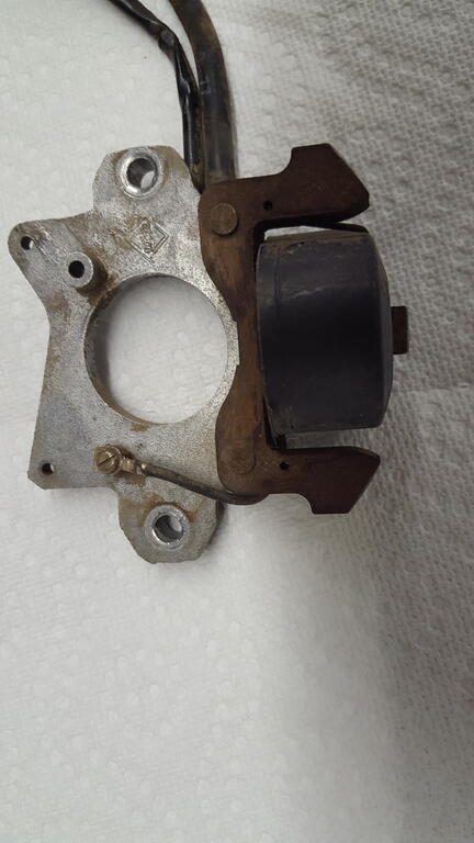

Gregor 4,848 #30 Posted December 9, 2020 I have yet another question about this K161. ( I know, I have lots of questions, sorry ) I have rebuilt a lot of small 2 strokes, and in each case. the coil mounting hole are slotted for adjustment. Here is a coil from a 2 stroke. The coil from my Tecumseh H70 also has slotted holes for timing adjustment. The coil for the Kohler K161 has simple holes. No room for adjustment. With the mounting bolts in, you can see how close the fit is. All the videos I have watched show the coil being rotated slightly, one way or the other for adjustment, but I have not found a video of this particular set up yet. I am never sure how the pics are going to load. I hope this all makes sense. Share this post Link to post Share on other sites

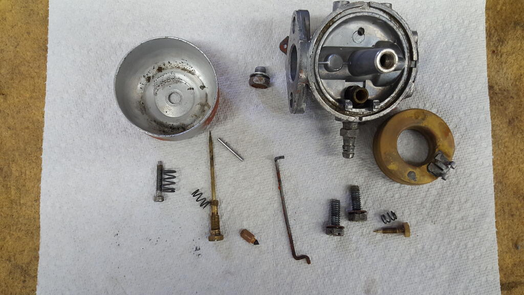

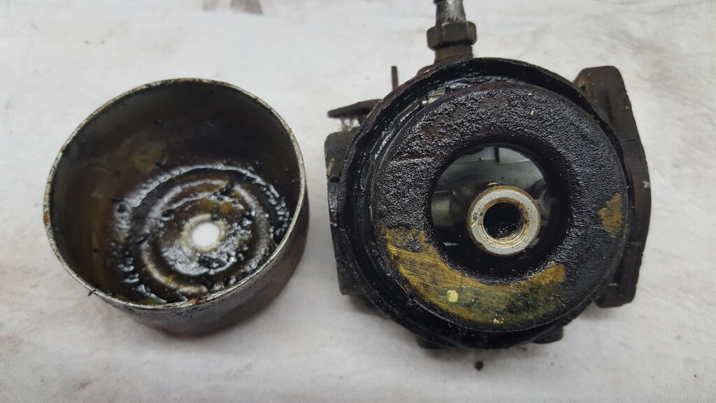

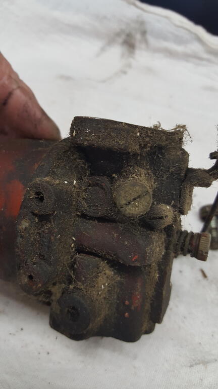

Gregor 4,848 #33 Posted December 10, 2020 On 12/6/2020 at 7:39 PM, oliver2-44 said: Unless there’s some thing significantly wrong with the Carb I would suggest giving it a good deep cleaning. Especially if you were considering an aftermarket Carb. I’ve bought 2 aftermarket. One works good and the other has no high speed adjustment no matter what I tried. I am trying to save the old carb, but I have my doubts. I put it in acetone, for 2 days with an occasional brushing, poking, scraping. Then I put it through a couple cycles of my ultra sonic cleaner with straight Simple Green. ( Don't know exactly why, but that sonic cleaner has a profound effect on my hearing aids. You think tinnitus is bad! ) It is cleaner anyway. The discoloration at the bottom of the bowl will not come out, even with a wire brush on my drill. Took some doing to get the float shaft out. I got a kit to rebuild it. Who knows, might work, might not. I have a new one on order, just in case. 2 Share this post Link to post Share on other sites

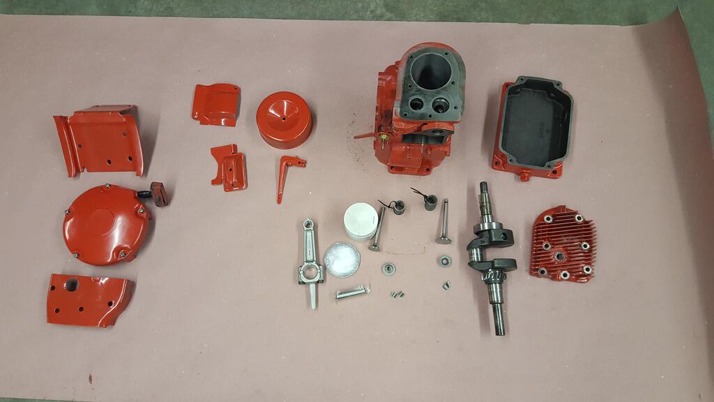

Gregor 4,848 #38 Posted December 13, 2020 I got stuff today. Lots of stuff. Do ya think I can turn all this into something that runs? Everything new inside except lifters, and bearings, cam and crank. I didn't want to remove the cam. I really don't have a good way to remove and replace the bearings, so I left them alone You put all this together and it gets a lot heavier anyway. Still waiting on the new carb, and some parts from A to Z 1 1 Share this post Link to post Share on other sites

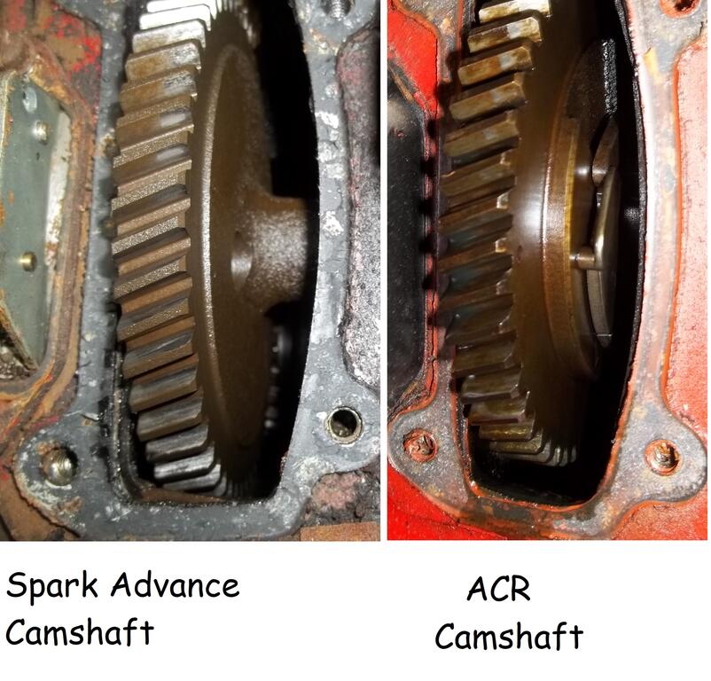

953 nut 70,323 #39 Posted December 13, 2020 On 12/9/2020 at 8:29 AM, Gregor said: I have rebuilt a lot of small 2 strokes, and in each case. the coil mounting hole are slotted for adjustment. Here is a coil from a 2 stroke. The coil from my Tecumseh H70 also has slotted holes for timing adjustment. The coil for the Kohler K161 has simple holes. No room for adjustment. The timing on a Kohler is adjusted by the gap of the ignition points. Ignition timing on Kohler engines. Gapping the ignition points at .020 has always been the standard answer to how points should be set. That probably will get you into the ballpark where the engine will run, but with a bit of additional effort you can improve the engine’s power and performance. The Kohler engine manual in the Red Square files section covers two methods for setting the ignition timing, Static Timing and using a Timing Light. This manual is a relatively new manual and it overlooks the fact that many of our engines were built prior to the ACR (automatic compression release) camshaft. Earlier engines (mostly 1965 and earlier) had a Spark Advance camshaft that can not be timed using Static timing. At rest (and very low RPMs) the timing is retarded to fire slightly after TDC. The timing mark (SP) on your flywheel is at twenty degrees before top dead center but at rest the points on these engines break about ten degrees after top dead center. The only reliable way to check or set the timing on these engines is with a timing light. There are a couple ways to determine what camshaft you have. Presuming the camshaft in your engine is the one it was born with the data plate on the engine has a suffix that can tell you what camshaft was used. The table below will tell you the suffix applicable to your engine. The other way to determine what camshaft you have is to remove the cam gear cover and take a look. If you see a mechanism attached to the cam gear it is the ACR cam. The following engines have the spark advance camshaft; K-141, Suffix prior to “C” K-161, Suffix prior to “J” K-181, Suffix prior to “D” K-241, Suffix prior to “D” 1 Share this post Link to post Share on other sites
Gregor 4,848 #40 Posted December 13, 2020 That is some good information. I don't have a timing light, and have not used one since in my teens, I don't think. My K161 does not have a cam cover. The model # is K161T. The spec # is 281271j. I assume they are talking about the model #. When and if I get this thing running, I will probably take it to my small engine guy, and watch as he fine tunes, the timing, carb, and governor. He's pretty good at feeding me info. 1 Share this post Link to post Share on other sites

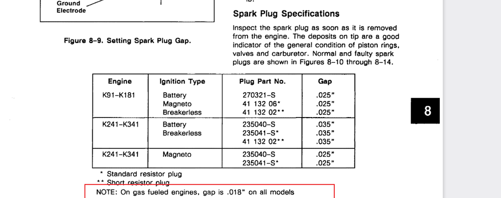

Gregor 4,848 #43 Posted December 14, 2020 I was reading through the Kohler manual last night, found this on page 8.7. The area in the red box confused me. "gas fueled"? If I am reading this right, gap is .018 1 Share this post Link to post Share on other sites
ebinmaine 81,138 #44 Posted December 14, 2020 1 hour ago, Gregor said: I was reading through the Kohler manual last night, found this on page 8.7. The area in the red box confused me. "gas fueled"? If I am reading this right, gap is .018 I don't know what the deal is there but all my gas engines of all the brands are set to about .025 1 Share this post Link to post Share on other sites
Handy Don 17,670 #45 Posted December 14, 2020 (edited) 2 hours ago, Gregor said: If I am reading this right, gap is .018 This is for engines running on propane or natural gas. Gaseous fuels vs. liquid like gasoline or diesel. Edited December 14, 2020 by Handy Don 2 Share this post Link to post Share on other sites
Gregor 4,848 #46 Posted December 14, 2020 Thanks That makes sense Share this post Link to post Share on other sites

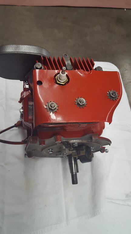

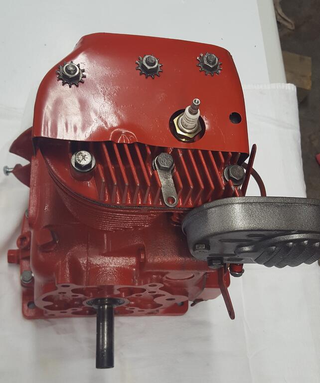

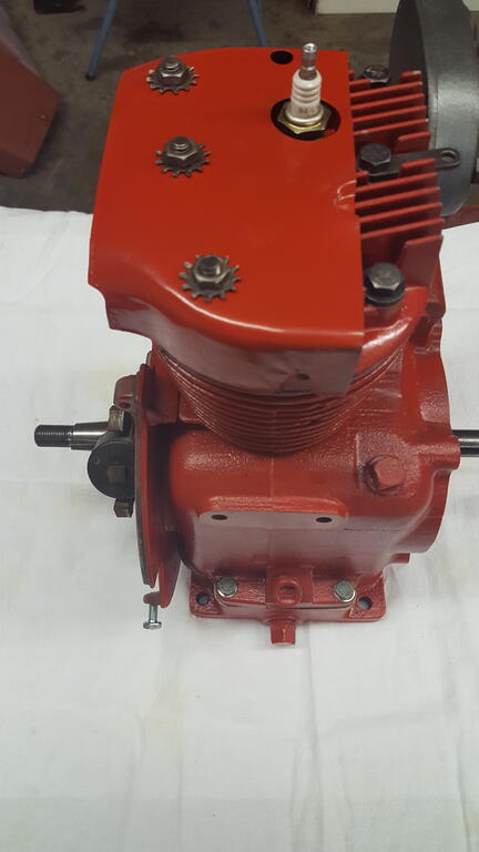

Gregor 4,848 #48 Posted December 16, 2020 I got more stuff today. Not enough to make it go , but closer anyway. Then I promptly ran out of paint. So now I wait. Again. 2 Share this post Link to post Share on other sites
