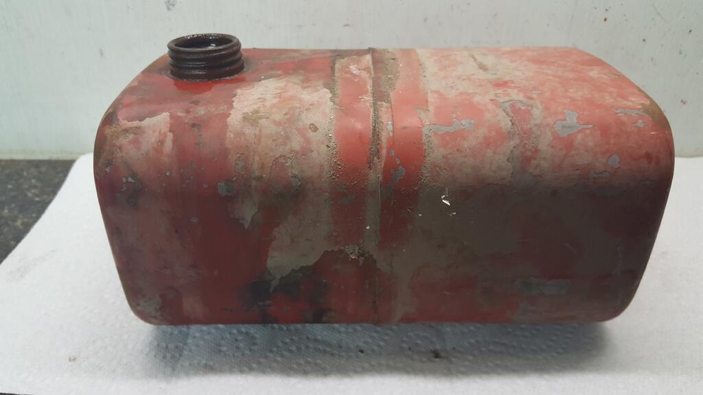

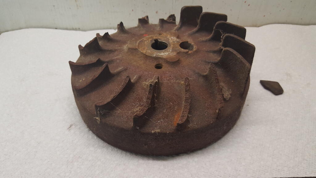

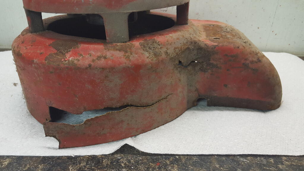

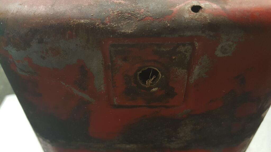

Gregor 4,847 #1 Posted December 6, 2020 I hated to start a new project, as I have 2 going on right now, but I am at a stand still, waiting for parts. So rather than sit here and watch Audie Murphy all day, I tore into the K161 I got yesterday. The first bit of bad news, the gas tank has a hole rusted through it. If any of you fine folks have this style gas tank, and you don't like it anymore, I would be interested. The shroud is in pretty rough shape, but if I can't replace it, I think I can repair it. The cooling fins are broke off the flywheel. Not sure what might have caused this. Maybe one broke, and took out the others. Again, If you have one you are mad at...... On the upside, none of the head bolts , or muffler bolts were froze. Came right out. The piston and valves have typical carbon build up for a 30 year old motor. Piston goes up and down, valves go up and down. Everything seems to move as it should with no binding or extra play in it. On another note, had a guy call me this morning. Saw my ad on CL. He has a Kohler ???. Found it along side the road. It is a horizontal shaft. Too dark in his shed, can't see any numbers. Turns over so far, then it just stops. He has no idea why. He also has a brand new Kohler 8hp (he thinks) short block. Still in the box. Again, can't see any numbers. Do you want to sell them? Of course. How much do you want? Well, I don't know. I'll have to think about that. Why do people do that? Drives a man to drink, but it's a little early in the day for me. 3 Share this post Link to post Share on other sites

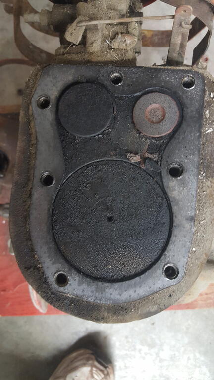

stevasaurus 23,517 #2 Posted December 6, 2020 Just for kicks, clean off the top of the piston and see what the numbers are on top of it. That will help to know if someone has been in there before. I'm thinking those fins were broke trying to pry the wheel for some reason. 1 Share this post Link to post Share on other sites
oliver2-44 11,075 #3 Posted December 6, 2020 that should be a common gas tank. If you don't find one, that one can be repaired. 2 Share this post Link to post Share on other sites

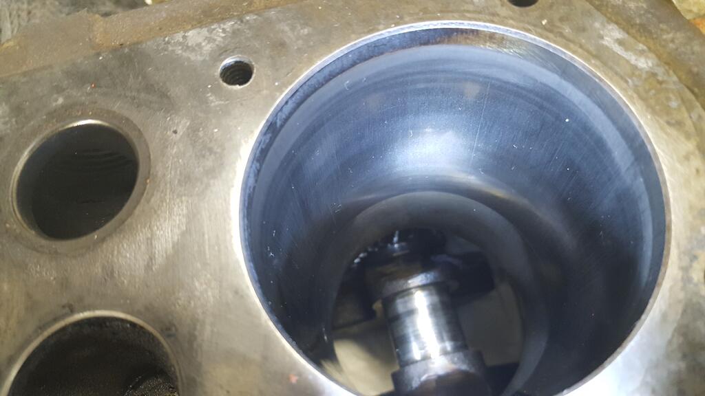

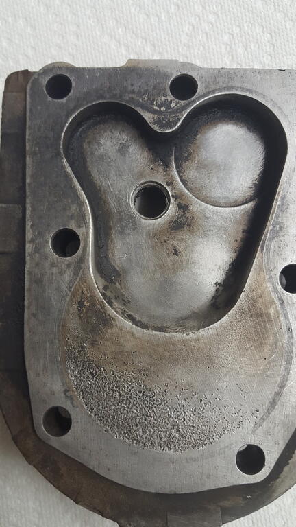

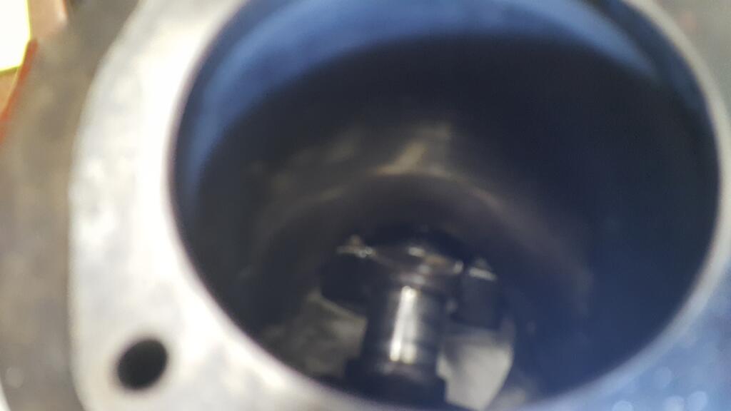

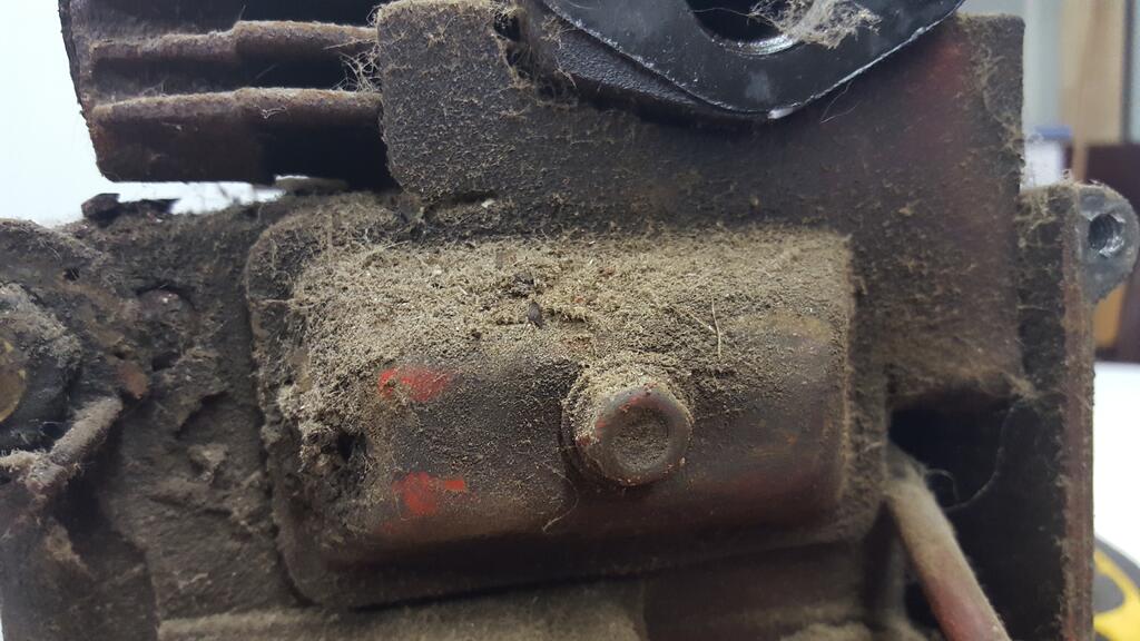

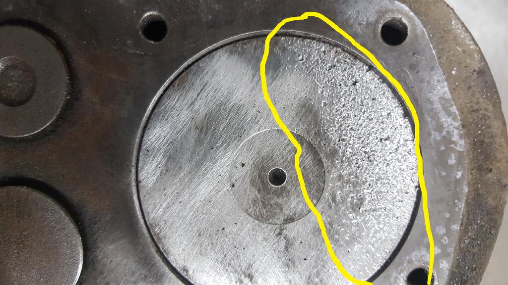

Gregor 4,847 #4 Posted December 6, 2020 I didn't see any numbers or marks on top of the piston, but I did see this. It reminds me of when the Kawasaki motor on my JD sucked a butterfly screw in to the cylinder. Kind-a beat up the piston some, but I put it back together, and it's still running 3 years later. Did something get in there and beat it up? Also, the valve cover seems to be stuck on tight. I do have the nut off, but it refuses to budge. Am I missing something, or it it just stuck? 1 Share this post Link to post Share on other sites
Gregor 4,847 #5 Posted December 6, 2020 It was just very stuck. As was the reed plate 3 Share this post Link to post Share on other sites
ebinmaine 75,793 #6 Posted December 6, 2020 Ain't that piston odd. How's the head? If you look closely at the gas tank and the rest of it is ok I'd repair that one. Go over it with a fine toothed comb so to speak though. Looks like it's surface rusted and pitted other places. 1 Share this post Link to post Share on other sites
ebinmaine 75,793 #7 Posted December 6, 2020 2 minutes ago, Gregor said: It was just very stuck. As was the reed plate Good that you got that off. I was going to suggest a 6 foot crowbar. 1 Share this post Link to post Share on other sites

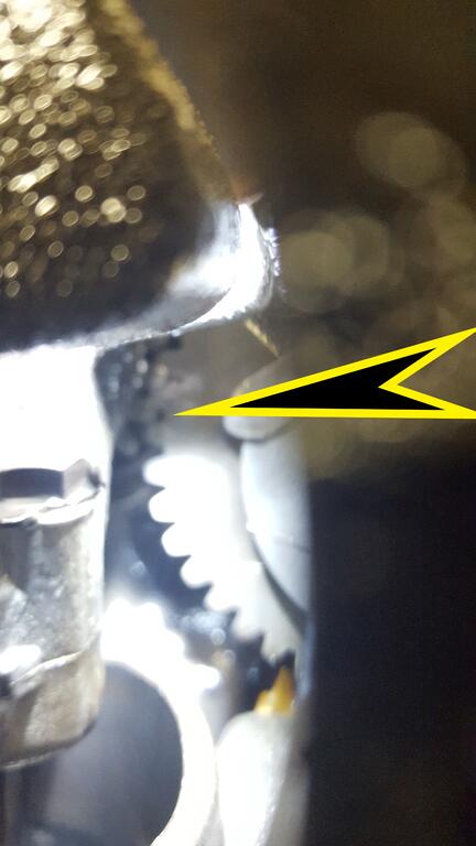

Gregor 4,847 #8 Posted December 7, 2020 I have the motor mostly tore down I don't think I am going to remove the cam and governor. The lobes on the cam look very good, and the ACR weights move free, as does the governor. Besides, I read the book on how to remove and reinstall, and I'm not sure I understand it all. It will stay as is. So Far I am pretty happy with what I have found. Keep in mind this is coming from a guy who doesn't really know what he is doing, but has watched a LOT of Youtube. I spent over an hour trying to remove the bearing plate. I knew I could get it off, but I wanted to get it off without breaking it. Every time it popped I groaned. All of the specs I have checked seem to be very good, with one exception. The valve clearance on the exhaust valve was .025. According to the book, it should be .017. Maybe it will be closer after cleaning up the valve, the seat, and lapping, if not, I guess a new valve is in order. Notice anything missing in the first pic? The oil dipper seems to have dipped out. It was not in the pan. After some measuring I determined it could have been drained out during an oil change. Maybe someone noticed it, maybe not. At any rate, I need a new rod. In the second pic you can just make out the dot on the cam for the timing mark. Try as I might, I could not find a mark on the tooth of the crankshaft gear. Back to the book. Seems the mark isn't on the tooth, it is on the crank itself. Ahhh, there it is. A little white out and it will be a lot easier for me to see. I'm old ya know. The third and fourth pics shows the cylinder walls. There is no ridge what so ever, and they measure good. Any scratches on the piston I believe could be removed with steel wool, if I wanted. After some clean up, new rings, possibly new valves, gasket set, maybe a new carb, and a new flywheel,(that be be hard to find) it just might run again. 3 Share this post Link to post Share on other sites

ebinmaine 75,793 #12 Posted December 7, 2020 Interesting that the rod dipper is gone. Someone swap oil pans to a shallow sump? I'll second the carb cleaning. I've seen/tried 3 of the cheap carbs. Not again. 1 Share this post Link to post Share on other sites

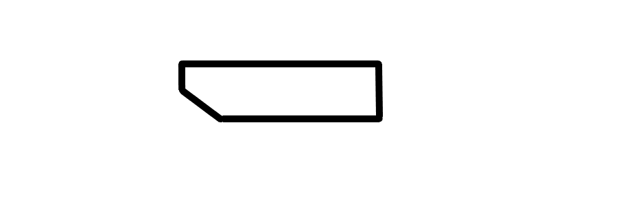

Gregor 4,847 #15 Posted December 7, 2020 16 hours ago, ebinmaine said: Ain't that piston odd. How's the head? I wasn't even smart enough to look at the head. After some initial clean up, the head has the same marks as the piston, in the same area. I'm assuming something got in there at some time, or maybe just carbon build up. While I am here I have yet another question. I took the top ring off the piston to check ring gap in the cylinder. After I took it out of the cylinder I noticed a small dot on the ring. Also the ring is chamfered like shown in the pic. I wasn't sure how it was oriented on the piston. Obviously I should have paid more attention. I took to youtube to see what I could learn. One video said, if there is a mark on the ring, (such as a dot), the mark goes to the top. Another video said, the chamfered edge goes down. Of course these 2 videos contradict each other. The chamfered edge is on the inside of the ring. I would like to order a new rod, rings, valves and all the other goodies for this motor, but if I can't find a new flywheel, none of it will do much good. For now I have things soaking for clean up, then I'll bag it, tag it, and put it up. 2 Share this post Link to post Share on other sites
953 nut 63,089 #16 Posted December 7, 2020 The rings you buy should come with a sheet showing how to orient the rings. If you haven't done so take the time to read through the tutorial @prondzy did, it is excellent! 1 1 1 Share this post Link to post Share on other sites
ebinmaine 75,793 #17 Posted December 7, 2020 It's been a long time since I've messed with engines and pistons but I would agree that the dot goes up it's to do with oil control I believe. I think it makes sense looking at the marks that at some point that engine may have lost a chunk of carbon and smushed it. I wouldn't get too awful worried about trying to find a flywheel for that because it was a very popular engine for at least a decade, maybe more. My suggestions on trying to find a flywheel would be to put a wanted ad on this site and also call Lincoln at A to Z tractor in Pennsylvania. Share this post Link to post Share on other sites
Gregor 4,847 #18 Posted December 7, 2020 THANK YA THANK YA THANK YA! I have a flywheel and shroud coming from A to Z. When it gets here and all is good, I will order all my new parts. I gotta remember this A to Z place. 2 Share this post Link to post Share on other sites
ebinmaine 75,793 #19 Posted December 7, 2020 22 minutes ago, Gregor said: THANK YA THANK YA THANK YA! I have a flywheel and shroud coming from A to Z. When it gets here and all is good, I will order all my new parts. I gotta remember this A to Z place. You're quite welcome! That's where we are all here for... Helping out. I normally will make Lincoln my first call after checking with this site. Mental note, ALWAYS call him and do not rely on his website because he's very very busy.... Share this post Link to post Share on other sites

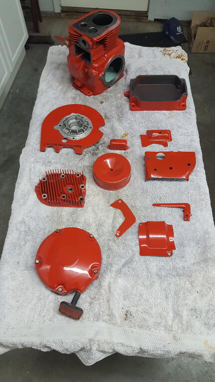

Gregor 4,847 #20 Posted December 8, 2020 Lincoln sent me an email with pics of the flywheel, fuel tank, and shroud he is sending me. Looks exactly like mine. Sooooo, I decided to do some clean up on the K161, and I ordered some parts. If the parts ever show for my Tecumseh, I might get that back together. 4 1 Share this post Link to post Share on other sites

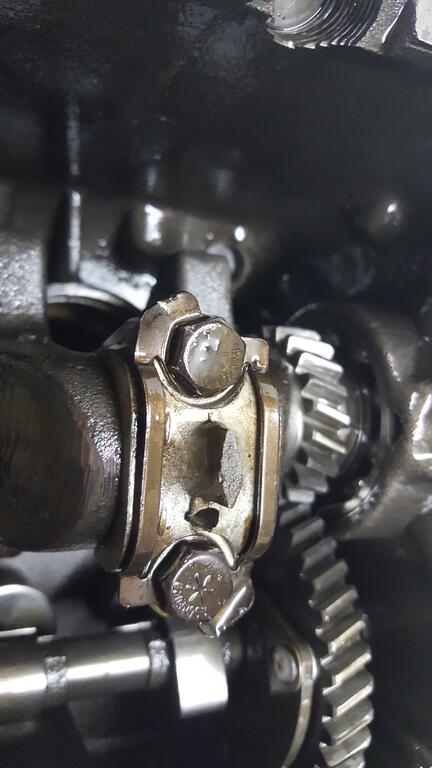

oilwell1415 563 #23 Posted December 8, 2020 Did you bend the lock tabs on the connecting rod bolts down? Or were they like that when you took it apart? 1 Share this post Link to post Share on other sites
Gregor 4,847 #24 Posted December 8, 2020 I bent them down. 1 Share this post Link to post Share on other sites
KAA 1973 71 #25 Posted December 9, 2020 The cylinder walls are pretty shiny My brother scored a super clean 312-8 really cheap, previous owner said the engine was down on power so I had the motor rebuilt, it's still down on power. Took it home and opened it up, cylinder bore was really shiny, ran a hone through it and put new rings on it and now tons of compression, runs like new. If your adding rings to a engine, honing the block is pertinent if there's no sign of cross hatching. 1 Share this post Link to post Share on other sites
