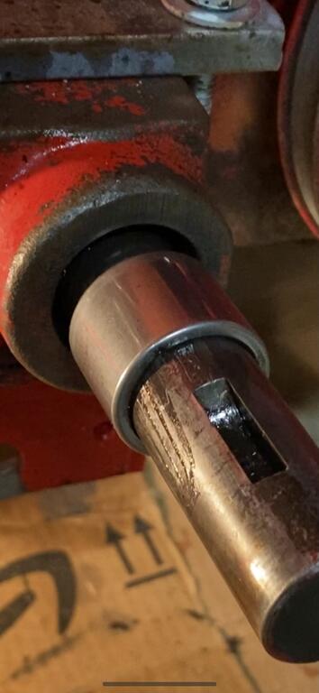

Greenhorse 15 #1 Posted December 6, 2020 I noticed my rear axle was leaking so after removing the hub I noticed that the needle bearing was loose but I did not see a axle seal. Has anyone ever experienced this or can help me ? This is my first Wheel Horse so I’m kind of learning as I go. It’s a 310 -8. I’ve included a photo. Thanks. Share this post Link to post Share on other sites
ebinmaine 78,354 #2 Posted December 6, 2020 Did you find it like that or pull the bearing yourself?? The seal would have been on the outside of that bearing. If it was a replacement by a PO and it was ALL rubber I've seen them deteriorated to near nothing. 1 Share this post Link to post Share on other sites
pfrederi 20,305 #3 Posted December 6, 2020 Needle bearings are a press /interference fit. You should not be able to pull it out by hand. Share this post Link to post Share on other sites
stevasaurus 23,662 #4 Posted December 6, 2020 Right, we need some more background here. It may be fixable without opening the transmission...if all the needles are in the bearing. Take the bearing the rest of the way off and take a good lookin that axle shaft. What does the other side look like?? Share this post Link to post Share on other sites
oliver2-44 11,406 #5 Posted December 6, 2020 I'm following on to learn something on this one myself. 1 Share this post Link to post Share on other sites
lynnmor 8,748 #6 Posted December 6, 2020 Pull the bearing and measure the O.D. to see if that is correct. If the bearing measurement is correct and the axle is smooth where the bearing rides, you could try using Loctite 609 to retain the bearing. If the bore in the housing is just too large, then replacement is the fix. Share this post Link to post Share on other sites

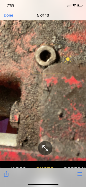

Greenhorse 15 #7 Posted December 11, 2020 Yes, the needle bearing was mostly out. It worked itself out and I’ve only had the 310 for a couple weeks when I noticed this. It had been leaking and there was no seal whatsoever so you’re probably right about the old one just disintegrating.Some of the needles, about five, were missing. Hopefully they just fell off into the yard,and I used a wire pick to fish around inside the best I could for any inside the axle area. I did order a replacement needle bearing, part number 1528, and a new oil seal part number 100863. I was able to get everything back together and running. So far so good. Thanks for all the advice. Now if I can get the transmission plug off. 😕I don’t know if it’s stripped or what but it looks like a three-quarter circle with a straight line on the rest of it. Any tips? 1 Share this post Link to post Share on other sites
ebinmaine 78,354 #8 Posted December 12, 2020 Any chance of cleaning up the plug and gettin a pic or 2? Share this post Link to post Share on other sites
ebinmaine 78,354 #10 Posted December 12, 2020 Look like the hitch tab has been in contact with the plug. Do you have a welder or a small torch? Share this post Link to post Share on other sites
Greenhorse 15 #11 Posted December 12, 2020 I do have a small torch and I’m pretty sure a couple of the threads are protruding so I might be able to put some vice grips on them. I’m guessing you think I should heat it up a little bit? 1 Share this post Link to post Share on other sites
ebinmaine 78,354 #12 Posted December 12, 2020 28 minutes ago, Greenhorse said: I do have a small torch and I’m pretty sure a couple of the threads are protruding so I might be able to put some vice grips on them. I’m guessing you think I should heat it up a little bit? Without easy access to a welder I'm thinking the best case is to get a pair of NEEDLE NOSE vise grips heat the plug up some and lock the grips on HARD. Use a different tool to turn the vise grips. 1 Share this post Link to post Share on other sites
Greenhorse 15 #13 Posted December 12, 2020 I will give it a try. Thanks. 1 Share this post Link to post Share on other sites
953 nut 65,344 #14 Posted December 12, 2020 Glad you were able to get the bearing and seal installed. The drain plug should have been an Allen Wrench socket. If you can manage to get an allen wedged into the hole it may work. 1 Share this post Link to post Share on other sites
lynnmor 8,748 #15 Posted December 12, 2020 If you can't tap a 1/4" Allen wrench in the hole and get enough grip to remove the plug, you might consider going to the next larger size wrench and grinding a taper on the flats as lead-in. I have done this numerous times as a tool & die maker because much of the tooling uses hex drive fasteners. Yes, you might waste a wrench, but you will have it for next time. The hole can be tapped deeper to make the plug flush, or grind down a new plug. I do a combination of both so as not to make the hex too shallow and allow for future repair tapping of the housing. Whatever you decide, make sure no hitches or other things contact the plug. 1 1 Share this post Link to post Share on other sites
ebinmaine 78,354 #16 Posted December 12, 2020 57 minutes ago, lynnmor said: If you can't tap a 1/4" Allen wrench in the hole and get enough grip to remove the plug, you might consider going to the next larger size wrench and grinding a taper on the flats as lead-in. I have done this numerous times as a tool & die maker because much of the tooling uses hex drive fasteners. Yes, you might waste a wrench, but you will have it for next time. The hole can be tapped deeper to make the plug flush, or grind down a new plug. I do a combination of both so as not to make the hex too shallow and allow for future repair tapping of the housing. Whatever you decide, make sure no hitches or other things contact the plug. That's a good idea. Allen wrenches are dirt cheap. Share this post Link to post Share on other sites
Greenhorse 15 #17 Posted December 12, 2020 I am got lucky on this one guys. I went with the easiest option first and put a little heat on it and was able to loosen it with a pair of vise grips and small pipe used as leverage. I will definitely use the other advice sent my way in the future if I find myself in a similar situation.I have the front end raised up and I am draining the oil now. I read that it can be difficult adding the new oil but I read that somebody inserted a small tube into the dipstick to allow the air to escape. Has anybody tried this technique? Thanks. 1 Share this post Link to post Share on other sites
