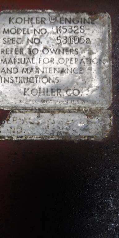

Richardmewen 4 #1 Posted December 6, 2020 hi all bought a d180 or so I thought . the eng tag says k532s . is this actually a. D200 . thanks for any information Share this post Link to post Share on other sites

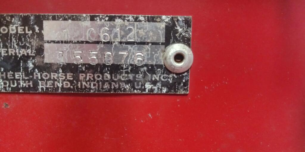

Pullstart 71,522 #2 Posted December 6, 2020 Can you find the tractor model/I.D. Tag? It could be an engine transplant too... Share this post Link to post Share on other sites
pfrederi 21,312 #4 Posted December 6, 2020 (edited) Model is correct for D-180 Replaced engine??? How big is your gas tank Tall like mine would be D200 D180 tank is shorter. Edited December 6, 2020 by pfrederi Share this post Link to post Share on other sites

pfrederi 21,312 #6 Posted December 6, 2020 Guess you have a D-180 with a replacement engine Share this post Link to post Share on other sites
oliver2-44 11,825 #7 Posted December 6, 2020 Post the Serial # on the Kohler K532 tag and maybe we can help identify the year of the motor. Share this post Link to post Share on other sites
gwest_ca-(File Mod) 12,535 #9 Posted December 6, 2020 That is the engine used in the D-200 1974-1981. The bottom decal with the serial number is what identifies the year Kohler made the engine. These are from the front of the engine service manual for dating Share this post Link to post Share on other sites
