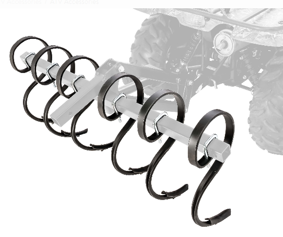

DennisThornton 4,773 #1 Posted December 4, 2020 I have 40 acres of glacial till in the Adirondacks and I can't stick a shovel in the ground anywhere without hitting a rock. There is some decent soil in between in some areas but every time I challenge the earth I fight rocks. Some as big as vehicles but even when the big ones are removed I still fight rocks. ROCKS! Anybody used one of these? Or anyone want some rocks? 7 Share this post Link to post Share on other sites

71_Bronco 1,073 #3 Posted December 4, 2020 Thats a pretty cool impliment, almost like a less-agressive cultivator. 1 Share this post Link to post Share on other sites

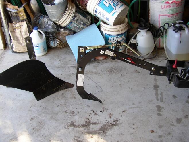

Handy Don 17,563 #5 Posted December 4, 2020 4 minutes ago, ebinmaine said: We've thought about making a single tooth scarifier that would be at the back or on a mid hitch. We MIGHT be able to get away with 2 teeth. As much as I like the idea of a multiple tooth set-up like that I believe it would be very limited in usefulness to us because of the amount of rocks. I agree that a single tooth might be all that the tractor can handle in very rocky soils. It would allow the tooth to flex the arm and slip around one of those furniture-sized rocks where a multi-tooth implement might get stuck--might be able to run deeper, too. At some point, it seems like Brinly offered a ripper tooth as a swap for the plowshare on their moldboard plow arm--not in their current lineup, though (I suspect the AG Supply's 16" bolt on's might work here if you already have the arm). Nice feature of this setup is the adjustable angle of attack but I'd think it might need some weight to get it stay down in rocky soil since most WH sleeve hitches are gravity only for down pressure. Am on the lookout for something like this to make or buy for use on the Tug Hill in upstate NY (west of @DennisThornton's neck of the woods) 4 Share this post Link to post Share on other sites

DennisThornton 4,773 #8 Posted December 4, 2020 4 minutes ago, Handy Don said: I agree that a single tooth might be all that the tractor can handle in very rocky soils. It would allow the tooth to flex the arm and slip around one of those furniture-sized rocks where a multi-tooth implement might get stuck--might be able to run deeper, too. At some point, it seems like Brinly offered a ripper tooth as a swap for the plowshare on their moldboard plow arm--not in their current lineup, though (I suspect the AG Supply's 16" bolt on's might work here if you already have the arm). Nice feature of this setup is the adjustable angle of attack but I'd think it might need some weight to get it stay down in rocky soil since most WH sleeve hitches are gravity only for down pressure. Am on the lookout for something like this to make or buy for use on the Tug Hill in upstate NY (west of @DennisThornton's neck of the woods) i've fought rocks here since 1986 and lost every year! My best approach has been to backhoe an area, pull out the boulders and then run the rest though a screener. Seldom worth it but I've done it a couple times. I think a rock grapple is my next best friend. 1 Share this post Link to post Share on other sites

oliver2-44 11,782 #16 Posted December 4, 2020 1 hour ago, DennisThornton said: What if you turned the points around with the slope forward Maybe it would take some tractor down pressure to keep it in the good soil, but would ride up over the rocks Because of our hard clay soils when dry I saw a local farm pond builder with some homemade pivoting rippers on the back of his dozer blade. Going forward they pivoted horizontal, then when backing up he just barely drug his blade and the rippers rode against the back of the blade and dug in. No lost motion. 3 Share this post Link to post Share on other sites
DennisThornton 4,773 #17 Posted December 4, 2020 3 minutes ago, oliver2-44 said: What if you turned the points around with the slope forward Maybe it would take some tractor down pressure to keep it in the good soil, but would ride up over the rocks Because of our hard clay soils when dry I saw a local farm pond builder with some homemade pivoting rippers on the back of his dozer blade. Going forward they pivoted horizontal, then when backing up he just barely drug his blade and the rippers rode against the back of the blade and dug in. No lost motion. Perhaps similar to my spring harrows! Engage and move it or just spring over and exclude it ?. I don't know but it is a struggle that I lose most of the time! Share this post Link to post Share on other sites

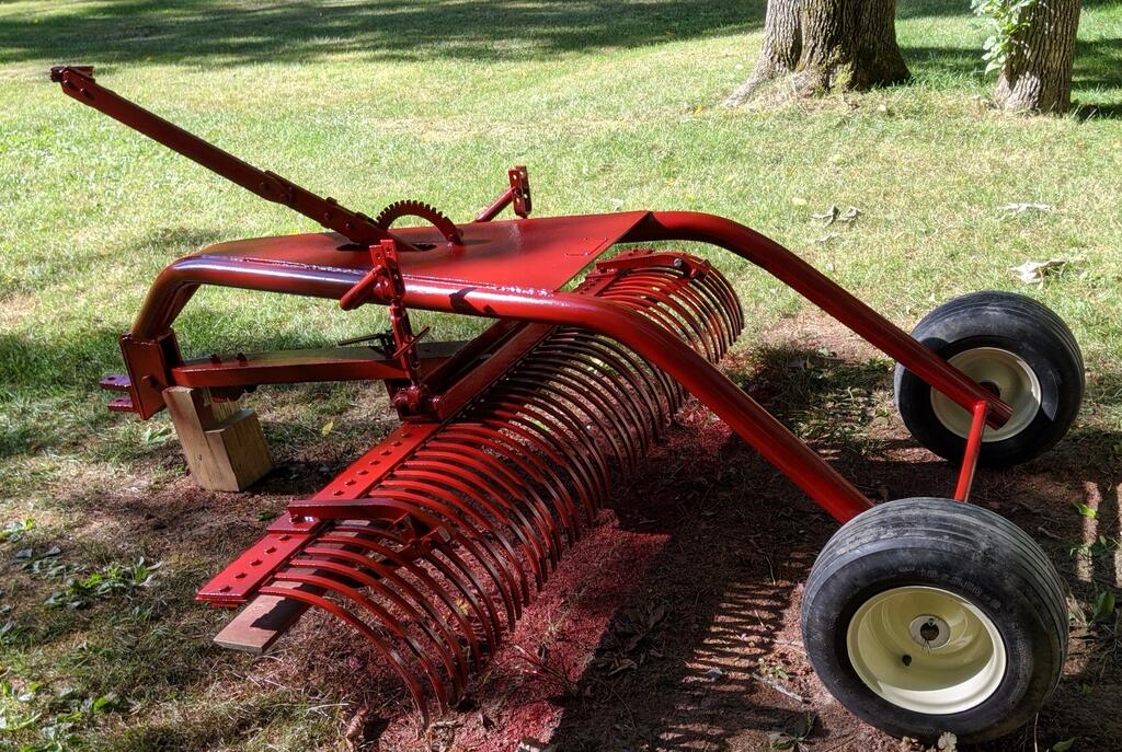

rjg854 13,405 #18 Posted December 5, 2020 Not sure what kind of rocks your dealing with, maybe something like this 4 Share this post Link to post Share on other sites
ecsi635j 34 #19 Posted December 5, 2020 Not to take away from your topic, but is that a Bolens Tube frame I see there! Both gear drive and Hydro's are very stout and capable tractors. Share this post Link to post Share on other sites
DennisThornton 4,773 #20 Posted December 5, 2020 12 hours ago, rjg854 said: Not sure what kind of rocks your dealing with, maybe something like this Got two! Both are great for what they do but they are no match for big rocks. This is similar to spring tooth 1 Share this post Link to post Share on other sites
