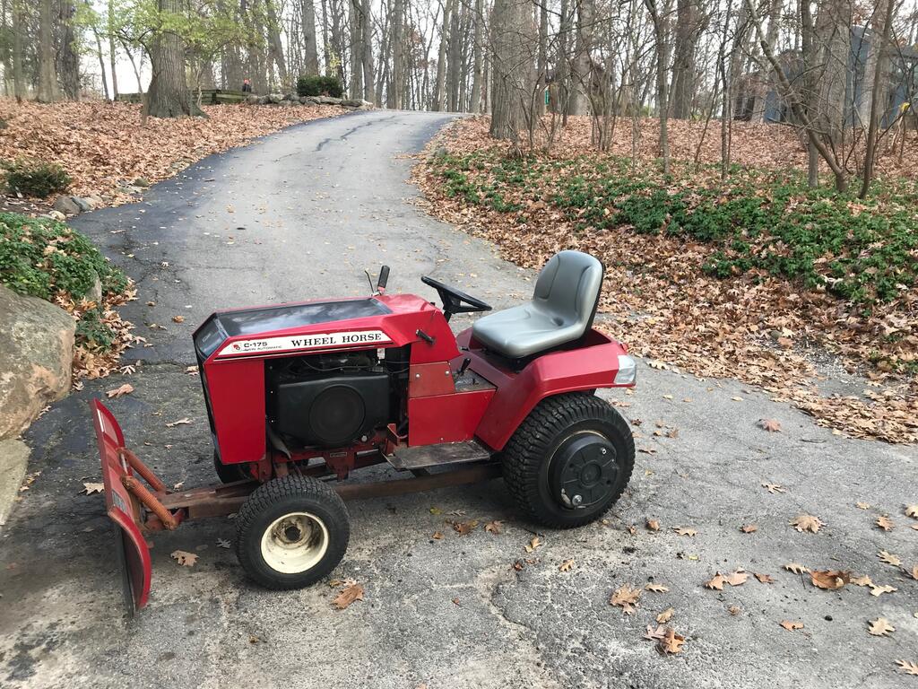

JohnD 145 #11 Posted December 6, 2020 My C-175 has 9" long bolts and they end flush with the nuts at the outer edge of the weight. Perfect! 1 Share this post Link to post Share on other sites
ebinmaine 80,304 #12 Posted December 6, 2020 Just now, JohnD said: My C-175 has 9" long bolts and they end flush with the nuts at the outer edge of the weight. Perfect! That'll be about right with the second set of weights on. Share this post Link to post Share on other sites
JohnD 145 #13 Posted December 6, 2020 1 hour ago, ebinmaine said: That'll be about right with the second set of weights on. It's a single weight. A different single weight, I guess. 2 Share this post Link to post Share on other sites
Jeff-C175 7,211 #14 Posted December 9, 2020 On 12/5/2020 at 8:46 PM, JohnD said: My C-175 has 9" long bolts and they end flush with the nuts at the outer edge of the weight. Perfect! I think it must depend entirely on the exact weights used. The ones I found on the side of the road took 7" long 1/2" bolts but they are not as thick as the ones in JohnD's photo. Mine snug into the wheel much farther, I guess 2" less 'stick out'! 1 Share this post Link to post Share on other sites
