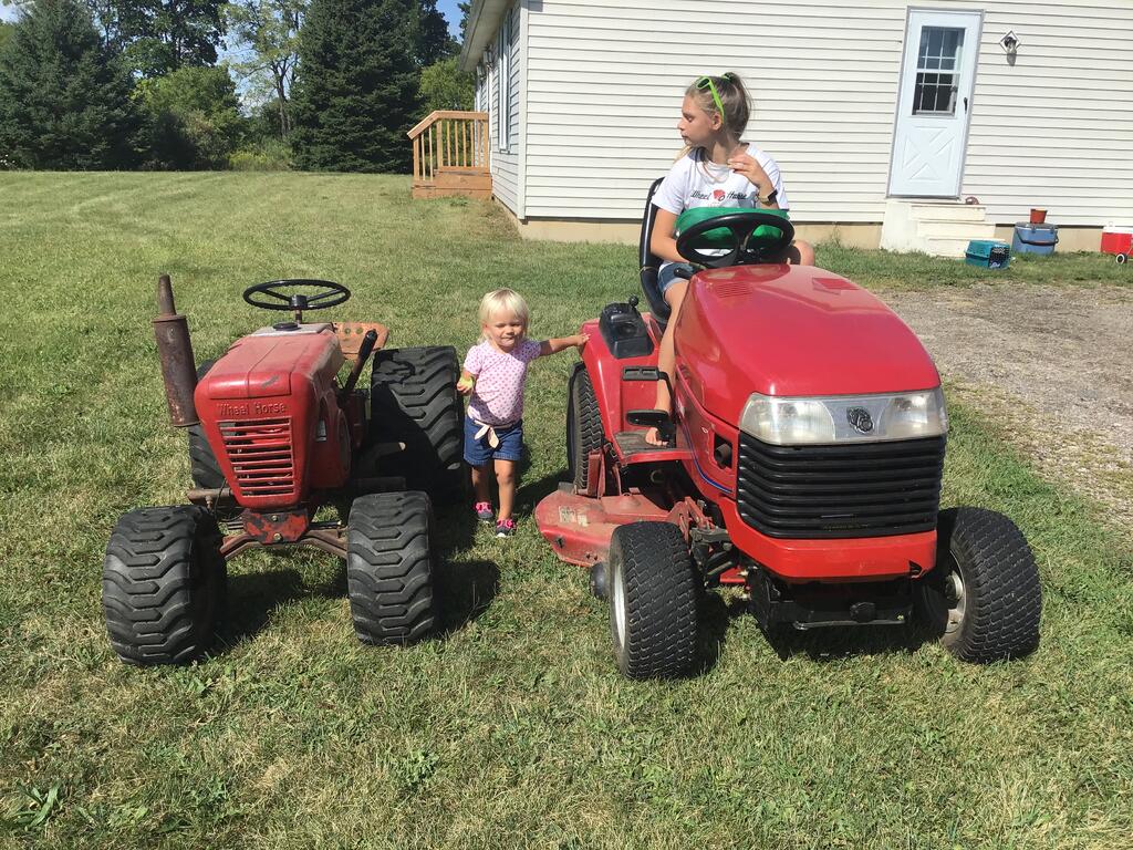

Pullstart 67,042 #17 Posted December 4, 2020 Out back AND up front! I personally like big and wide. 2 2 Share this post Link to post Share on other sites
