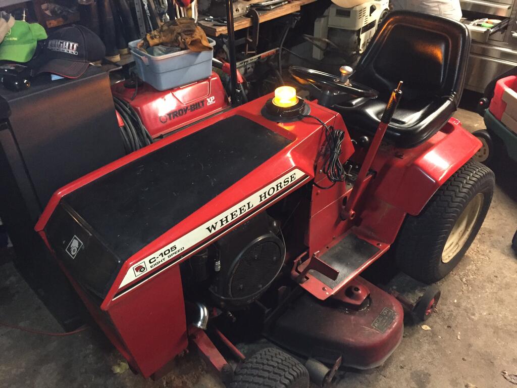

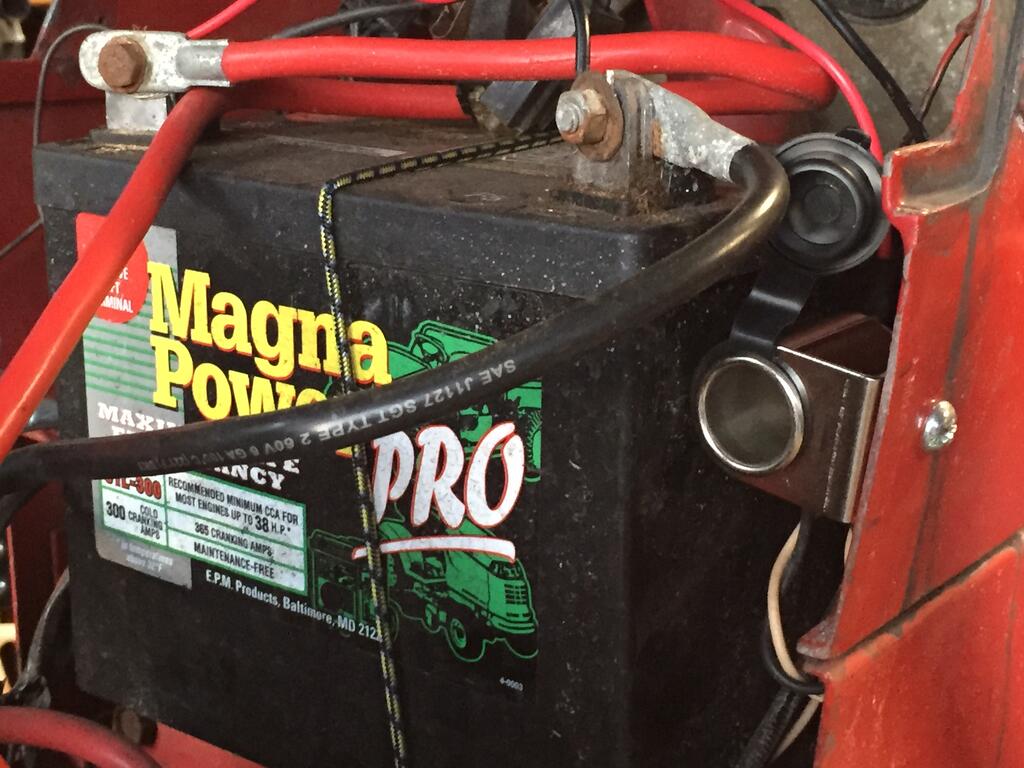

SylvanLakeWH 30,601 #4 Posted December 3, 2020 I added a cigarette lighter and put on a magnetic amber strobe with an in-line switch... works like a charm. 4 1 Share this post Link to post Share on other sites

ebinmaine 77,394 #6 Posted December 3, 2020 1 hour ago, SylvanLakeWH said: I added a cigarette lighter and put on a magnetic amber strobe with an in-line switch... works like a charm. 1 hour ago, 953 nut said: I used an adjustable speed LED Motorcycle flasher on the taillights, you can set any speed you want. Mine are set up as a strobe light, https://www.wish.com/product/5784bb2f3ae7107d1256562e?hide_login_modal=true&from_ad=goog_shopping&_display_country_code=US&_force_currency_code=USD&pid=googleadwords_int&c={campaignId}&ad_cid=5784bb2f3ae7107d1256562e&ad_cc=US&ad_lang=EN&ad_curr=USD&ad_price=2.80&campaign_id=7203534630&gclid=Cj0KCQiAtqL-BRC0ARIsAF4K3WFG755GIg-oGCEtMtdGheb-OtOT6kjoOyeOH1dm85RY0twHSjq_QtoaAhVfEALw_wcB&share=web Both excellent ideas but neither one legal in locality... Strobes have to be visible 360. Richard I'm assuming you're using red tail lights? We can't have any red or blue lights flash up here.. 1 Share this post Link to post Share on other sites
SylvanLakeWH 30,601 #7 Posted December 3, 2020 56 minutes ago, ebinmaine said: Both excellent ideas but neither one legal in locality... Strobes have to be visible 360. Yup - I might put a pole on back and raise it up... but I have the two standard back lights and a third led that is on the “brake light” brightness so I am pretty well lit up... 1 Share this post Link to post Share on other sites
ebinmaine 77,394 #8 Posted December 3, 2020 11 minutes ago, SylvanLakeWH said: Yup - I might put a pole on back and raise it up... but I have the two standard back lights and a third led that is on the “brake light” brightness so I am pretty well lit up... Very nice very nice I intend to put a light on a pole at the back of the tractor at some point but I don't see that happening immediately so I purchased two magnet mount strobes and I'm going to plop one on each back fender corner for now. 1 Share this post Link to post Share on other sites

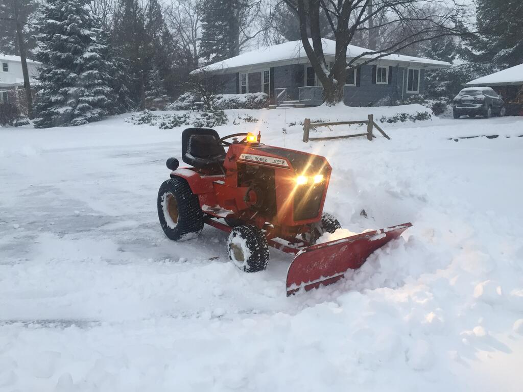

WHX?? 55,086 #9 Posted December 3, 2020 Tom @Shynon rigged up a pair of very bright led head lights on his 1054 plow tractor that he can make flash. Not sure if they would be legal on a road tho? Might have to check first. He had them flashing on the plow field and I thought the cops were after me! 5 Share this post Link to post Share on other sites
