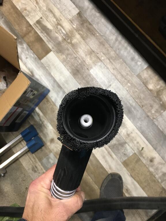

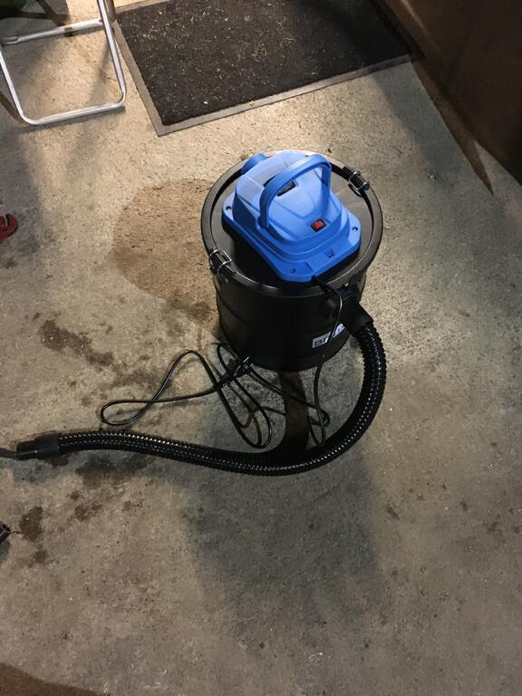

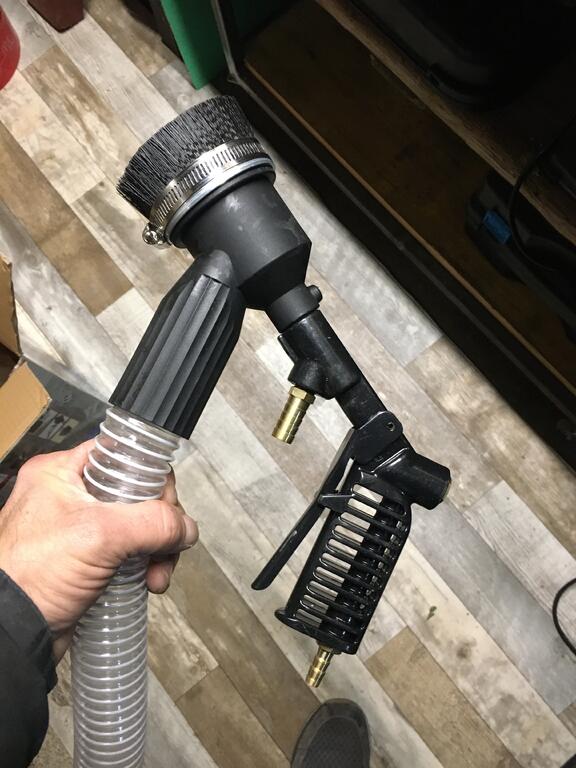

Tractorhead 8,610 #1 Posted December 1, 2020 I be interested a very long time in a Sandblast cabinet, but the longer i think about it, the longer i doubt i wanna waste that Space. When i brought my Rims to the Company they powdercoat them, i see there sandblasting cabinets, boy bee this things huge. Ok not an option, especially because of the Dust. So i developed an idea and thinkering a lot about it. How about a Vacuum reworked and a Sandblasting system with an Feedback system, to reduce massive the waste and reduce the dust on Working. I found on fleebay this Sandblasting Gun, i be interested in, that is exactly what i‘m thinking about. for 30$ It seems to be not a unrealistic Pricerange. So i ordered it and a Ash vacuum what have an fine filter in it. my idea is drilling a hole in the bottom of that vacuum bowl, to suck the sand to the sandblasting gun via a pipe and via Vacuum it back into the Bowl. In the Bowl i will insert a fine mesh to extract bigger parts, the sand hopefully drops down in the Sucktion chamber near bottom. So i have a continouse working system with sand rejeckt let‘s see how it works. Very interesting sandblasting Gun and with Vacuum connector. For 30$ it seems the price worth. A mask is allway’s recommended on suck Work, but i hope to reduce the dust to nearly 0 And the Ash Vacuum with it‘s Bowl. Need few fittings and Pipes but i will forward my experience if somebody interested in. 10 Share this post Link to post Share on other sites

squonk 38,916 #6 Posted December 1, 2020 Sand is very destructive to vacuum motors. Filters or no filters, sand will get in it. You may find your vac dies an early death. Even motors designed for sand blasting fail. You need to build a dust collector to go along with the vac 1 Share this post Link to post Share on other sites

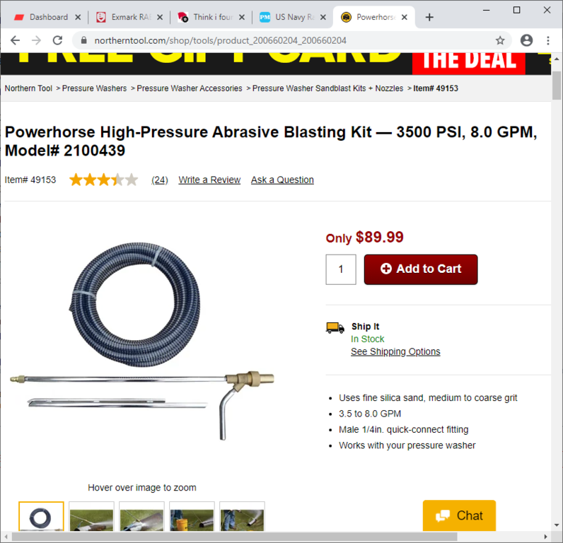

DET 103 #11 Posted December 2, 2020 I bought one of these from Northern Tool. It attaches to my pressure washer and works pretty good. 2 Share this post Link to post Share on other sites
rmaynard 14,893 #12 Posted December 2, 2020 11 hours ago, Achto said: One of these added into the collection system will help prolong your vacuum's life. https://www.wish.com/product/5de5ce401fdb34dd2719085b?hide_login_modal=true&from_ad=goog_shopping&_display_country_code=US&_force_currency_code=USD&pid=googleadwords_int&c={campaignId}&ad_cid=5de5ce401fdb34dd2719085b&ad_cc=US&ad_curr=USD&ad_price=19.99&campaign_id=7203534630&gclid=CjwKCAiA8Jf-BRB-EiwAWDtEGjJXYu-hQ01TM-BfIiIuioadZcsblmc4FqToppd5CSpob1CHuw2hBBoCYQ0QAvD_BwE&share=web Bought one of those from Amazon for about $18.00 last year but never got around to hooking it up. 1 Share this post Link to post Share on other sites
DennisThornton 4,769 #13 Posted December 2, 2020 2 hours ago, DET said: I bought one of these from Northern Tool. It attaches to my pressure washer and works pretty good. I bought the same years ago and haven't used it yet... I thought it would be a way to NOT have to buy a big air compressor and control all the dust. Glad to hear that you are satisfied. What water blaster do you have or at least it's GPM? Share this post Link to post Share on other sites
DET 103 #14 Posted December 2, 2020 Dennis, it is rated 2600 psi max, 2.5 gpm max Share this post Link to post Share on other sites

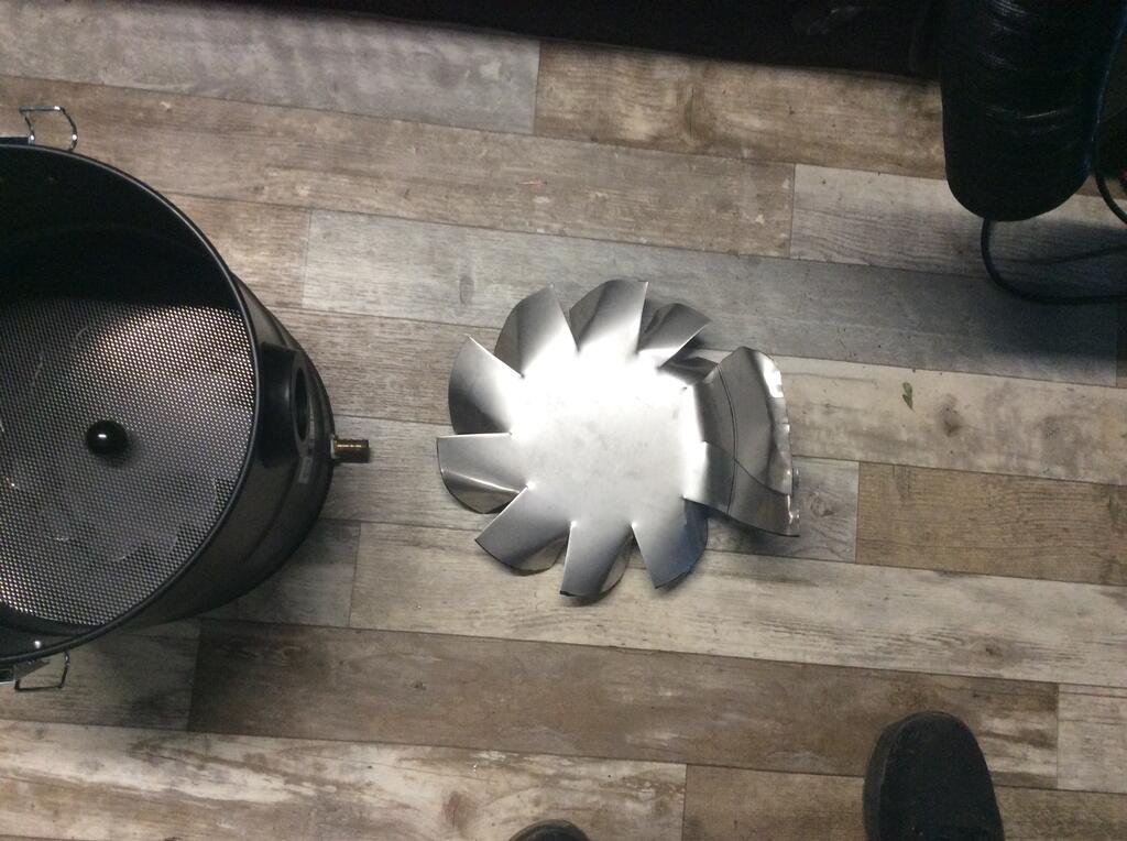

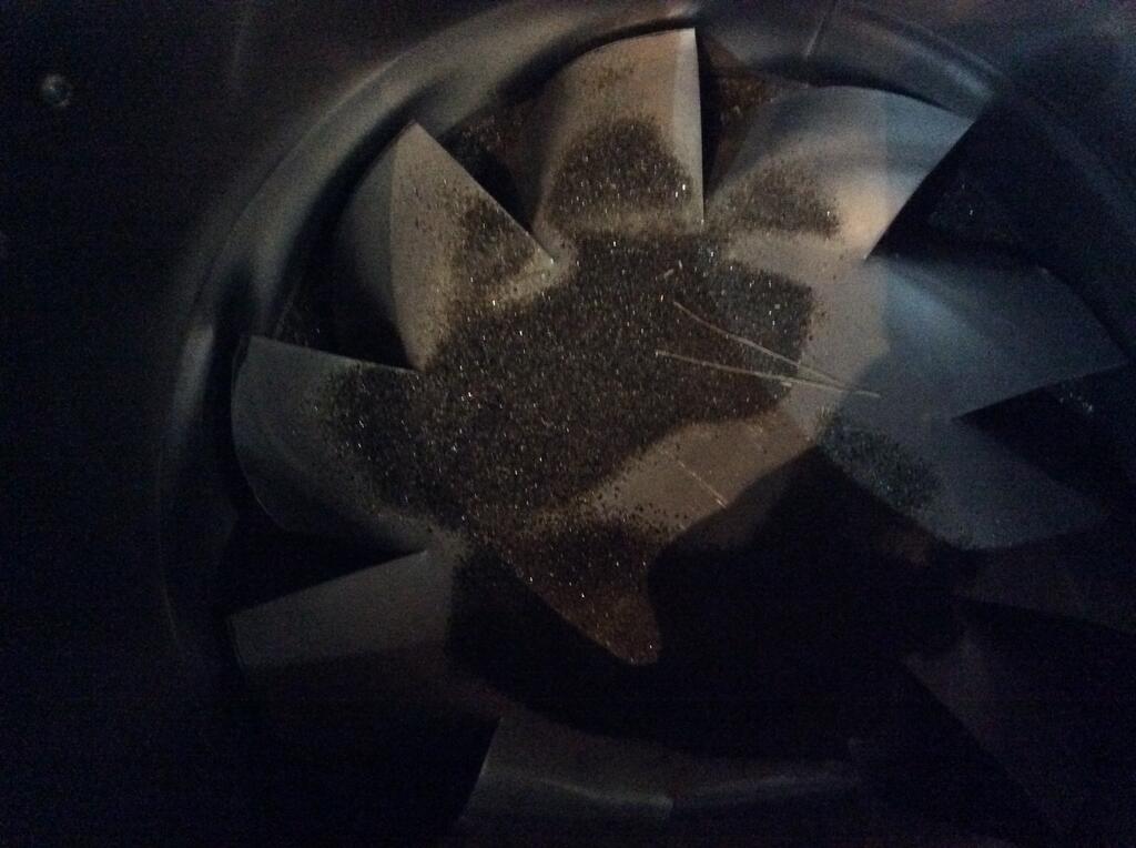

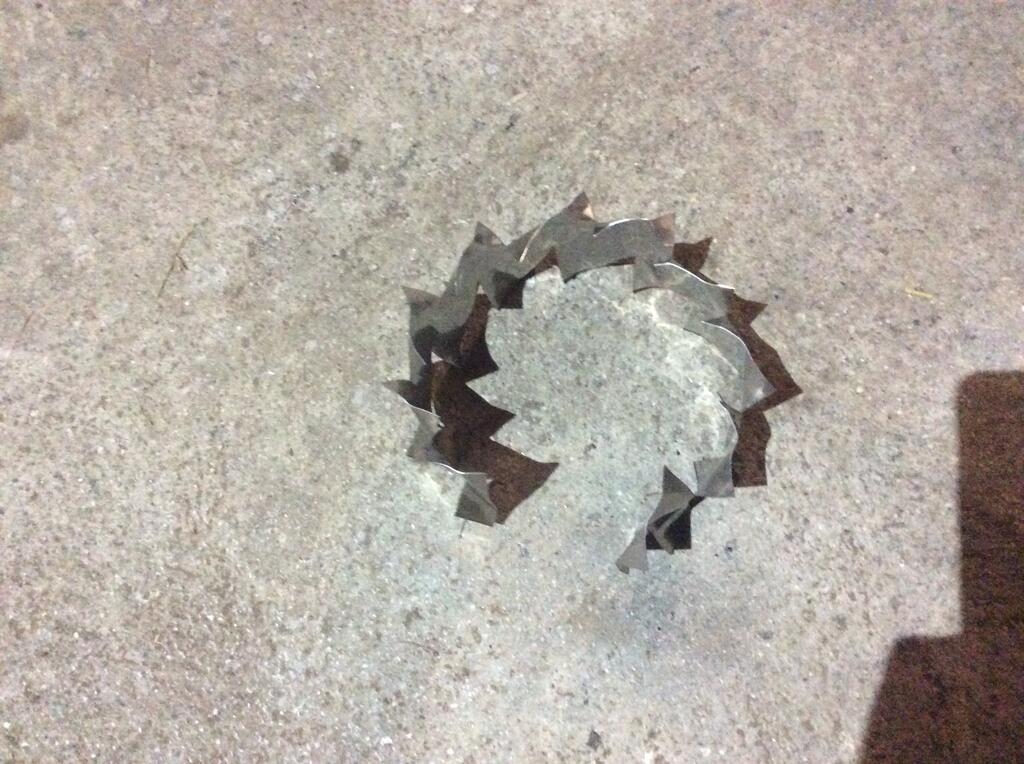

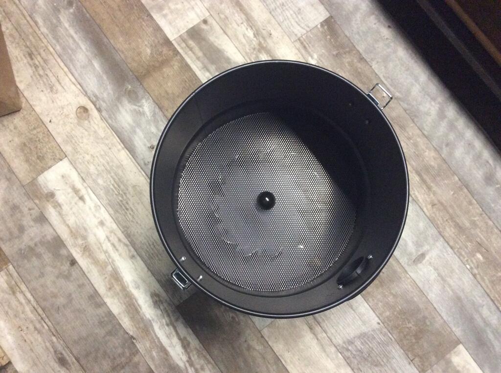

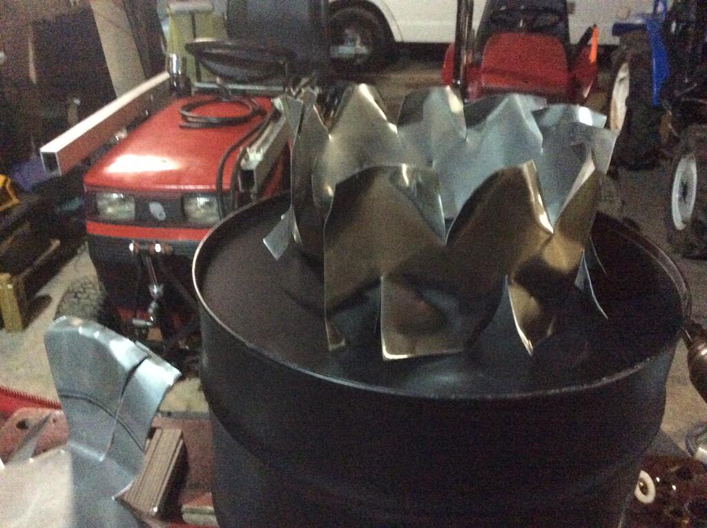

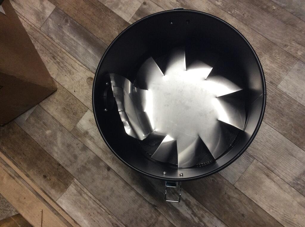

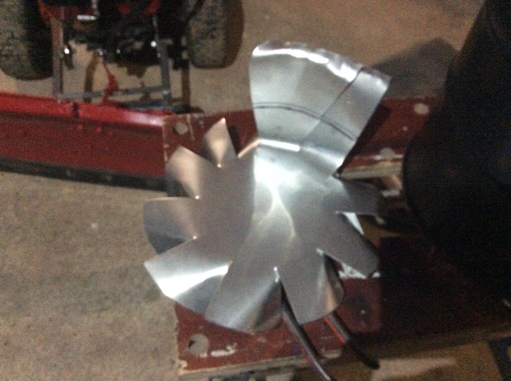

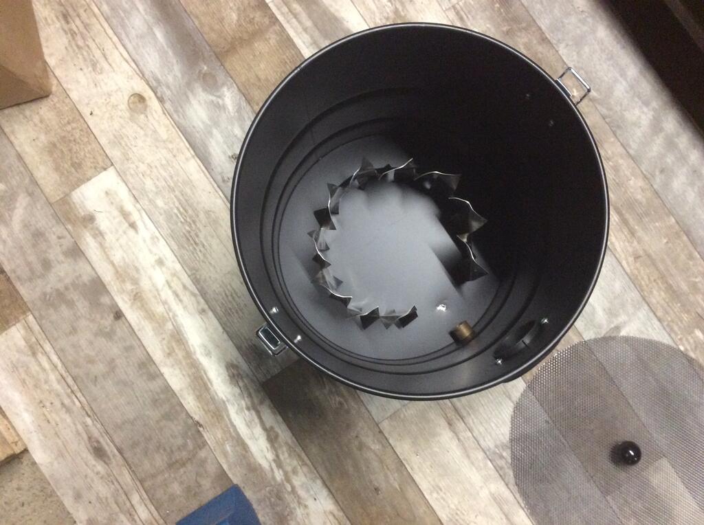

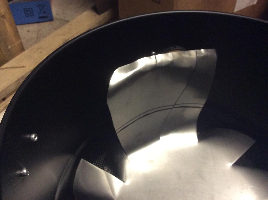

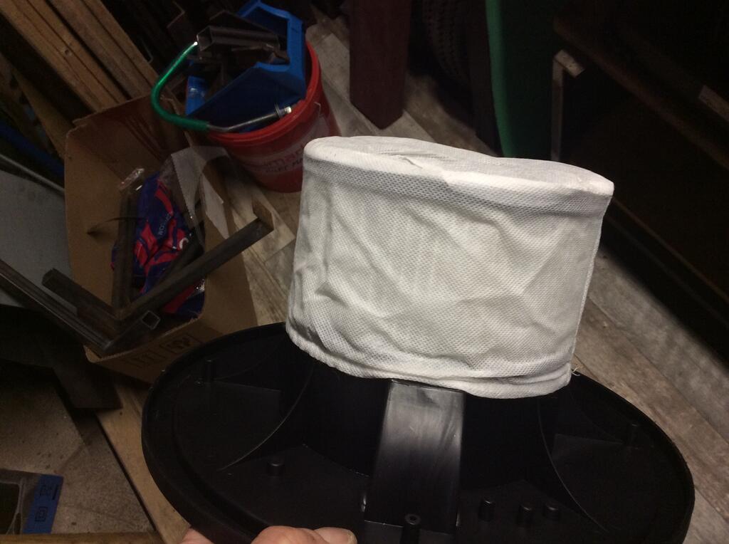

Tractorhead 8,610 #15 Posted December 2, 2020 Started today with a first test. after searching arround, i found few items and try to use them. I completely forgotten, i had allready things they needed in basement. I don‘t care about the Vacuum, it was a extremely cheapo one, if this fail‘s, i can not be sure, that the reason was the Sandblasting. This is cheapcrap, but for a test good enough, to see if my idea can work. - let‘s start to build this thing. Firstly i build the 3 inlay parts for the Bowl as i imagine for a try. First i built a whirlchamber, i hope this will keep the sand dry because of the vacuumed whirled air. my intend is also to have a feeder for the Sand by the Whirl. than i built the prewhirl chamber, that should spread the whirl in different zones. The reason i did this is to mix the recoverd sand with the air also as an feeder system. So i hope to prevent clogging - we will see. So let‘s see how the things shall look inside the bowl. Firstly i inserted the whirlchamber into the Bowl. ( the mesh i fabbed lay‘s aside) Than i put the Mesh on it. at least the intake chamber closes the System. The Vacuum intake will be immediately directed via that sheetmetaldeflector.( i hope) on top a Dual Filtersystem shall clean the out blown Air on a Maximum. as allready saying, this is an extremely cheap Vacuum, we will see how long it will last. Than i filled the Bowl with 7 Kilo Grit i had allready in Basement. Than i grabed a piece Metal i had laying arround aaaand . 57A99DAB-5578-4675-A79C-ADBDA75ABAED.MOV I have tomorrow to find out why it clogged, but the basics seems working. maybe it was my weak setup on the compressor, because i just have 6Bar on the Line. That will be increased - maybe tomorrow. 1 Share this post Link to post Share on other sites
Tractorhead 8,610 #16 Posted December 2, 2020 Huh, i found my mistake, once you can read, your‘re sometimes ahead... the grain i have used is up to 0,7mm the max. grain the Gun with this nozzle will trouble free handle is 0,4mm. Read it on the sidenotes - above 0,4 mm it can happen that it clogs very fast.. 😎 Share this post Link to post Share on other sites
DennisThornton 4,769 #17 Posted December 2, 2020 1 hour ago, DET said: Dennis, it is rated 2600 psi max, 2.5 gpm max Common size but a bit below recommended spec but you are still happy. Great and thanks! Share this post Link to post Share on other sites
