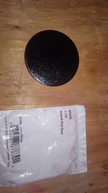

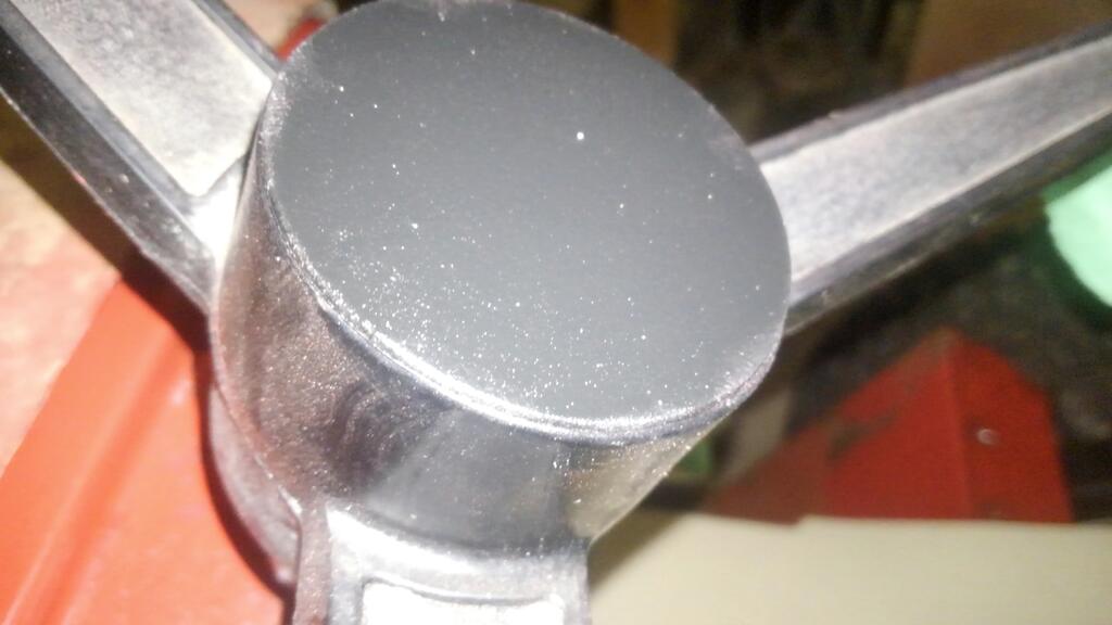

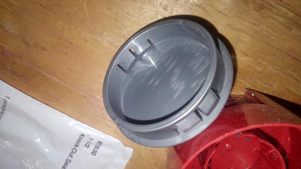

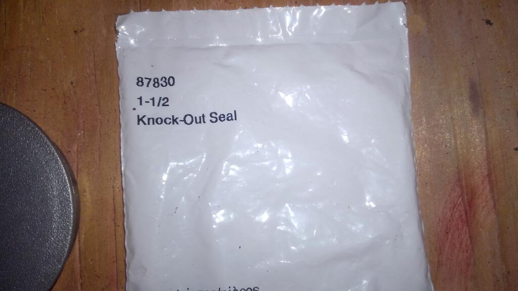

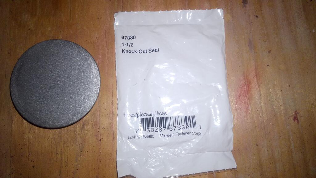

Rusty Tinsnips 477 #1 Posted December 1, 2020 I found this at the hardware store that starts with men**** $2.39 Fits perfect but has a rough finish so a decal wont stick. Maybe it could be sanded. The size says 1 1/2" but fits perfect in my 2" steering wheel. The 2" size cap actually measured 2 1/2". I took a tape measure back to the store for this one. 6 9 Share this post Link to post Share on other sites
WHX?? 57,470 #2 Posted December 1, 2020 If it keeps the water out from brown welding the wheel to the shaft we're all happy! 3 Share this post Link to post Share on other sites

953 nut 67,508 #4 Posted December 1, 2020 9 hours ago, Rusty Tinsnips said: has a rough finish so a decal wont stick. Maybe it could be sanded Sanding with progressively finer paper down to 600 and then a bit of rubbing compound and it would be as smooth as a baby's cheek! 2 Share this post Link to post Share on other sites

Rusty Tinsnips 477 #6 Posted December 1, 2020 18 minutes ago, peter lena said: rusty , thank you for the , info # , just so happens I need one , pete Your welcome I wasn't looking for this when at the store, I was looking for a bushing and came across this. My cap was missing when I got the tractor so I was pretty happy with the perfect fit. Share this post Link to post Share on other sites
