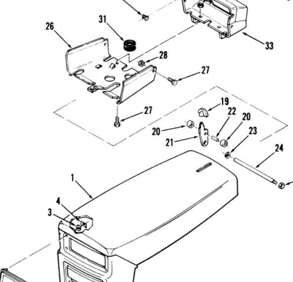

Wheelynice 5 #8 Posted December 4, 2020 I am in the same boat.. finally got my B-112 running and seems there is a leak at this valve. Seems part #8023 S/A (#12 in the picture) is what I need, but I am not about to spend the approx. $50 for a replacement after checking online via Toro, and via some of the other online links.. Thanks for the links Garry.. I'll try one of those. Looks like a trip to Tractor Supply I guess. On other matters, I also need a few other items: - the gas tank return spring; seems expensive to pay +/-$10 for a spring (that is part #10) in the attached first picture. I guess I'll check my local Lowe's or Home Depot. Anybody have a better source or know the size for that spring? Also where does the fuel tank hold down anchor to (see item #26, third picture). I can't find any pictures showing how this tank was anchored. There seems to be a 'tang' (not sure what to call it) adjacent to where nut #28 would fasten (third picture) but there is no symmetrical tang on the opposite side of the assembly, so not sure how the strap works.. If anybody can show me how this was supposed to be anchored, I'd appreciate it.. - battery hold down; I assume there is supposed to be a hold down or strap. Does anybody have any idea what was used on these B-112s? Mine is a 02-TTBX01-2197 9324 (which I have come to learn is a 1979 model).. - Also still need the mower deck pulley as well (they are quite expensive).. if anybody has one they are willing to sell, i'd be interested. Other than the spring, which I probably can source fairly easily from any local hardware store, not sure about the other items.. Appreciate any help on the above issues.. Thanks all for the help.. Share this post Link to post Share on other sites

Wheelynice 5 #18 Posted December 6, 2020 Thanks everyone.. I think I'll try and see if there's a seal in the valve I can replace.. I have a harbor freight assortment of o-rings. I've never taken the shut-off apart.. Maybe it's feasible to repair it. Failing that.. seems there are plenty of other options. Anyone have any idea how the tank strap was supposed to anchor? Can't quite tell from the parts diagram..and to be frank, I don't have that one picture (of course..there's always something missed). Anyway, thanks much for those diagrams. They are very helpful. I can see that the battery originally just had some simple j-bolts for holdowns.. 1 Share this post Link to post Share on other sites

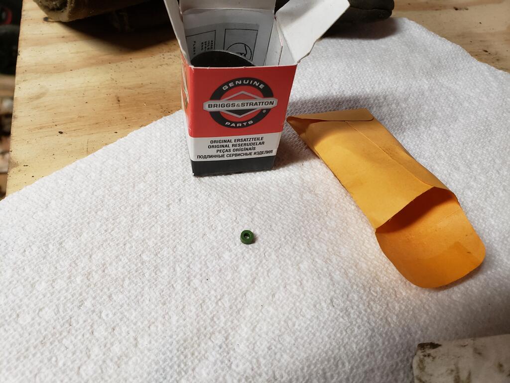

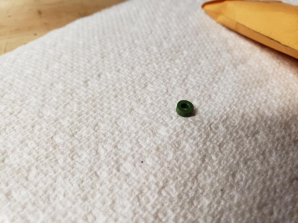

Wheelynice 5 #20 Posted December 26, 2020 On 12/6/2020 at 1:27 PM, dantheman said: Thank everyone for the input.. anyone have any idea about the tank strap? I have a few other bugs I still haven't haven't resolved.. Any idea why my engine races just off idle.. Just seems to run too fast (I don't think the governor is stuck) I've rebuilt the carb. and have the primary idle and main mixture screws set per typ. recommendations (I think I've got the idle at 1 1/2 turns out and the main about the same). I don't think I have any gasket leaks, but wonder if I shouldn't check the valves? Also, attached is a picture of a seal that came in the carb rebuild kit from Briggs. Though that perhaps it was meant for the idle jet, but the carb didn't seem to have any o-ring or seal for that jet.. I tried putting the seal in, but the float was way too high. Any idea where this seal is meant to go? Perhaps another version of the choke-a-matic carb? Do I need this seal for something? Share this post Link to post Share on other sites
adsm08 5,231 #21 Posted December 27, 2020 Is this is? https://isavetractors.com/fuel-tank-fitting-for-non-threaded-plastic-fuel-tanks/ Share this post Link to post Share on other sites
Howie 900 #22 Posted December 27, 2020 That is the seat for a briggs carb, have to pull the old one out and replace with that. Side with the groove in it goes in first. 1 Share this post Link to post Share on other sites
Wheelynice 5 #23 Posted December 28, 2020 Thanks Howie - Are you referring to a seal for the jet that attaches to the float? I thought this was it, but I wasn't able to pull any seat out. I tried a narrow diameter punch (to try and wedge and pull something up), but I didn't want to risk damaging the bore and there didn't seem to be any maleable type seal in there.. Is there a specialized tool for this? Is it possible that the factory seat in there is brass? Share this post Link to post Share on other sites
Wheelynice 5 #24 Posted December 28, 2020 adsmo8 - That looks like it. Does anyone know if the original has a seal in it that can be replaced? Share this post Link to post Share on other sites
Howie 900 #25 Posted December 29, 2020 You should be able to it it down in there if it uses one. I use a small knitting needle with the hook to pull them out. Does the needle on your float have a viton tip on it? If it does there will not be one of those in there. It will have a brass one pressed in there. They can be replaced but have to be pulled out and pressed back in. Share this post Link to post Share on other sites
