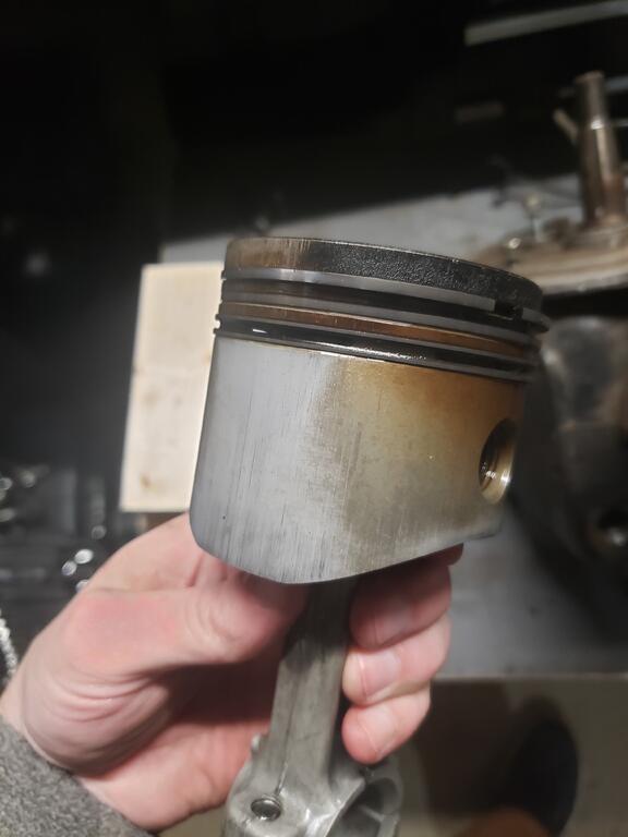

71_Bronco 1,073 #1 Posted November 28, 2020 Got time to work on my Commando 8 today (doesn't happen often). I'm tearing apart and cleaning the replacement engine (K181 off a leaf blower with recoil start). Got pretty much all the old stuff off (tins, flywheel, carb, head). When looking at the piston, I saw the top was pretty black, as well as the valves. Cleaned it all up nicely, but noticed the piston wiggled a little when I was cleaning it. There is a noticeable ammount of wiggle perpendicular to the crank center-line. It sounds like its still sealing okay though, as on the down-stroke, you can hear the hiss of the crank air escaping the breather as it should. I can't hear anything coming up through the piston. The block was covered in an oily mess, so I would think it is burning oil, or something isn't right. The block did have oil, jet black, but no water thankfully. If I leave it as-is, will this still run okay? Will it burn oil? Not have full power? The engine is only going to be used to power it for mowing (if i decide to use it instead of the Kubota) and plowing my 100 foot flat paved driveway. Also, I need help removing the bearing plate (last thing to remove). I'm converting this to a starter-generator, which I'm pulling the old parts off the blown motor in the Commando 8. Once I have the bearing plate off, I can start pulling parts off the old blown motor and building up this one for the swap. I know the correct thing to do is send it to a shop and have it bored with a new piston, as well as possibly having the crank ground and new rod. Howver, I dont have the money to invest in this right now. I do have another K181 on the shelf I could use, that one is set up with a standard starter (not a starter-generator). I havent pulled the head off that one yet to check it out. Share this post Link to post Share on other sites

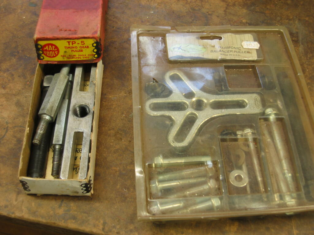

pfrederi 21,301 #6 Posted November 28, 2020 You need a puller to get the end plate off. See page 10.5 I use an old timing gear puller or something like the set which you can get on loan from some auto parts stores. You may need some long bolts as the crankshaft stick put along way on some engines... 1 Share this post Link to post Share on other sites

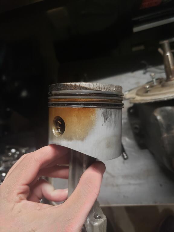

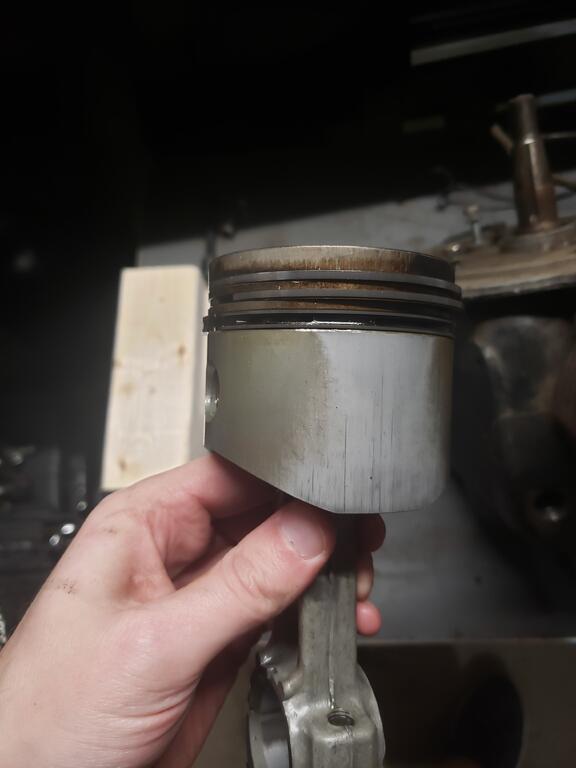

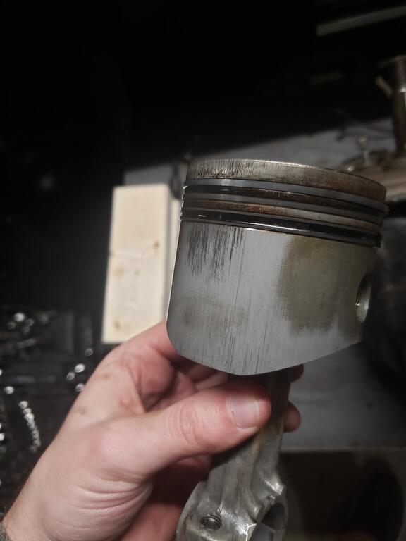

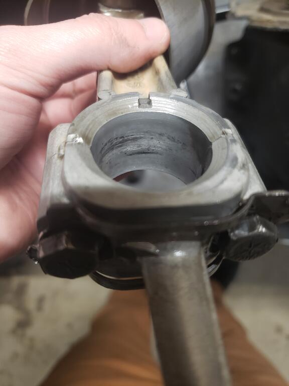

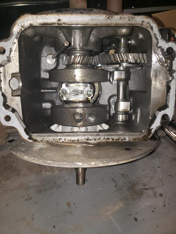

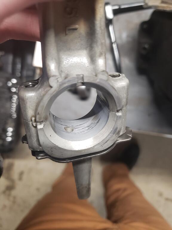

71_Bronco 1,073 #10 Posted November 29, 2020 Okay, got the piston out of the replacement K181 (the one with the piston wiggle). I will measure the ring gap as the link said, but ran out of time. I did take a few pics of the cylinder and rod. One thing that makes me a little nervous is the little bit of what looks like galling inside the rod (where it wraps around the crank). Hope this isn't an issue. Share this post Link to post Share on other sites
richmondred01 2,393 #11 Posted November 30, 2020 I think you answered your our question. Bored, crank ground, and valve job. no sense in putting it back together knowing it won’t last. Share this post Link to post Share on other sites
