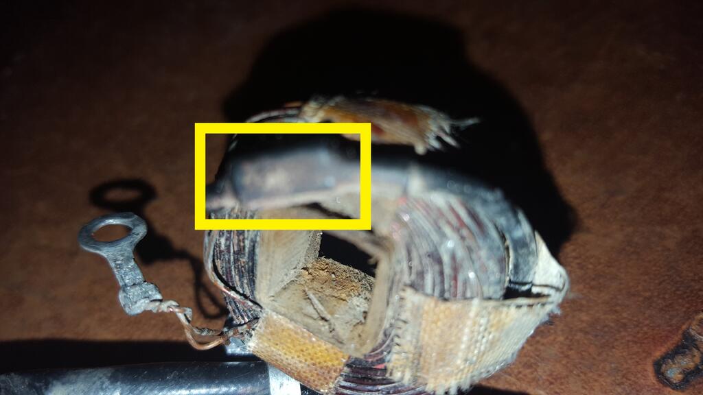

Gregor 4,848 #203 Posted January 13, 2021 @Tractorhead Did you say these are small diodes in the line? Share this post Link to post Share on other sites
Tractorhead 9,217 #204 Posted January 13, 2021 No, normally they aside the Engine on the Diode plate ( rectifierplate), but it can happen, the they built also diodes in line on the Coil instead of the rectifier plate. Yes it appears to be. open up the shrinktube to see it better. mompls, i will look for a good pict. Share this post Link to post Share on other sites
Gregor 4,848 #205 Posted January 13, 2021 I have diodes in my rectifier card. Maybe those are simply splices. Share this post Link to post Share on other sites

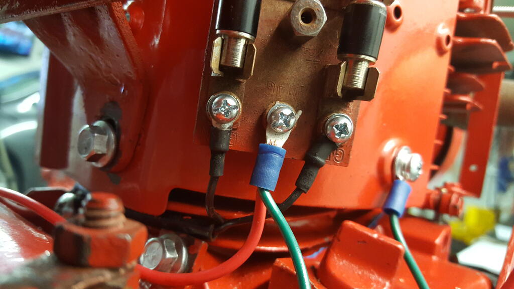

Tractorhead 9,217 #206 Posted January 13, 2021 Aaah, here it is... This thing left side under the Fuse is one of the diodes. the right diode was missing, that also was one of my reasons to decide for using a external Regulator. The terminal with the white Wire is normally the Charging Line after the Fuse. The Coils goes normally each hot wire to each of the both lower outside terminals, the lower middle Terminal is the Magneto Shutdown. . Share this post Link to post Share on other sites

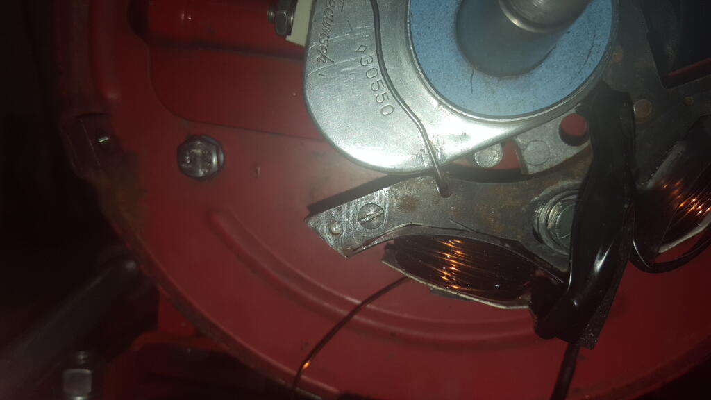

Gregor 4,848 #208 Posted January 13, 2021 My third attempt was a disaster. Tried something new, didn't work. The coils are much too big to fit in the space provided. Maybe I need smaller wire. 1 Share this post Link to post Share on other sites
Tractorhead 9,217 #209 Posted January 14, 2021 8 hours ago, Gregor said: My third attempt was a disaster. Tried something new, didn't work. The coils are much too big to fit in the space provided. Maybe I need smaller wire. Sorry for my Laugh Bud, but It’s the normal Way everybody have to go. Yap, thinner Wire makes definitely something easier, but you also have to take your time while winding. Don‘t bring yourself in a hurry. Winding yourself coils is a typical thing for ugly Winterday‘s when there is just Slush outside, the temps are in a Ugly range , you heat up the stove put you most liked beverage aside and start to turn. one Winding after the other, each complete layer is a reason to celebrate with your beverage. so i could be a productive day, or just a funny one, that depending on your choosen beverages 😎😂 i would give a try the second coil you made, this one looks good if it fit‘s to the stator Btw, the both Stator spaces for the Coils are little different. Share this post Link to post Share on other sites

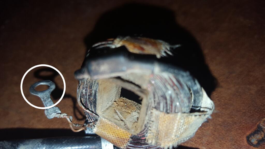

Gregor 4,848 #210 Posted January 18, 2021 (edited) I decided it was time to remove the old coils and dissect them. They were not working anyway, so what the he..., I couldn't hurt anything. One thing I don't under stand is, how can one continuous wire, wrapped in a circle, have 4 ends. That bugs me. Oh well. I will try to install my newly wrapped coils, having only 2 ends per coil, and see what happens. Worst case scenario, it won't work again. EDIT: My coils are too thick. Back to winding. Edited January 18, 2021 by Gregor 1 Share this post Link to post Share on other sites
Tractorhead 9,217 #211 Posted January 18, 2021 Just if a coil is cutted and they looks a 4 ends. it can also be, they use a double winding, but i doubt. Yap, give them a Try and see with AC Setting what is result on one coil. if you set two coils, put them in row. the right order is coil1 begin as lead, coil1 end to coil 2 begin and coil2 end as lead 2 or if you just use one coil, both ends are leads to measure the Voltage in AC between. Share this post Link to post Share on other sites

Gregor 4,848 #217 Posted January 19, 2021 The tool is made of wood, and covered with cardboard. I wound some new coils this morning, the hair dryer is currently drying the Gorilla glue. I have a new plan. I'll let you know the results 1 Share this post Link to post Share on other sites
Gregor 4,848 #218 Posted January 19, 2021 On my new coils I left the wires very long. I put shrink tubing on each, then put all 4 in shrink tubing after marking them. I ran all 4 wires to the regulator board. All splices and connections could be made there. I estimate ~70 wraps per coil. Ohms reading form coil to ground, 0 Resistance through the 2 coils, .3 to .6 It tends to jump around. Fired up the tractor. AC volts, 1.8 DC volts 0 We are back to Edison again. Only an idiot does the same thing over and over again, expecting different results. I really don't know what I could have done differently. Share this post Link to post Share on other sites
