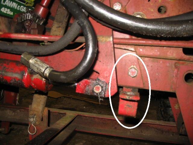

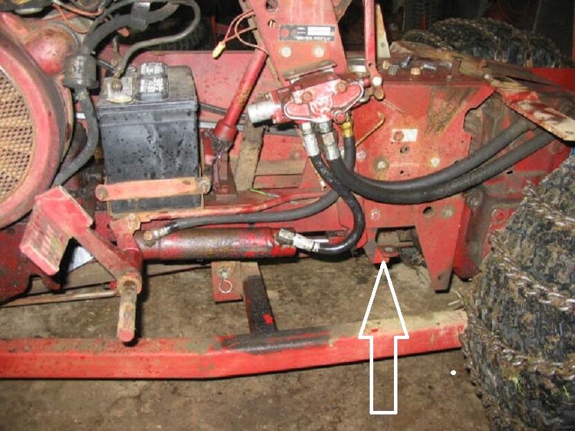

ebinmaine 77,322 #1 Posted November 27, 2020 Been getting the Charger back together and of course I had to move the left step out away from the frame to make room for the hydro lift cylinder. On a manual lift tractor there's 2 bolts near the bottom of the steering tower that hold the step. Can't use those because as many of know the cylinder is in the way. Is there a separate bracket I should have?? Seems to be a tad (floppy?) Without the 2 bolts... Share this post Link to post Share on other sites
daveoman1966 3,882 #2 Posted November 27, 2020 You need this bracket to support the left foot rest. It bolts the the inner side of the hoodstand, then under the footrail. It allows for the ram to fully extend unobstructed. I'll send one to your for $20. Paypal as "Send Money to Friend". Send to my Paypal account name: daveoman@windstream.net. 1 1 Share this post Link to post Share on other sites
