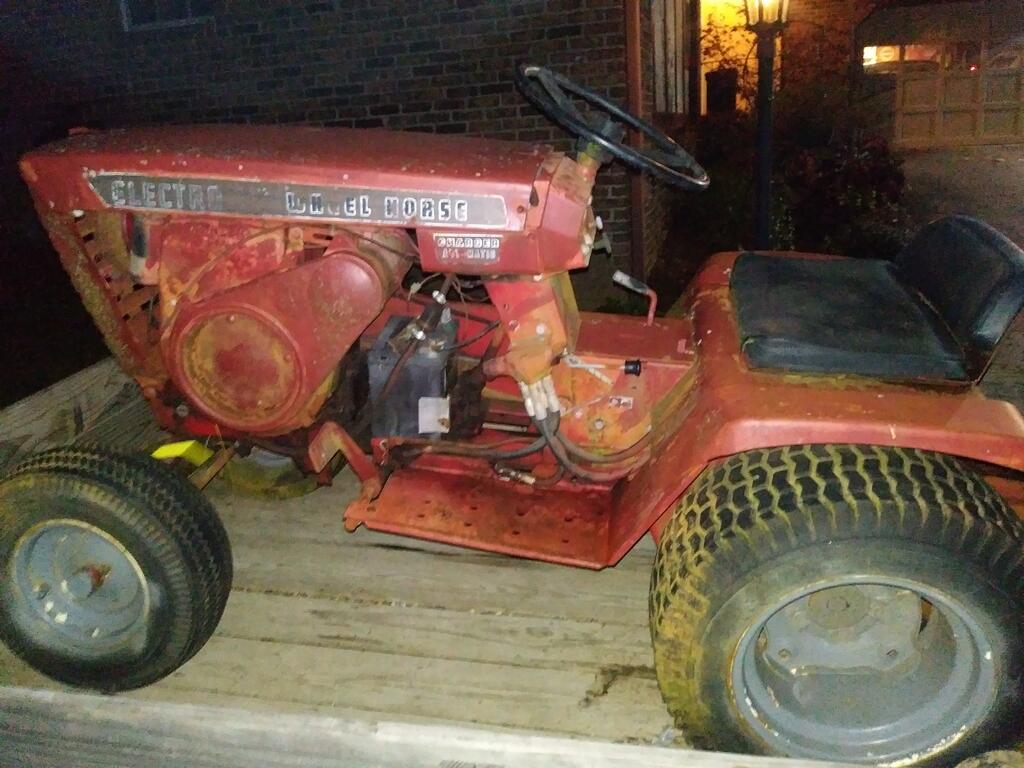

I need some help. I picked up a 1968 electro 12 (1-7235) that I'm assuming is an early model built with a leftover 67 engine because the engine patina matches the tractor and it has an external generator/starter instead of the magneto. It's a k301S-4712B. I bought it knowing that the engine turns freely and that it had no spark. Being 52 years old I figured it deserved some fresh ignition parts so I replaced the coil, condenser, points (cleaned and set to .020), spark plug (.035), and plug wire, and I still cannot get a spark at the plug or through my spark plug tester. It turns over okay and I've got 12 volts to the positive terminal on the coil. It's been many years since last worked on this type of ignition system and I'm stumped.  I would appreciate any input/suggestions you might have.  If it were something newer I'd suspect a safety switch but I can't see that this has any.

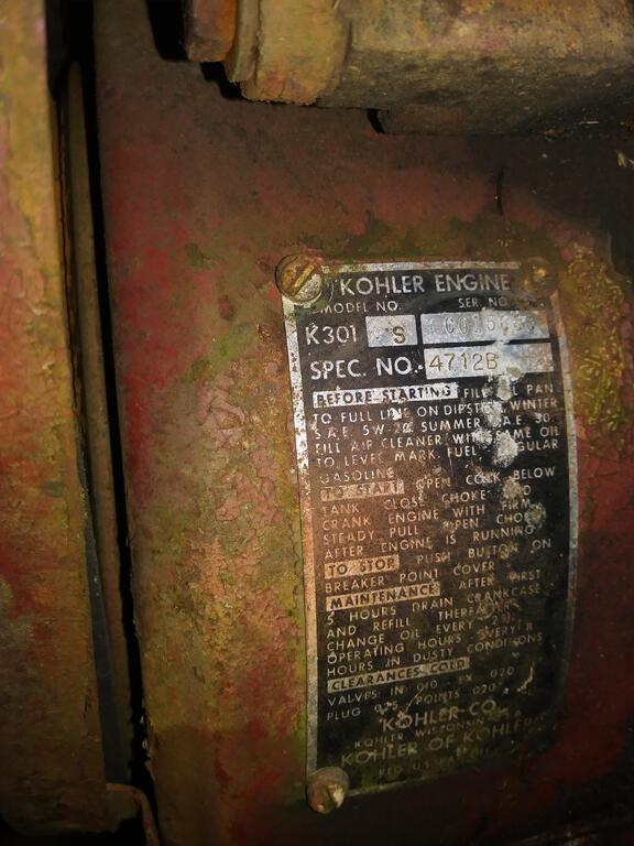

The first 1968 Chargers used the engine you have. Mid-model year they switched to the Bendix starter and charging stator but continued to use the same tractor model number. Bet they regretted that.
An Electro is a Charger plus options.

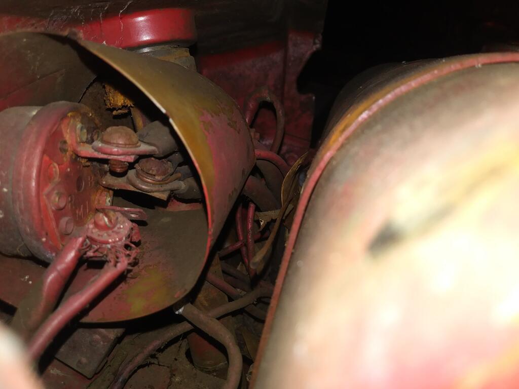

I was able to snap a picture without removing the fuel tank. It looks like the wrong switch  to me. I see the letters S, B, L, M and R with a tab between the M and R. This pretty much matches a diagram I found for a later model ignition system with the exception of M and R being connected together, and there are only 4 screw terminals.   The wiring definitely needs some work also.

A switch marked with an M will not work for you.

This looks like the switch you have and would be correct for late 1968 models with magneto ignition.
Look up under the dash panel for the ID plate and post the serial number of the tractor. It may not be the original engine to the tractor.
I see some BAD WIRES!

Looks like the "M" terminal isn't being used in the photo. Take a small jumper wire from the battery "+" to the coil "+" and crank it over. If it is the ignition switch that is your problem it will have spark with the jumper in place.

Problem solved. Thanks to all of you for your suggestions and a special shout out to Ohio Farmer for the suggestion to use a jumper from the battery to the coil.  It started so fast it surprised me. Last ran a couple of years ago and started without even a puff of smoke.
